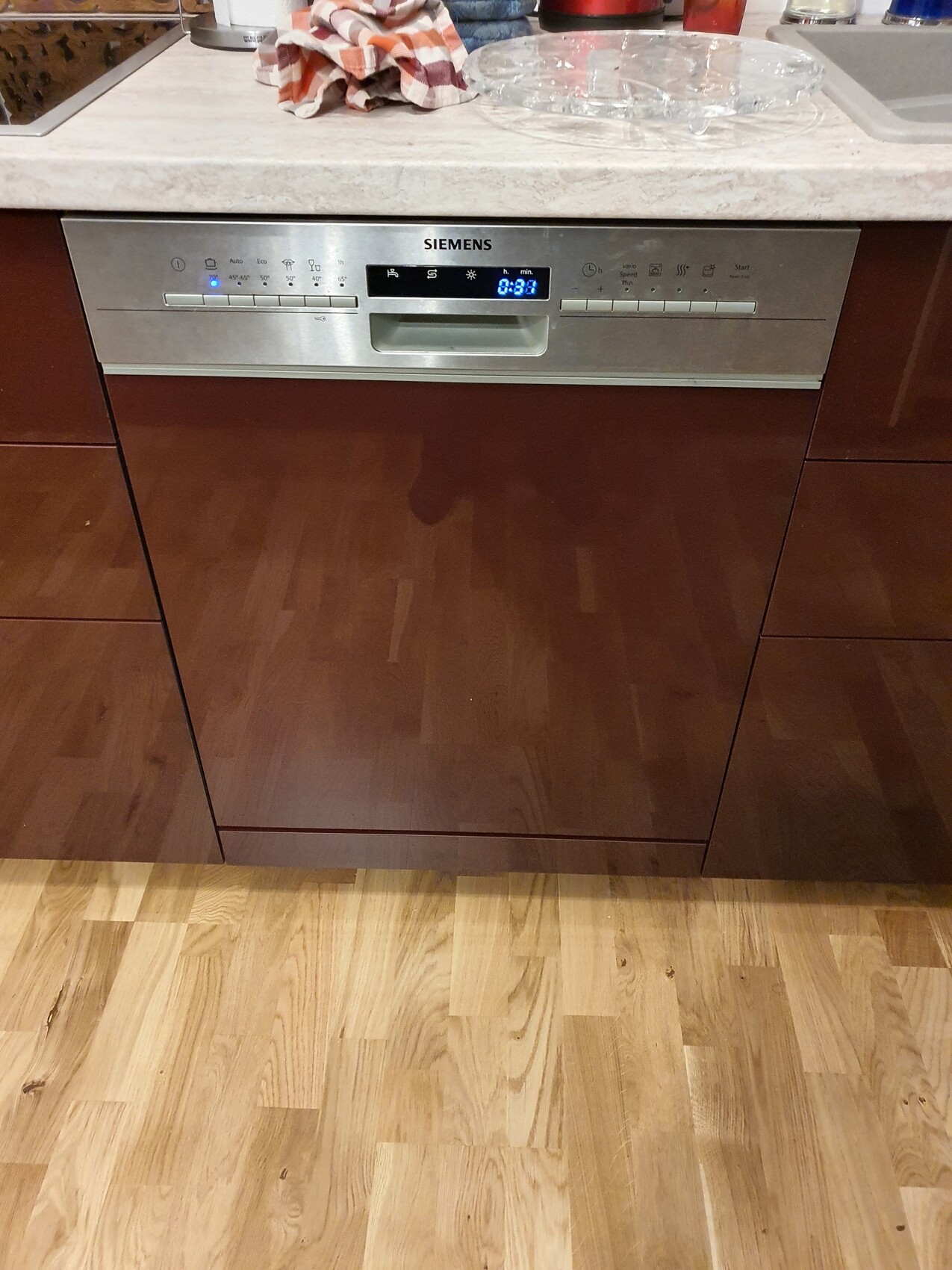

-> The kitchen cabinet front still needs to be installed. I have to cut it myself and attach hinges due to the well-known Ikea kitchen / Siemens cabinet issue.
This can also be done without hinges. Cut the front panel long enough so that the cabinet door just opens. Then cut a strip from the remaining piece and mount it flush at the bottom of the side cabinets. This creates a gap of about 1cm (0.4 inches), which is barely noticeable.
