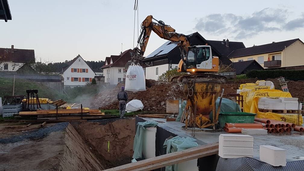

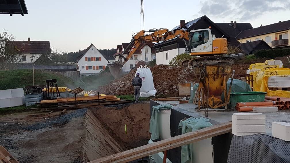

Or the other way around, on the plaster. Like this.This is what an employee from our construction company suggested to us this morning as well. He also mentioned something about a drainage membrane.
We are having the prefabricated garage built on our own order. It will already be plastered.

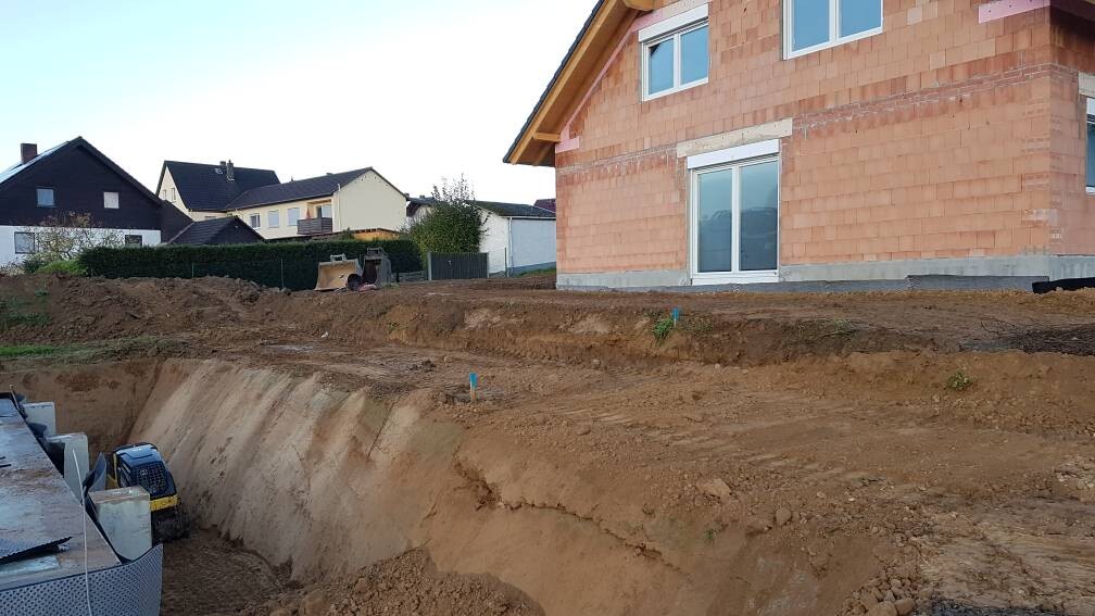

Here’s another picture showing the height difference. We still need to subtract half a meter (1.6 feet) for the driveway. Although on top of that, there will be gravel, foundation, paving, etc.
Well, we still need to figure out what we should pay attention to here.
Oh, and on the other side, we also have to see how we handle it. We didn’t want too big of a difference compared to our other neighbors and are already considering it together [emoji22]

winnetou7827 Oct 2017 13:57But the height difference with the neighbor is already quite significant. A lot of unnecessary things are regulated in the building plan/planning permission, yet something like this is allowed.
