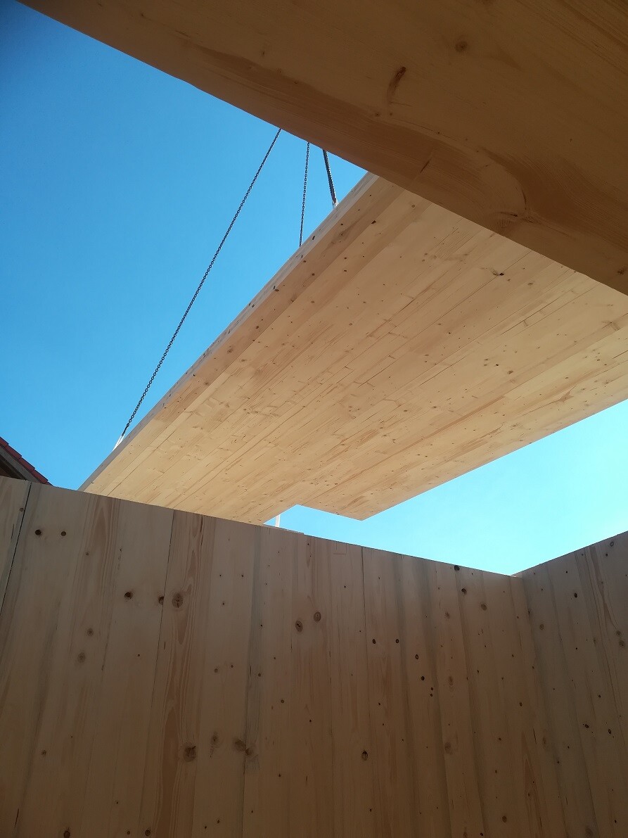

Here comes a ceiling panel flying in:
Only the last bit is missing to complete the ceiling:

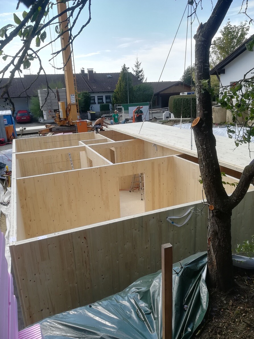

Then I went down to get a first sense of the space:
This will be the workshop!

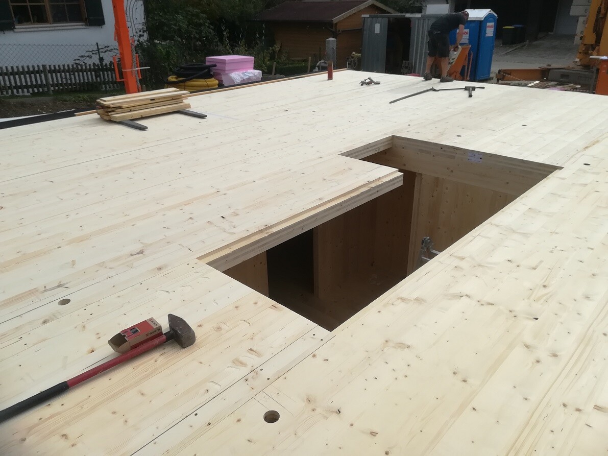

Now it’s finished:
Only the hole for the staircase entrance remains!

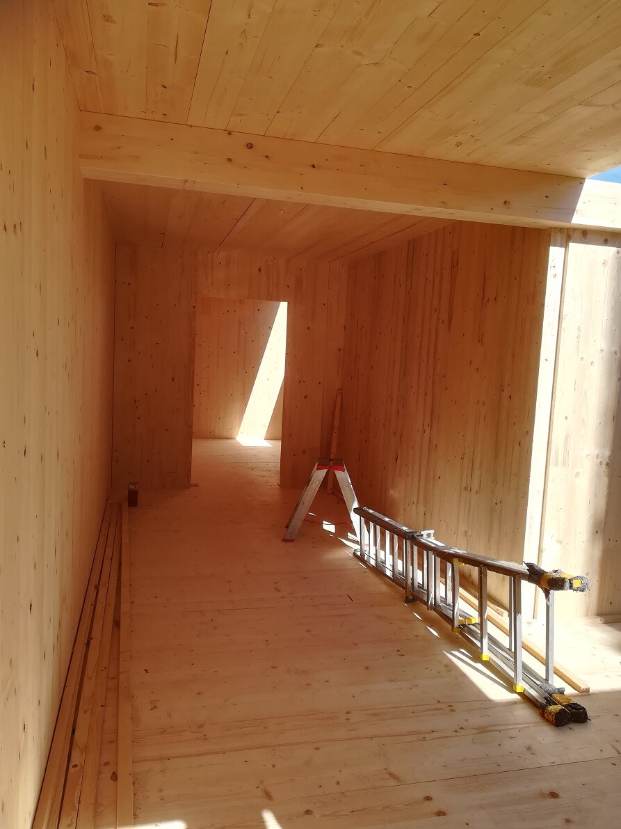

This is how it looks downstairs now:
This will be the guest room; the window is already pre-cut, as you can see.
And our worry that the rooms might be too small was completely unfounded. They are very well proportioned and more than sufficient!

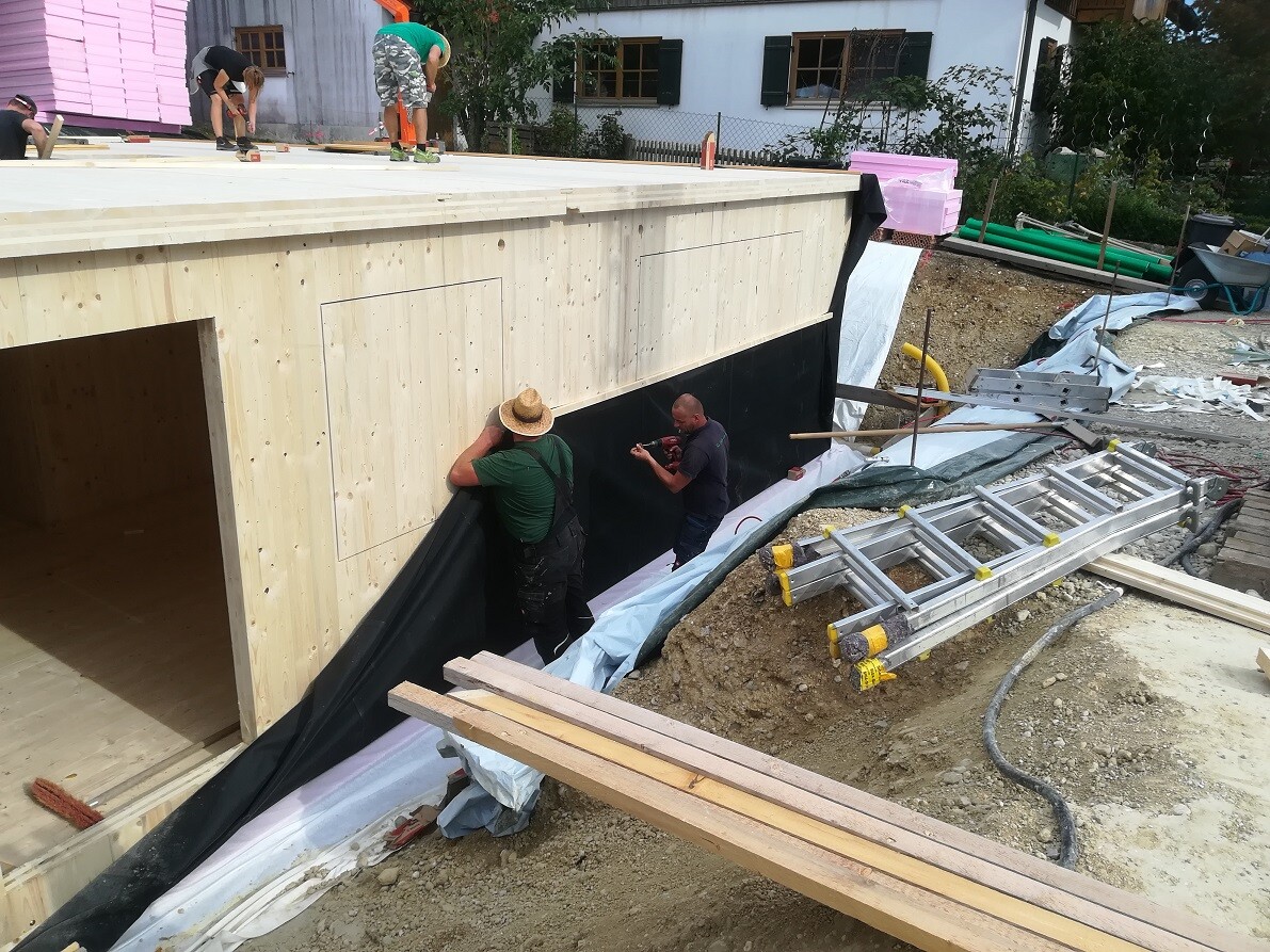

Everything went wonderfully; the parts were delivered perfectly, and not a single tiny detail needed correction (which is not always the case). The atmosphere was great, and everyone enjoyed themselves because everything ran smoothly.

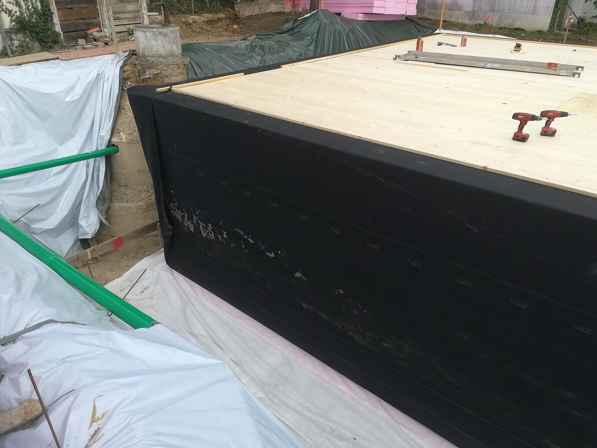

As a result, we even finished relatively quickly, and around five o’clock the basement was carefully “packed up” to protect it from the forecasted rain over the weekend.
To do this, the EPDM membrane was laid on top:
At the end, the parts that also needed to stay dry were placed on top, and a large tarp was spread over everything. In the end, it looked like a yurt, but I forgot to take pictures. You can’t see much anyway—just a large, square structure with a raised center where a white tarp was tied down.
