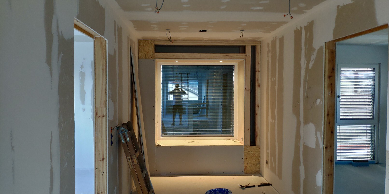

Our seating window now has its lighting installed, so the drywall contractor can close it up and start plastering
We are currently in the very final stages of our house planning (prefabricated house).
We have a layout on the upper floor similar to yours. Right now, it still has a “standard” window. We like your fixed glazing with a built-in seat so much that I want to quickly ask our project planner if that could be implemented in our build as well. It really looks fantastic!
Do you happen to know if your setup (fixed glazing, seating area) is significantly more expensive than a normal window (tilt-and-turn, with a fixed lower section)?
And in general, does anyone know if this might cause issues with the building permit / planning permission? Essentially, everything stays the same except for a different window being installed...
