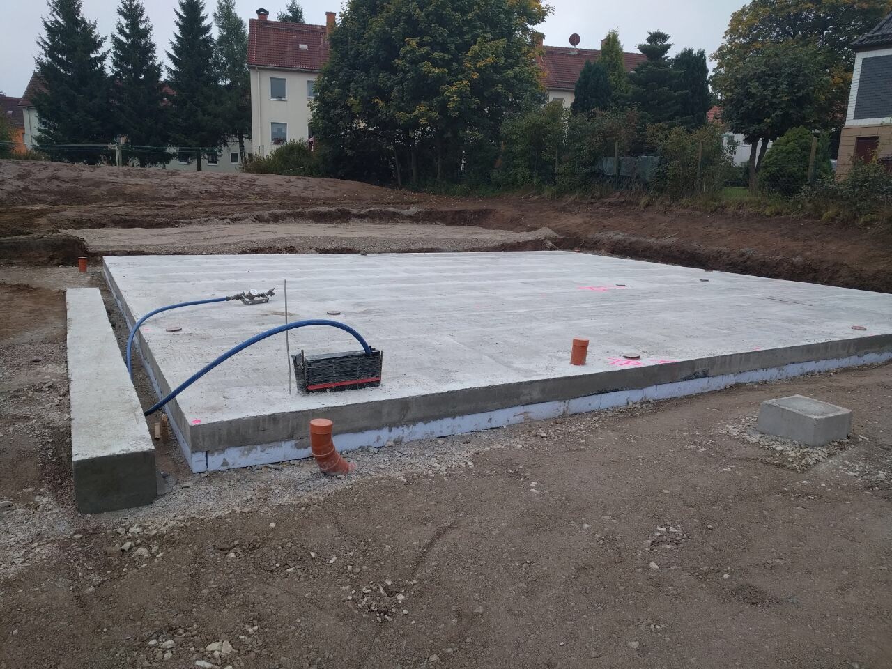

Is it possible that nothing of the house or its design was visible here before?There are a few pictures here already, but no floor plan – I can still add one.Nordlys schrieb:

Although, it really does look quite slim for an exterior wall (from what I saw a few posts earlier).
What is the wall construction like when everything is finished?
PS: With all those skulls, you could definitely create a nice corner in the garden. Ideally placed so the neighbor can see it well!
Wall structure
from inside to outside
Paint, painter’s fleece, drywall. 15 cm (6 inches) solid wood, 30 cm (12 inches) insulation, followed by base coat and finish plaster.
The 15 cm (6 inches) solid wood layer looks quite slim. Especially compared to the ceiling with 24 cm (9.5 inches) solid wood.
