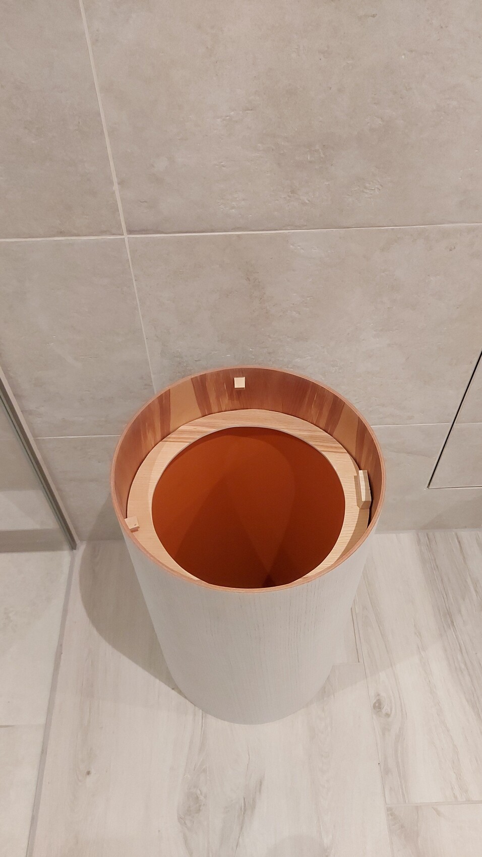

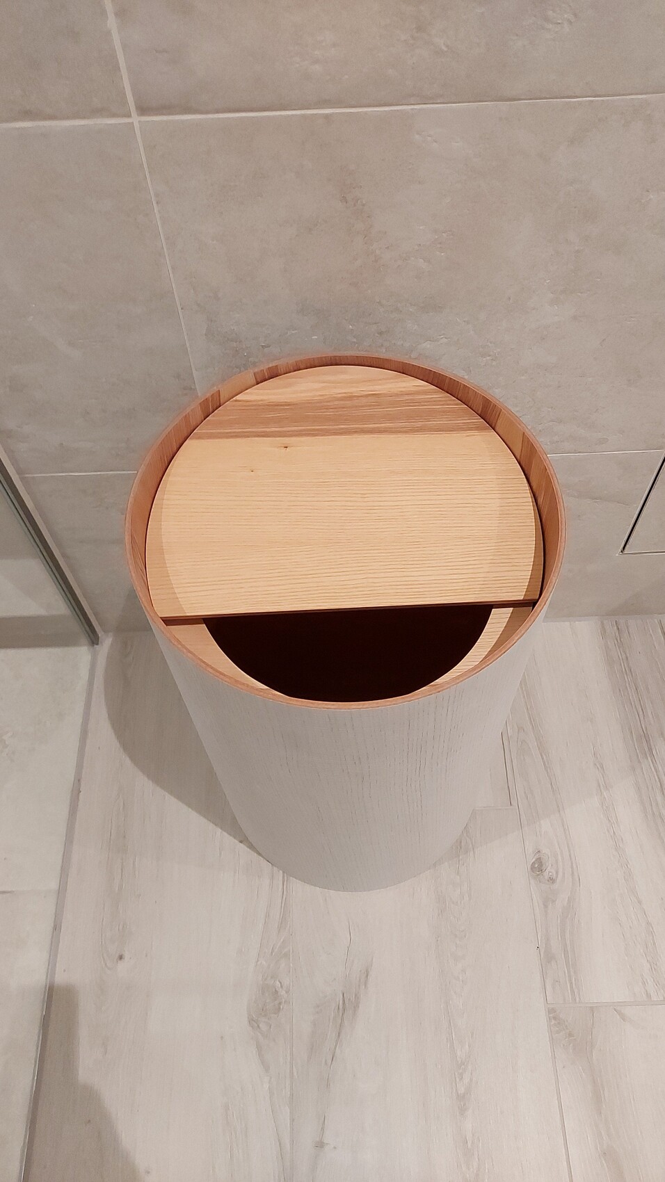

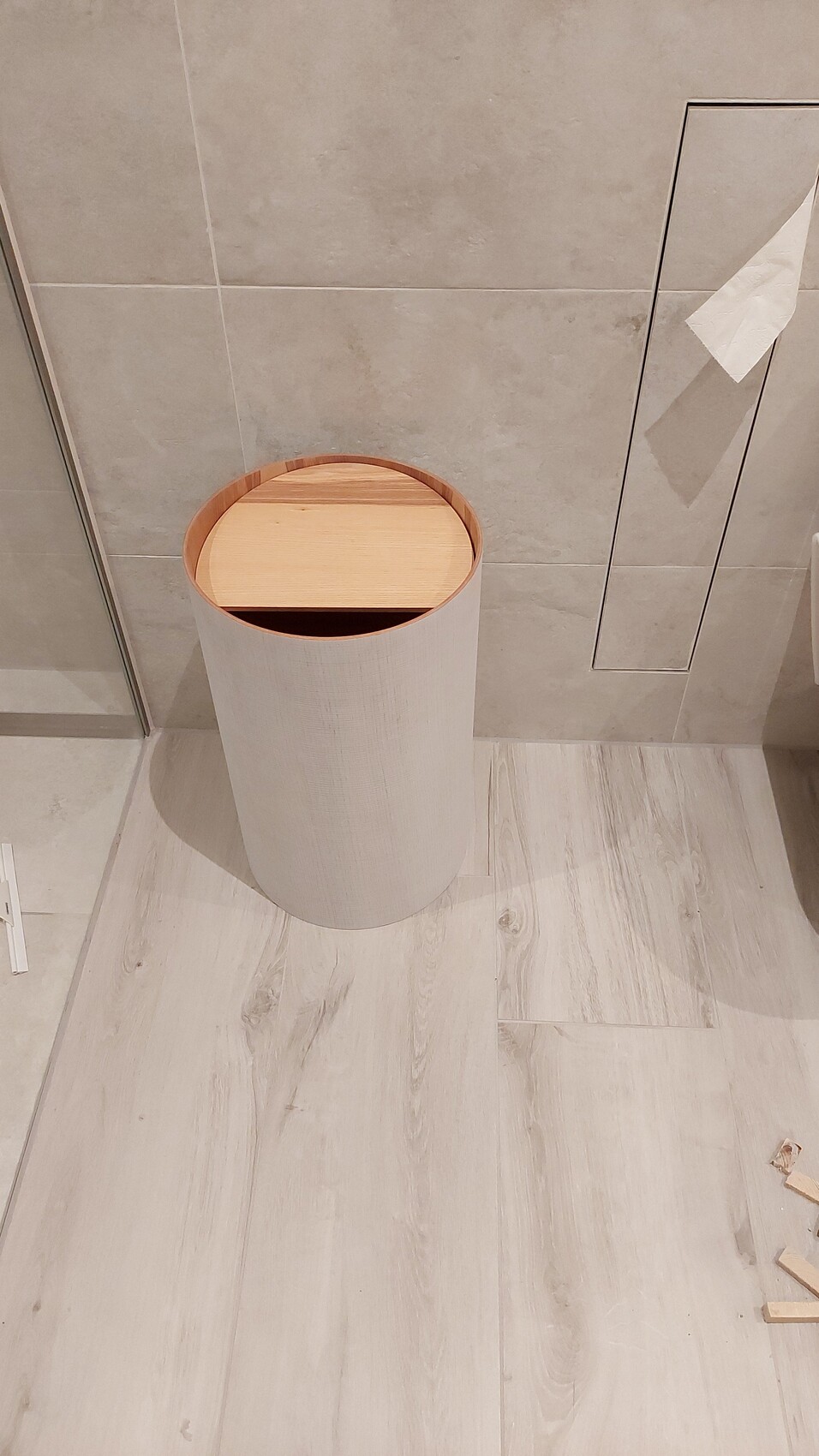

This is the laundry chute.[ATTACH width="183px" alt="IMG-20210205-WA0047.jpeg"]58798[/ATTACH]Really? Interesting. What does the inside look like and what is the diameter? You often hear concerns that one of the 17 kids might fall in there... although... they might just come out the bottom then.pagoni2020 schrieb:
Often you read concerns that one of the 17 children might fall in there... although... they might just come out again at the bottom... or one of the 25 pets, like cats. They might be able to go through it about seven times each, maybe more.It is actually a laundry bin.
I only made some modifications. I cut out the bottom. The bin was glued to the PVC sewer pipe using spacers.
From the section of the removed bottom, I cut out a ring which I glued to the top and sealed with silicone.
The silicone seams are not yet visible in the pictures.
I believe the PVC sewer pipe has an outer diameter of 315mm (12.4 inches) and the bin has an inner diameter of 330mm (13 inches).

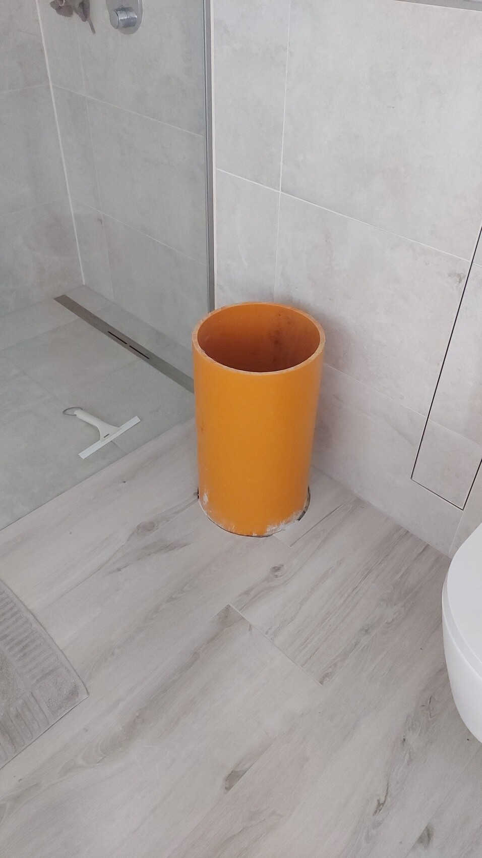

This is how it looked before 🙂
