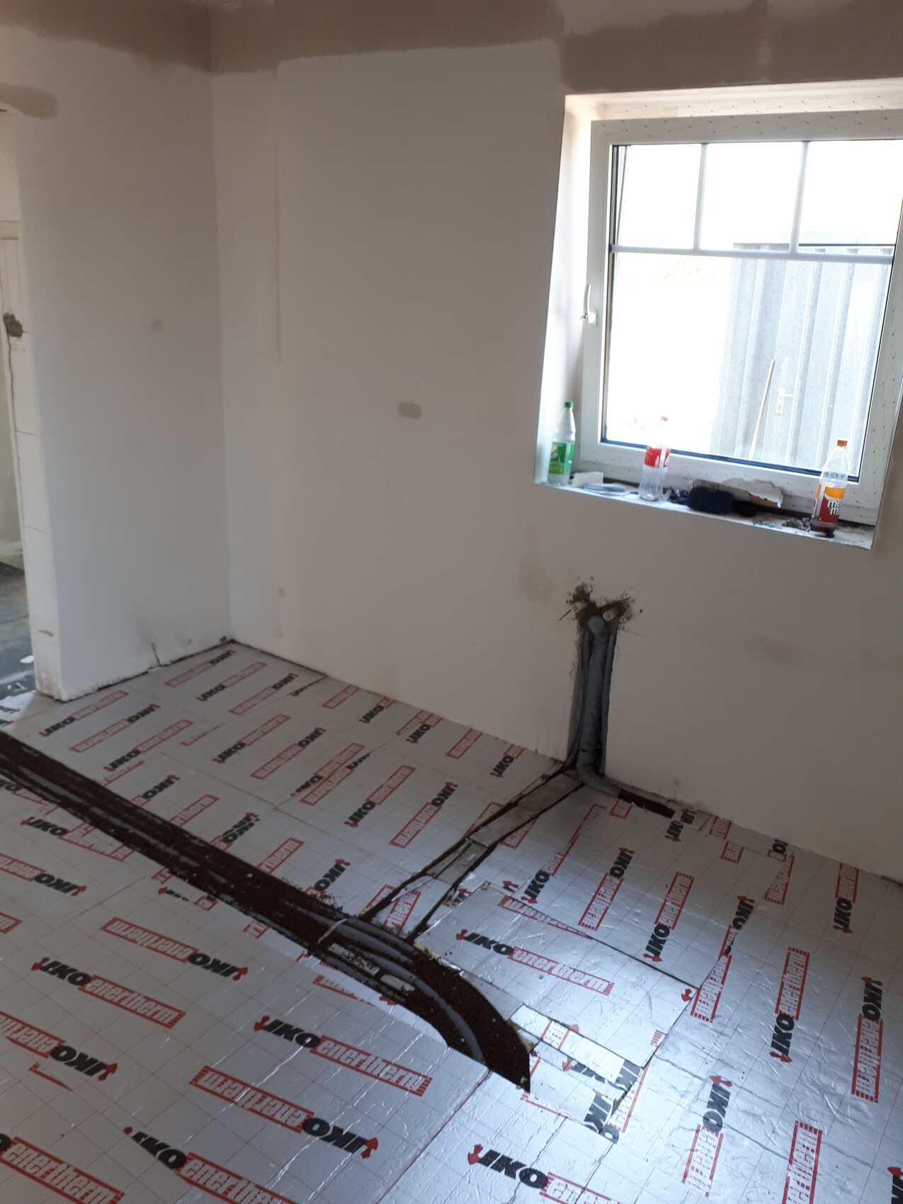

We worked hard on the Easter weekend, struggling with all the pipes. I looked like a snowman because we needed a 1 cm (0.4 inch) slope near the doors, so we had to thin the screed by 1 cm (0.4 inch). In the end, we installed three layers of floor insulation.

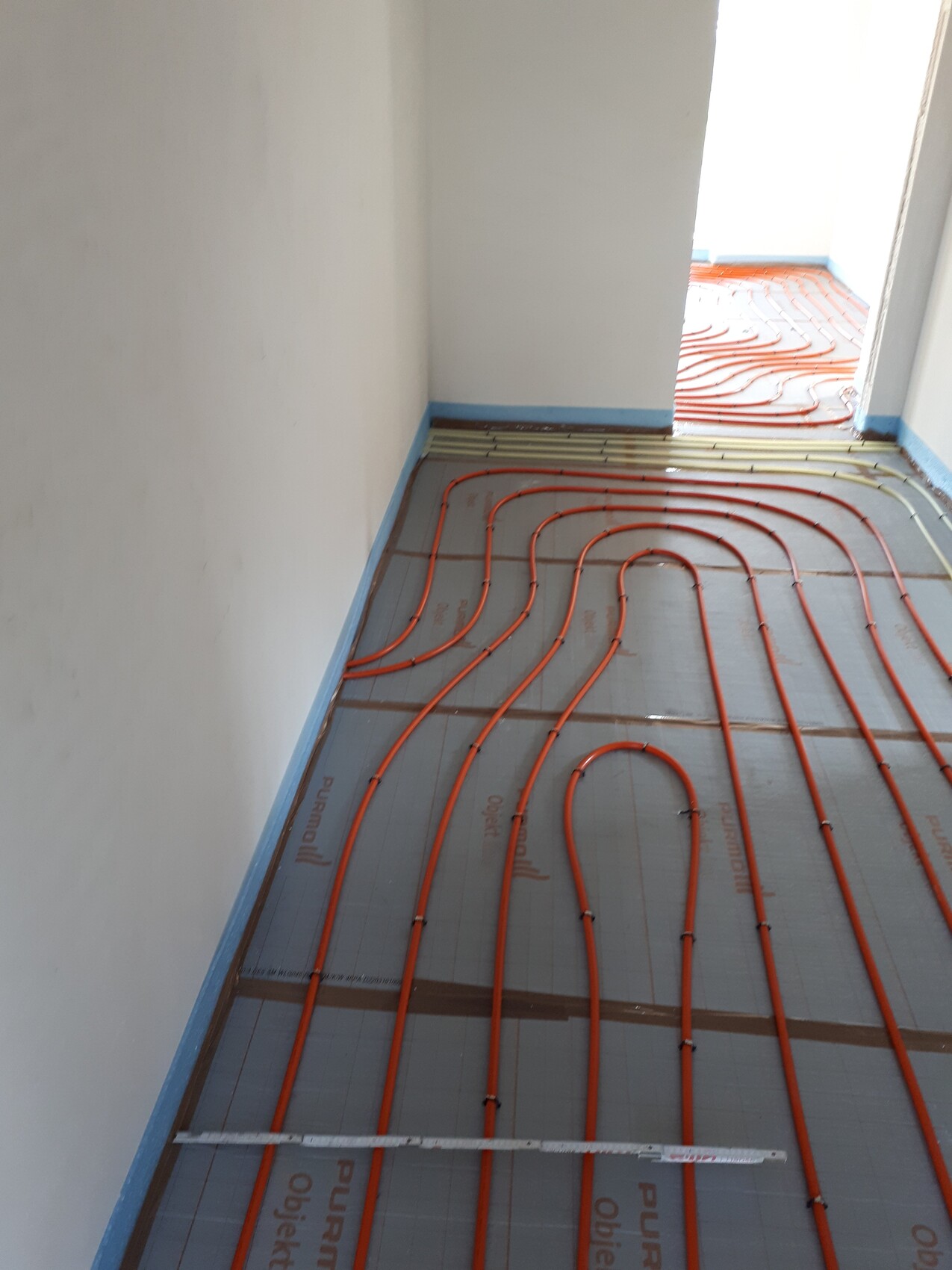

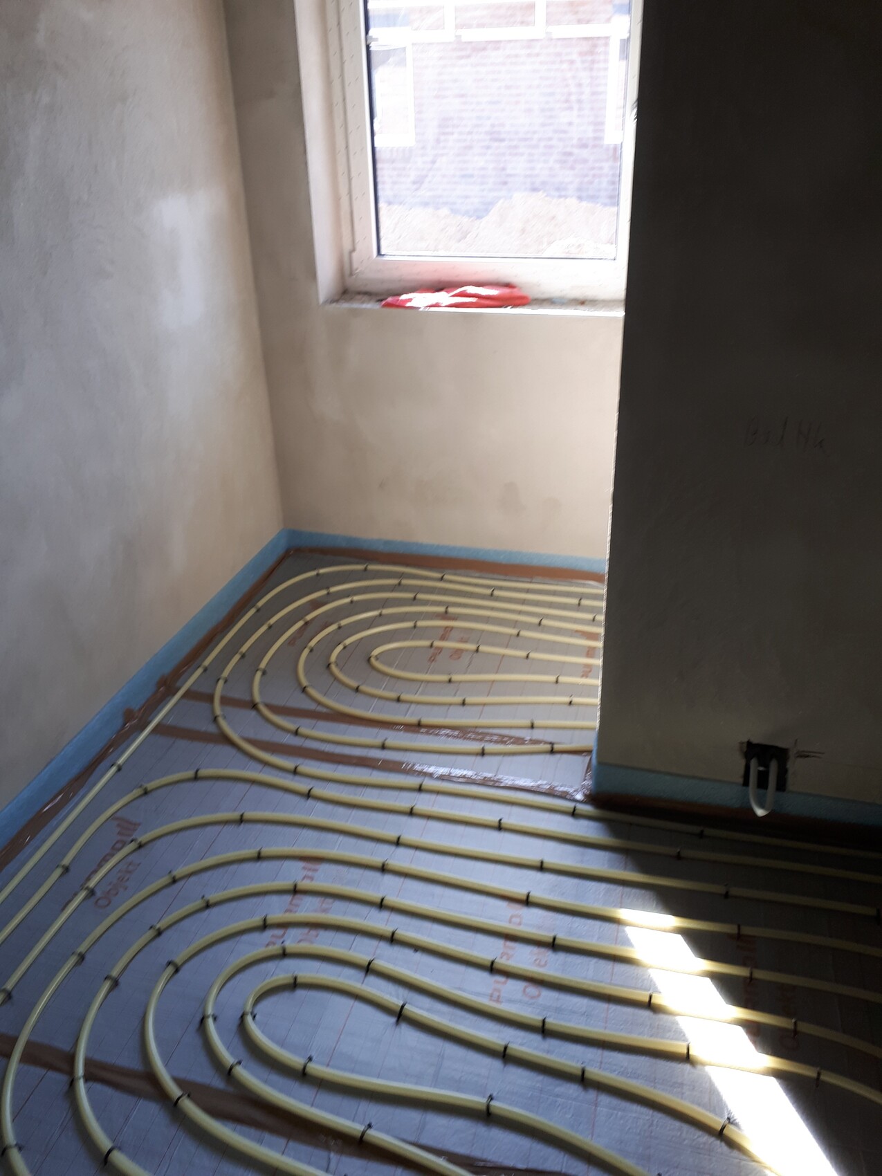

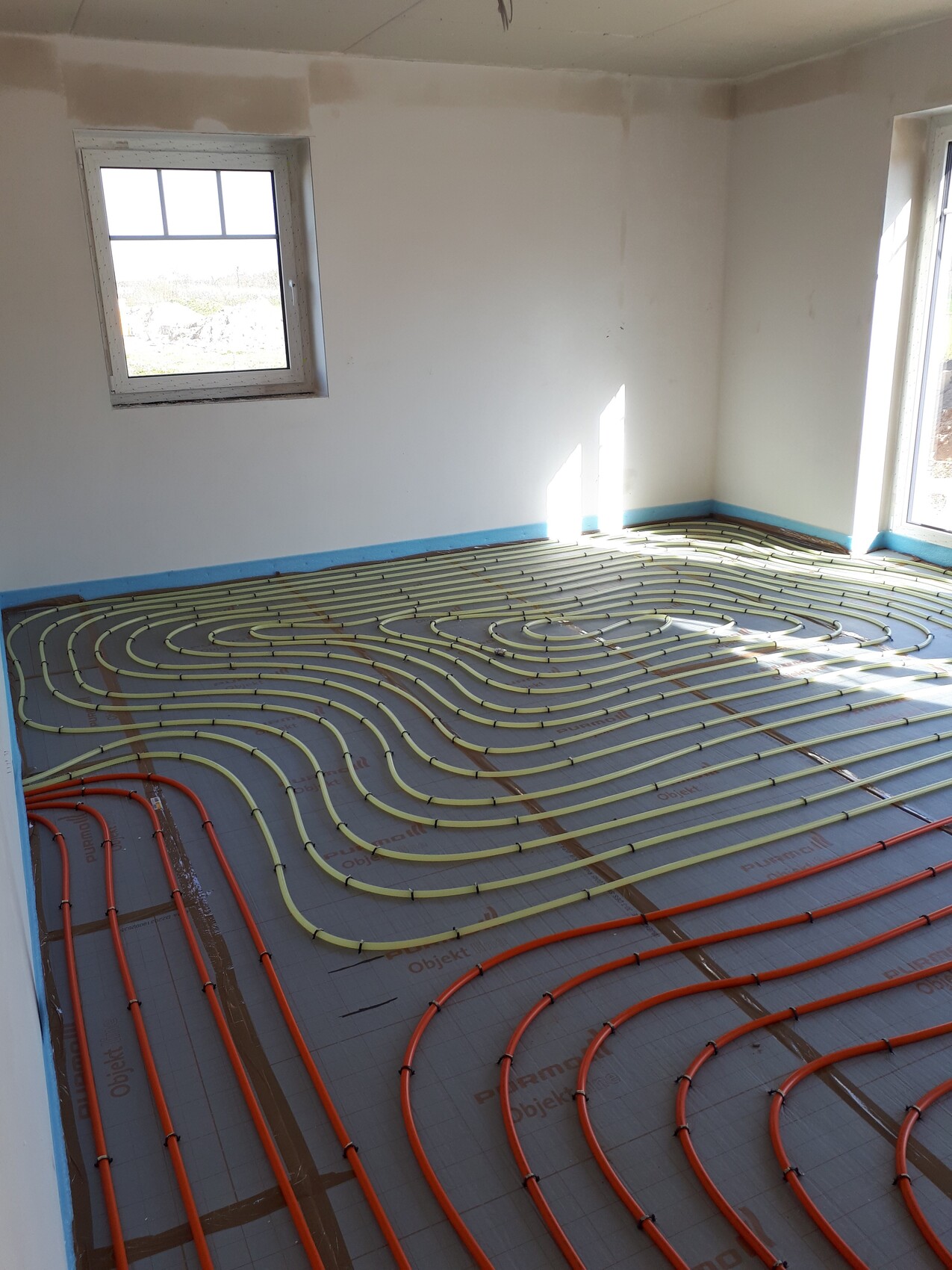

Today the heating loops were unrolled.
Luckily, the screed will be poured on Thursday or Friday. Otherwise, the civil engineering contractor for gas, water, and electricity would have left again after 5 minutes on Monday, because they only start work once the multi-utility duct is embedded in the screed. Oh, and I took four truckloads of sand from the neighbor. He doesn’t have to pay for disposal, and we don’t have to buy expensive fill material for the site. Win-win.

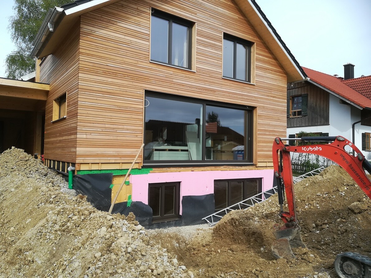

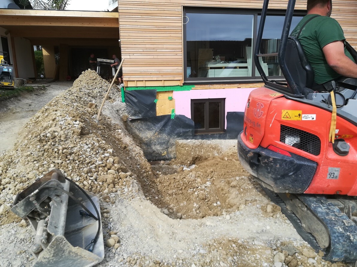

Now something more noticeable is happening again: our multi-utility connection is being installed, and as part of this, our basement entrance as well – so we have earthworks again. Our temporary balcony in front of the large living room window also had to be removed for this:
At the bottom left, where the wood is visible, the basement door will be installed – for now it is secured with that very board.
