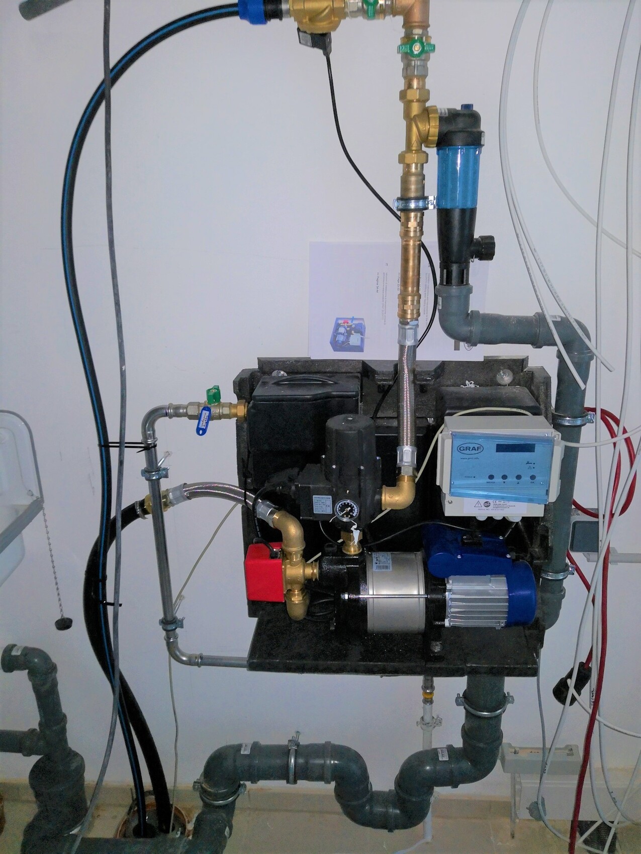

In addition to two outdoor potable water faucets, two fixed outdoor rainwater faucets are also installed.
Optionally, a fixed underground garden irrigation system can be connected via the utility room (for future installation; core drilling already done), and it can also be used for a washing machine.
If additional water outlets are needed, a submersible pump can be added to the cistern and a water outlet installed in the garden. But that’s all still plans for the future.
@rick2018: regarding the fixed garden irrigation, I might have a few questions about your expertise in the more distant future, is that okay?
@dab_dab Yes, we have the Carat XXL with 76,000 liters (20,100 gallons). Originally, we planned for the 92,000 liters (24,300 gallons), but that would have conflicted with the terrain modeling as well as the backwash filter. We control the filter through the home automation system. The cistern is filled with rainwater and water from the well or spring.
Tell me more about the irrigation. The pipes are quite narrow, so large irrigation zones won’t be possible. However, that’s not necessary if the property isn’t large or overly complex. What type of cistern do you have? I believe your pump is rated for 3,600 liters per hour (950 gallons per hour) at 3.5 bar (51 psi). Or is that the larger model?
