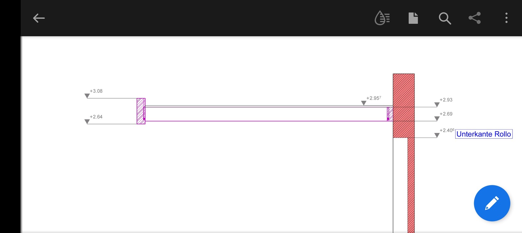

So this is settled. 😉 (5th word)Could you please share the dimensions with me, maybe also the height? Is this the south-facing side? Just to get a better idea for our project. And... how is / will the roof above the boards be constructed?
The roof is 6.00 m (19.7 ft) wide and 4.40 m (14.4 ft) deep.
The niche is 0.85 m (2.8 ft) wide and 1.60 m (5.2 ft) deep.
The heights can be found in the picture.
A 25 mm (1 inch) thick three-layer panel rests on the beams.
On top of this will be the waterproofing and green roofing.
For the slope, the beams were already milled at the factory to direct the incline towards the outlet.
At the outlet, there will be an external gutter box, from which a downpipe leads down to the granite wall with free drainage.
