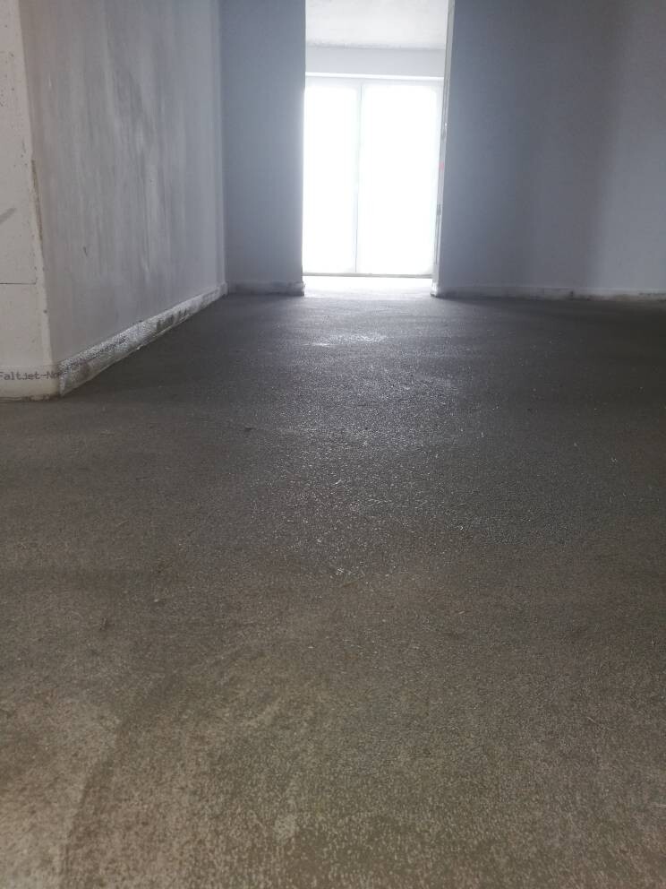

R.Hotzenplotz schrieb:
I had asked the site manager if the unevenness in the concrete floor was within the specified tolerance limitsFrom what you described, I had imagined sloping surfaces or slight dips, but at least reasonably smooth on the surface. Here, it actually looks like scar tissue, as if the concrete mix had clumped up quite a bit :-(
R
R.Hotzenplotz9 Jun 2018 18:05Yes, that looks bad. Under the bitumen membranes, it looks even worse in some areas.
If I’m unlucky, they might also close off the remaining open sections tomorrow before the inspector arrives.
I’m curious how the inspector will react and whether this will lead to a construction halt.
The question I have is why they are applying a waterproof membrane at all. This is usually only used for building components in contact with the ground (typically in the basement, or if there is no basement, on the ground floor), but since you have a basement underneath, there shouldn’t be any need for a waterproof membrane there.
Otherwise, this doesn’t look particularly serious to me. It’s just the point where the scraper is lifting the protective sheet. You see this kind of thing quite often, so I don’t find it especially concerning. I’m curious to see what the inspector will say.
R
R.Hotzenplotz9 Jun 2018 18:40Where the bitumen sheets are currently located is the area without a basement. We only have a partial basement.
