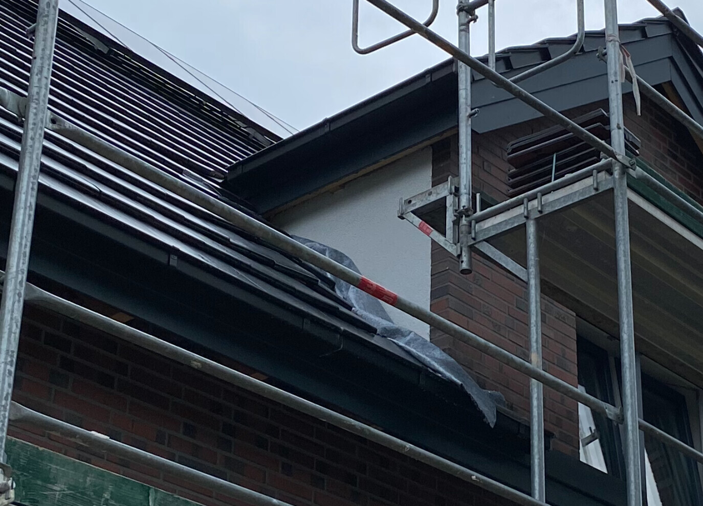

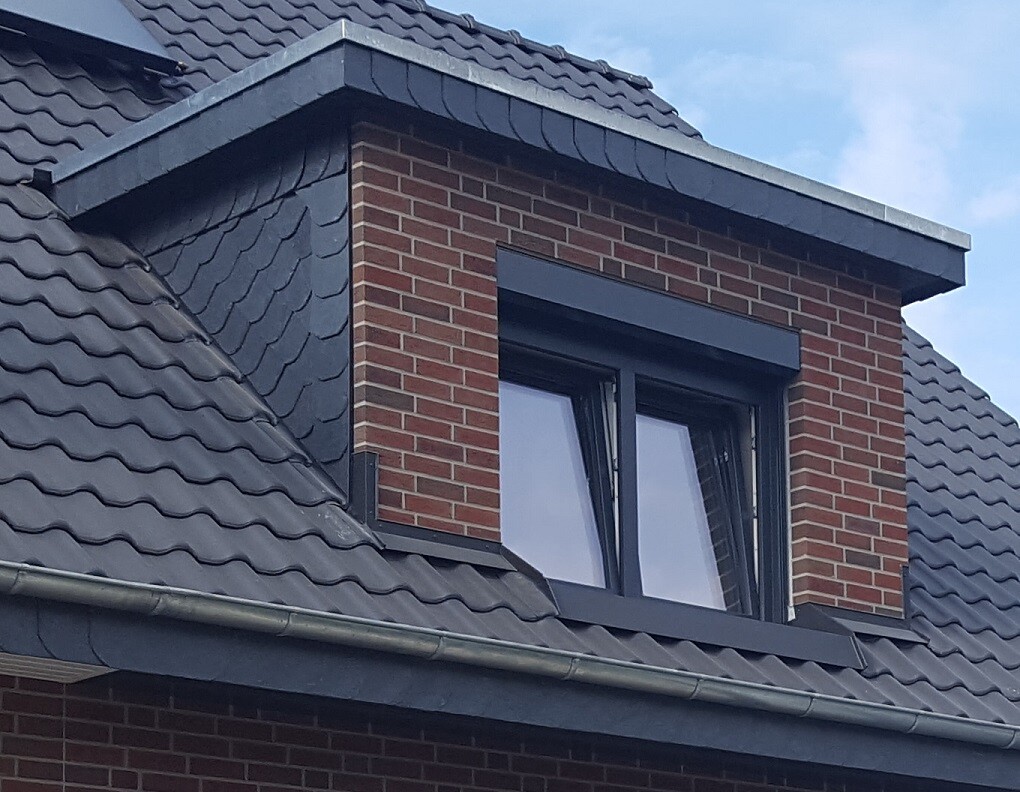

The slate cladding can only be installed after the eaves underlayment, and the lower rows of tiles only after the slate. I found this discussion with @Müllerin about the gable cladding because I’m currently wondering how to properly install the slate. For us, the stair bay facing the street and the basement window are to be finished with textured plaster. Today, we saw that the gable facing the garden was also plastered. Slate is agreed upon because we didn’t want to pay for brickwork. I definitely don’t want plaster there—first, definitely not white, and second, I want to avoid having to repaint it ever again.
It looks like this now and appears “finished.” Simply nailing the slate to the insulation foam underneath won’t work. How is slate usually fastened? Does the plaster and insulation need to be removed again to install battens?

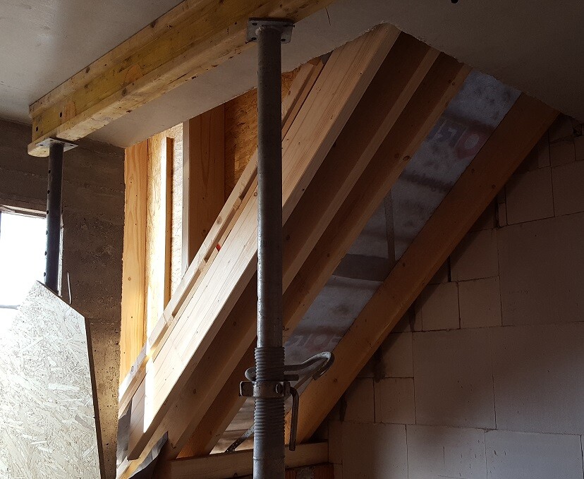

From the inside, you can see that the window front is built with masonry and the sides are made of wood; the insulation (glass wool) is installed from the inside.
At the front, there is brickwork; on the sides, a protective membrane over the wood.

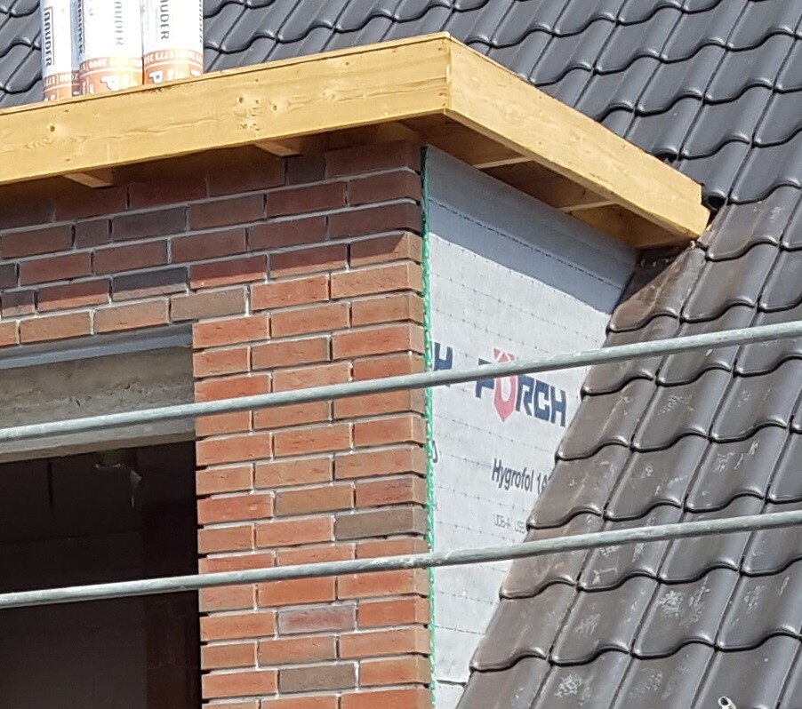

Unfortunately, I don't have a photo for this, but based on this picture, I assume that the moisture-resistant (?) membrane is directly covered with slate.
So, looking at your photo: if the white layer on the outside is insulation (Styrofoam?), then there definitely should be something on top that you can nail into.

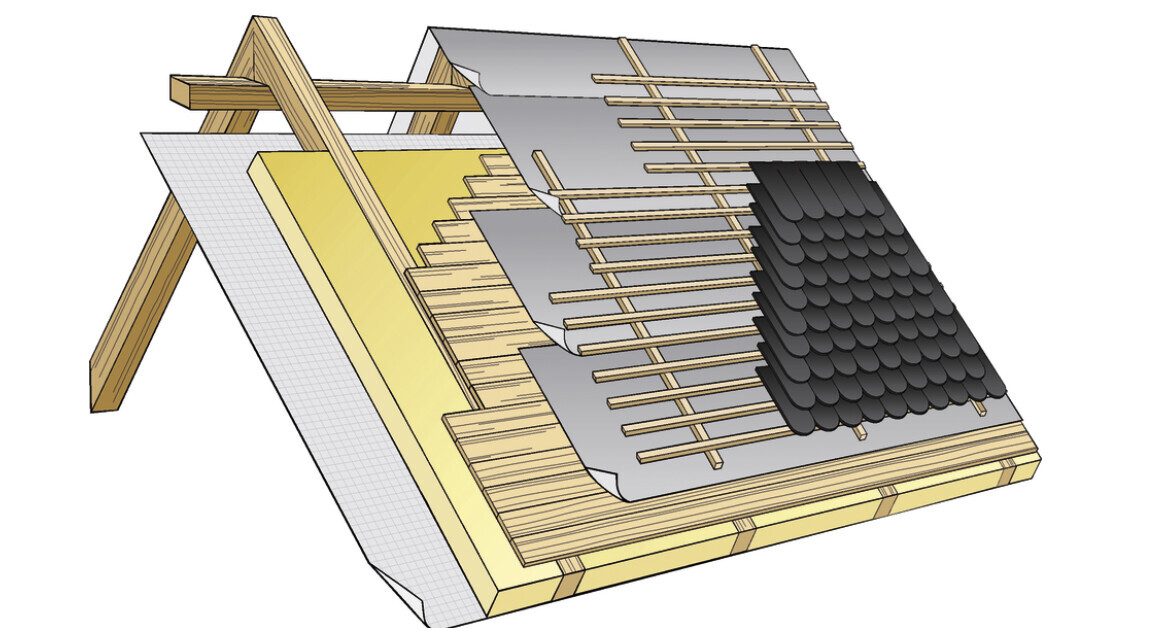

Thanks a lot! Now I’m looking forward to the contractor’s response. According to Förch, it should be installed something like this: I admit that “discussion” is a bit exaggerated. I meant post #2616.
