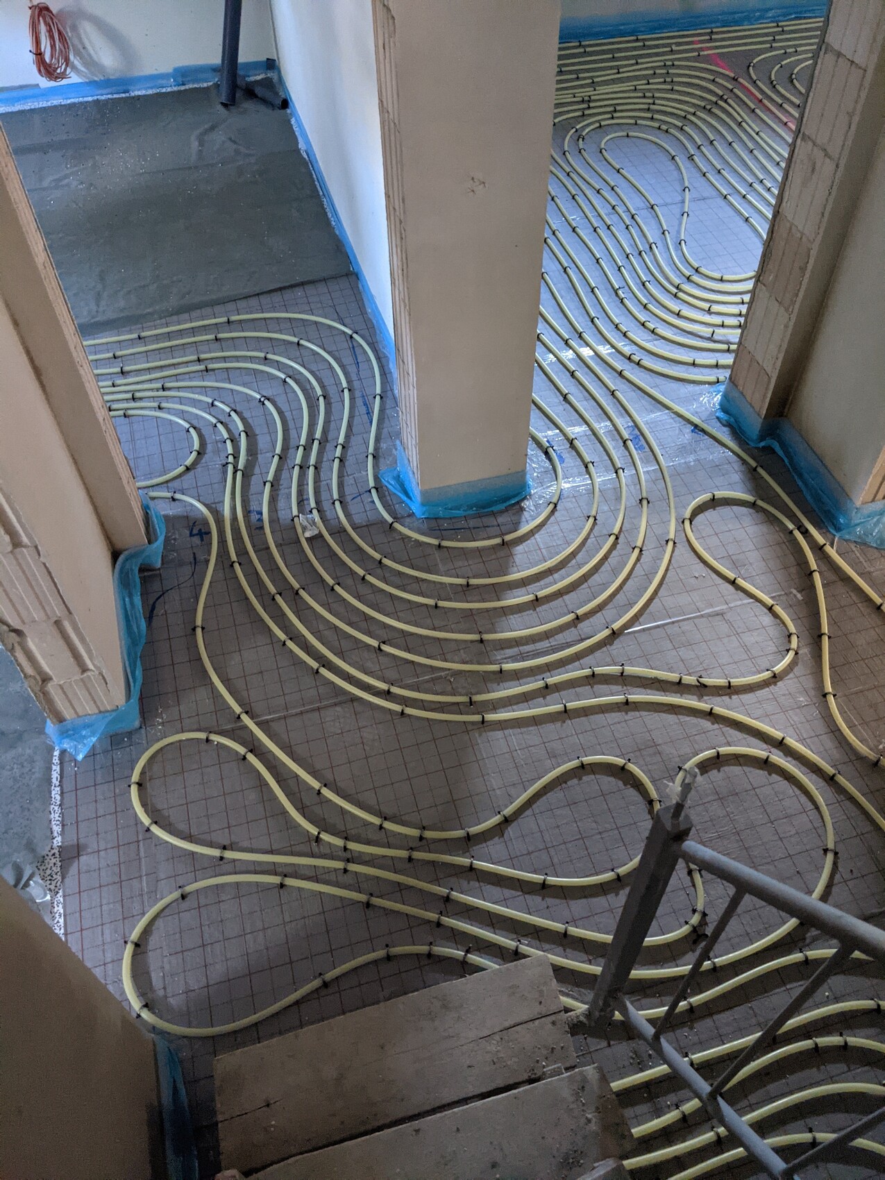

Strahleman8 May 2021 07:39Now that the plastering is done, we are installing the underfloor heating ourselves. You really know you’ve accomplished something by the end of the day 😀
Unfortunately, the hallway in the basement didn’t turn out very well, but since it’s not a living area, it’s not a big deal. So far, all the heating loops are between 75m and 85m (82ft and 93ft). However, one loop has to be removed again today because the pipe is kinked at one point. But practice makes perfect, and we have plenty of extra pipe in reserve 😉
Even though things didn’t run smoothly at the beginning, we’ve been on a roll the past few weeks: the drainage can now be routed outdoors without a lift station, directly by gravity drainage (saving us nearly 10,000 euros), the plaster is of excellent quality (we ordered Q2, got Q3), and once the screed is installed on Tuesday, we can check this off the list.

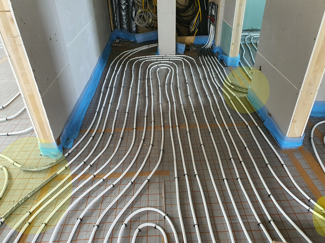

Strahleman8 May 2021 07:59i_b_n_a_n schrieb:
Please also remember to protect the pipes around the door areas.Yes, we already have the slotted corrugated pipes on site. I planned to install all of them during the last inspection. I forgot about the basement though; the staples around the door area still need to be removed there.
