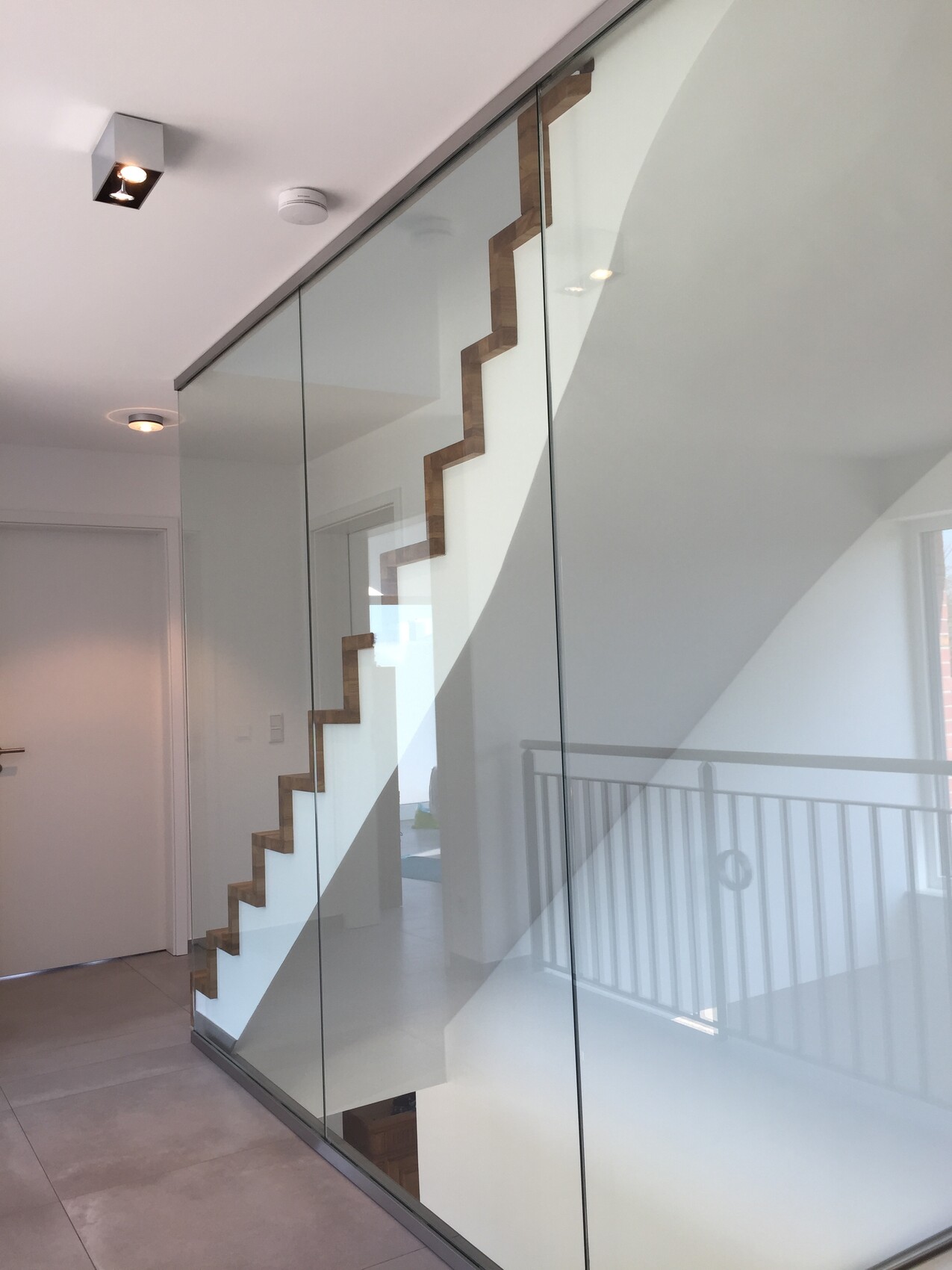

We ordered the glass partition through the general contractor (GC), who then subcontracted a glazier.
The additional cost for the glass was, for the ground floor and first floor combined, around 8,000 euros gross (in 2016/2017), for laminated safety glass (two panes with a foil layer in between). I don’t know the exact thickness right now; in the first floor one (!) panel weighs about 140–150 kg (310–330 lbs), with dimensions of approximately 245 x 120 cm (96 x 47 inches).
The stainless steel handrail was provided as standard through the GC. The extra cost for a wooden railing would also have been considerable (I think around 800 euros for two pieces), but we didn’t want that.
Tiles and carpentry work (stair coverings) were, as mentioned before, contracted separately.
About the glass:
The sequence of trades is not without challenges. In our case, the glaziers came after the tiling and stairs were done (we were already living in the house by then). Fall protection was therefore also an important issue — which, on paper, according to the TRAV guideline, would require on-site destructive testing, but in practice can be done without and still holds up.
The heavy weight of the glass near the stairwell edge is a critical point, which had to be coordinated carefully with the screed, tiles, and underfloor heating. There is about a 5 cm (2 inch) gap, but when factoring in the render, it’s quite close, though well distributed by the large tiles.
The glazier made two measuring appointments on site (because at the first appointment the wooden covering on the ground floor stairs wasn’t finished yet). During the second appointment, a wooden model of the angled run on the ground floor was built and then transferred onto the glass. On the ground floor, the glass weight rests only on the glass supports, which were specially reinforced with heavy-duty anchors and injectable adhesive in the sand-lime brickwork. Carrying the three 140 kg (310 lbs) glass panels upstairs was quite a job for three strong men (all work done by the glazier).
With a toddler, there are naturally lots of happy little hands pressing on the glass, but they eventually grow out of that.
For this reason, we painted the wall side of the staircase with latex paint, which has proven easy to clean.
Sound reflection (echo) is also an issue (at least it builds up without curtains on the ground floor with large windows and tiles), but we have managed this well downstairs with linen-covered stretchers on canvases.
But the stairs are the visual focal point of our home, which meant extra effort and cost. We are still very satisfied with the result.
