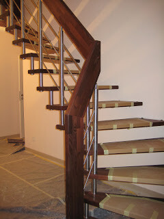

Matthias18216 Aug 2016 10:35The staircase will not fully rest there, as it is a modular staircase system. Each step is individually anchored into the load-bearing wall. Only the first steps at the bottom (the staircase has a 90-degree turn at the base) have a support on the tiles in front of the side panel of the front door.
Here is an old photo from the construction phase.
