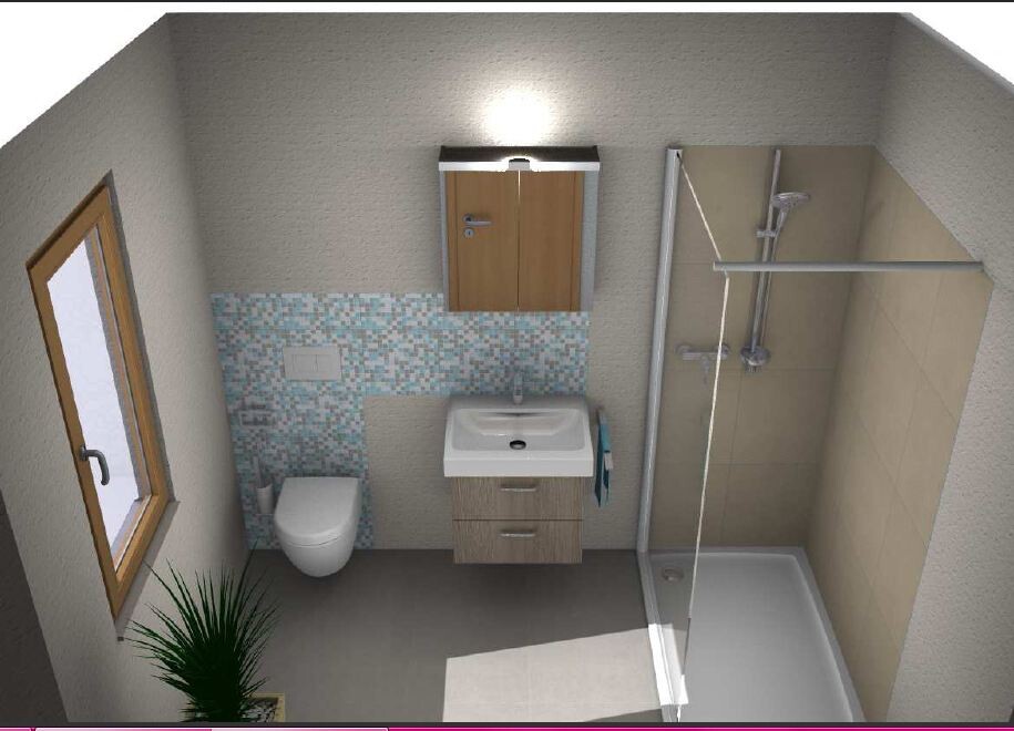

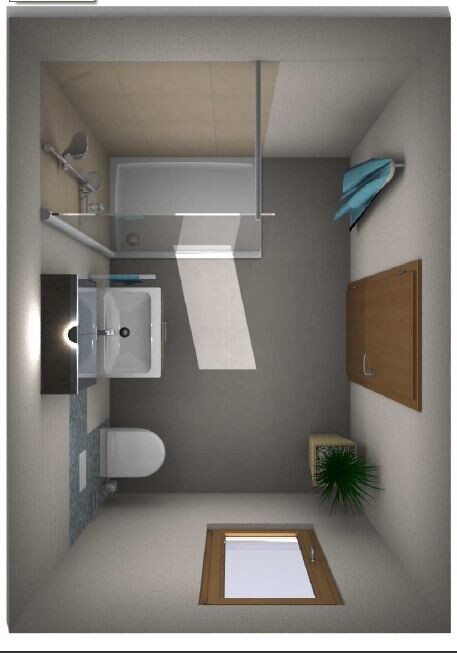

we are currently thinking about how to tile our bathrooms.
The photos show our small bathroom / guest bathroom on the ground floor.
The photos are mainly to give an idea of the layout, arrangement, and size.
This helps to visualize it well.
The color and distribution of the tiles in the photos are not accurate.
This is also my question – how would you tile the bathroom, which areas would you tile, which not, or would you tile it completely?
We are a bit undecided about how to divide the tilework.

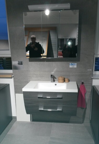

We are quite clear about the color, though. We want very light gray concrete-look tiles, combined with dark gray wooden furniture – similar to the third photo – only the tiles should be lighter.

We want very light concrete-look tiles in gray, paired with dark gray wooden furniture—similar to the third photo, but with lighter tiles.To me, that’s a bit too much gray (and I love gray and industrial style), but too much is too much.
I would suggest tiling up to the height of the stud wall, so about 120/130cm (47/51 inches) across the width of the toilet and washbasin, or even a bit higher, around 140/150cm (55/59 inches).
However, give the cabinet a warm wood tone and echo that in the shower tiles. Paint the other two walls a neutral warm white.
