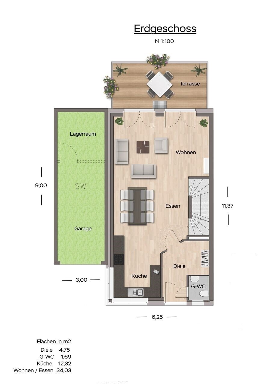

we are currently building a semi-detached house with underfloor heating and are still unsure about the flooring for the ground floor. The entrance area and guest toilet will have floor tiles.
So far, the plan was to install oiled hardwood flooring in the living area including the kitchen. However, since we have two cats who sometimes vomit, we are worried this might be harmful to the hardwood floor.
The alternative would be wood-look tiles. We currently live in a rental with plain white tiles, so wood-look tiles would be the only compromise. However, we would really like to enjoy the indoor climate that hardwood provides, but we have the concerns mentioned above.
