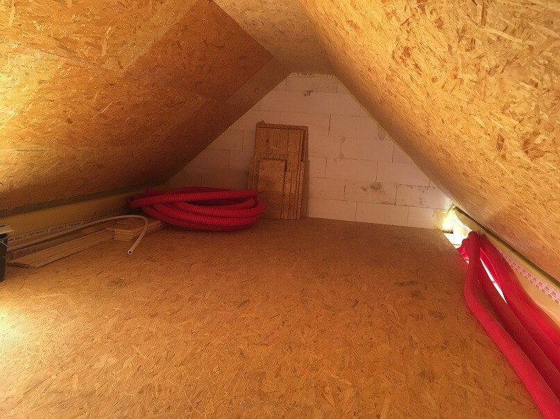

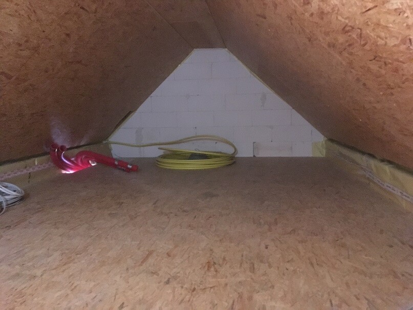

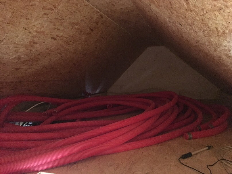

sirhc2 Jan 2017 10:10
The final result from last Thursday looked like this. However, a wall still needs to be built roughly below the ridge to hang the boiler on. And the ventilation ducts are quite a nuisance.

2 Jan 2017 10:18
@sirhc
How high is the ridge? 1.80 meters (5 feet 11 inches)?
I’m just imagining the plumber having to work on the heating system up there...
