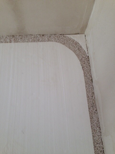

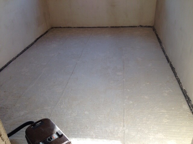

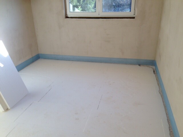

Today I started insulating under the underfloor heating. First, sweeping, vacuuming, chipping off plaster residue, and removing dirt from between the wiring. Then the installation could begin. The bottom layer is 30 mm (1.2 inches) of polystyrene insulation with a thermal conductivity of WLG 035, installed between the electrical cables. The second layer is 50 mm (2 inches). On top of that comes the carrier board for the underfloor heating (30 mm / 1.2 inches), then 65 mm (2.6 inches) of screed and the floor covering. This results in a total buildup height of 18 cm (7 inches). I’ve never done anything like this before—this is definitely a classic DIY task. I started with the simplest rooms to learn as I went. The first room took 3.5 hours, but with the second of the same size, I was down to 2 hours. In rooms with (insulated) water pipes, the 50 mm layer goes below, and the 30 mm layer goes on top. I took my time, cut everything precisely, and fitted it carefully. Consequently, I used very little of the “granulate” material. A professional doing this for money probably wouldn’t invest that time. The cost savings are modest, but I’d rather do it properly myself than have it done carelessly. I estimate I will spend 30–35 hours on the whole house, saving around 1000 EUR.

Thank you all. Since I had never done this before, I naturally started with the simple rooms to get a feel for it. Today I worked on another simple room and then began in the living room, where there are many more cables and the water pipe was also added. The outside was more difficult, but the central area has much simpler surfaces.
