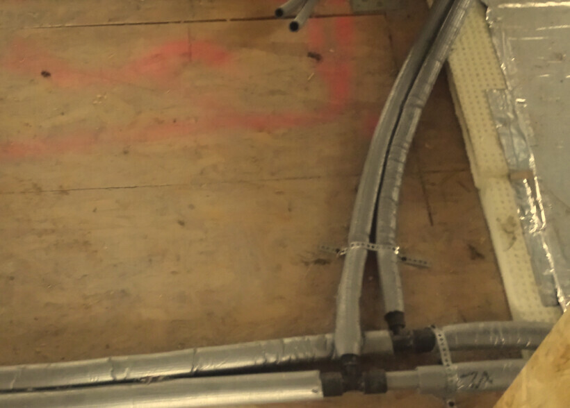

as shown in the two photos, the hot and cold water pipes are insulated. The plumber says the fittings (connectors) do not need to be insulated because they are made of plastic. Is this correct, or could this cause problems regarding thermal insulation, condensation, or noise?
The pipes are located under the screed, meaning there will be polystyrene insulation and a self-leveling screed on top.
The plumber suggests he could wrap fleece over them, but says it is not necessary. What is your opinion?
Best regards, Andreas

The insulation is adequate for heating pipes, but...
Drinking water pipes should never be installed in a floor with underfloor heating.
Insulation won’t help here because your cold water will always be warmed up initially and may potentially become contaminated with bacteria.
The issue is not heat loss from the pipe, but that it cannot stay cold.
This assumes an ambient temperature of about 24°C (75°F).
Your underfloor heating runs at around 30 to 35°C (86 to 95°F).
Therefore, your cold water temperature will match that.

Alternatively, run new pipes above the ceiling.
