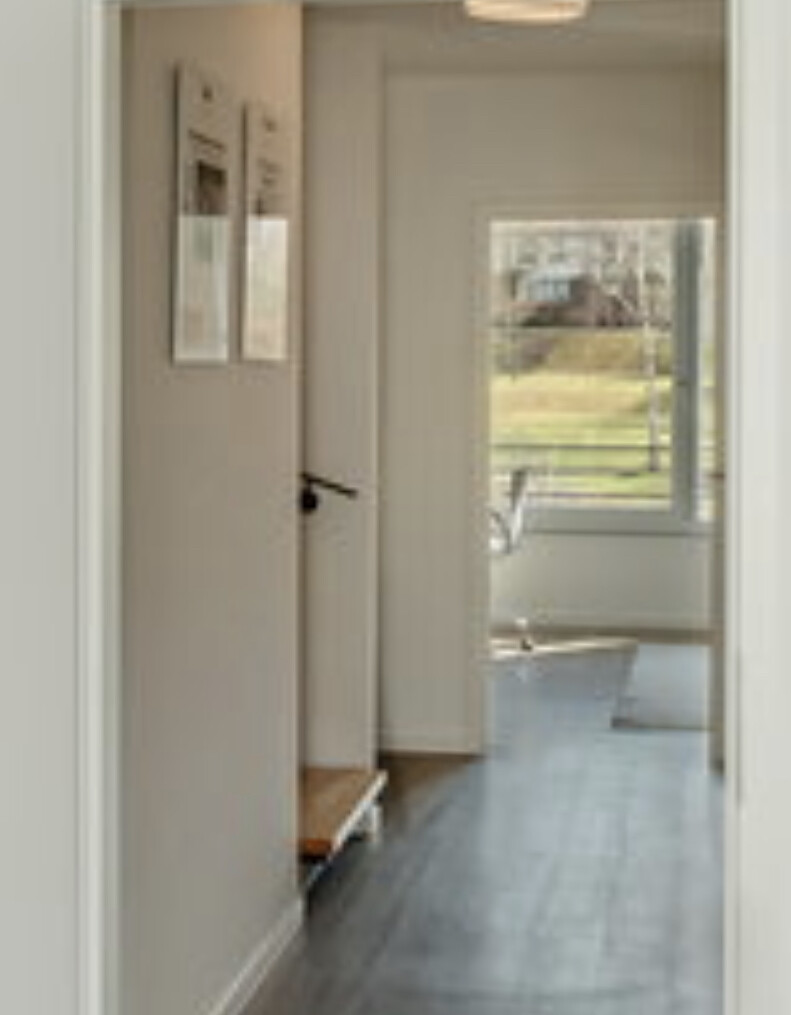

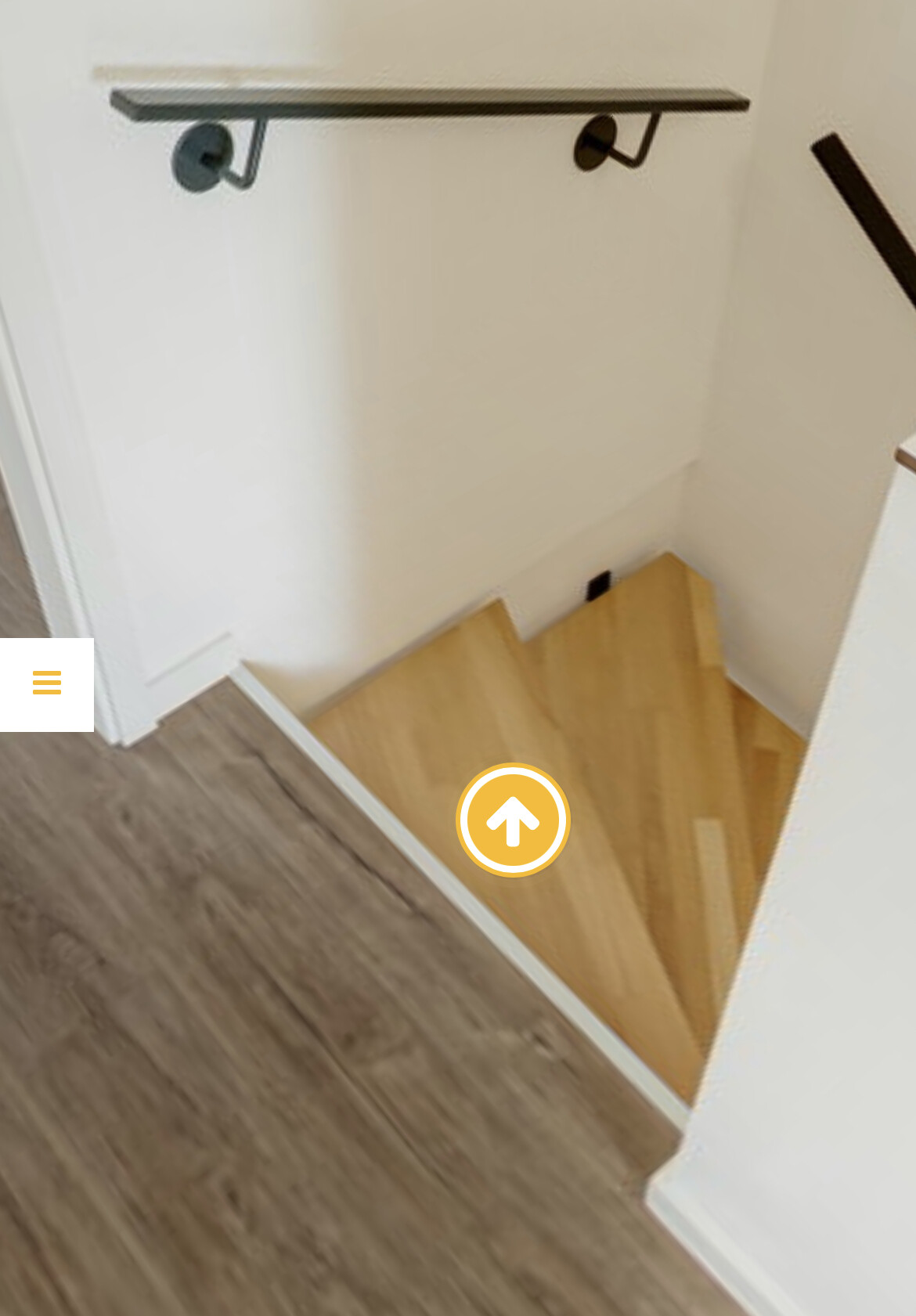

Overall, you will find very few people with your particular setup here. Almost everyone has a screed layer, with very few exceptions, mainly because of underfloor heating.Here I have 2 pictures from their website (although with laminate instead of parquet), one looking downward (where we don’t have a ‘last step that must be flush with the floor’), and one looking upward (here there is roughly an estimated 20–30cm (8–12 inches) up to the metal edge). I hope this helps somewhat.
PS: In the upper floor/double house, we don’t have underfloor heating.
christophen25 Feb 2022 20:42hanse987 schrieb:
The staircase should already have been installed by your builder. Each step in a staircase has the same rise. If you choose a floor buildup height that doesn’t match the step height, you'll end up with a serious trip hazard. I see.. isn’t it possible to place something under the steps so that all (really all) steps are slightly higher? We were planning to close off the lower opening of the stairs anyway..
