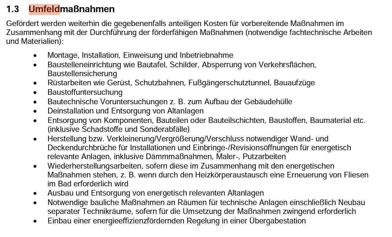

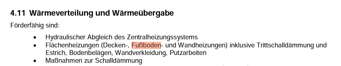

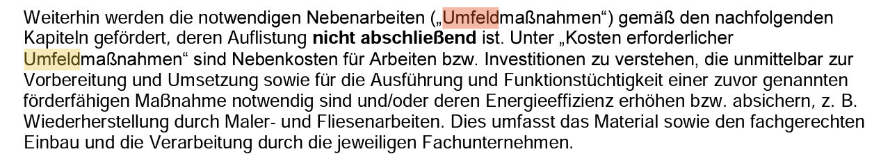

In this context, I have another question: What about the so-called “ancillary measures”? Due to the renovation, there will be a new floor covering (tile, vinyl, or wood), possibly a new screed or milling work, new door frames and possibly doors, new painting, etc. Can someone tell me which measures for restoring the surrounding areas are eligible for funding, assuming the €60,000 (sixty thousand euros) maximum cost limit has not been exceeded, and if so, at what rate (the same funding rate as for the heating system)?
Many thanks and best regards!
SaniererNRW12330 Oct 2022 15:27FCBenne04 schrieb:
In this context, one more question: What about the so-called "surrounding area measures"?Basically, everything is subsidized – this is also stated in the BEG information sheet:F
