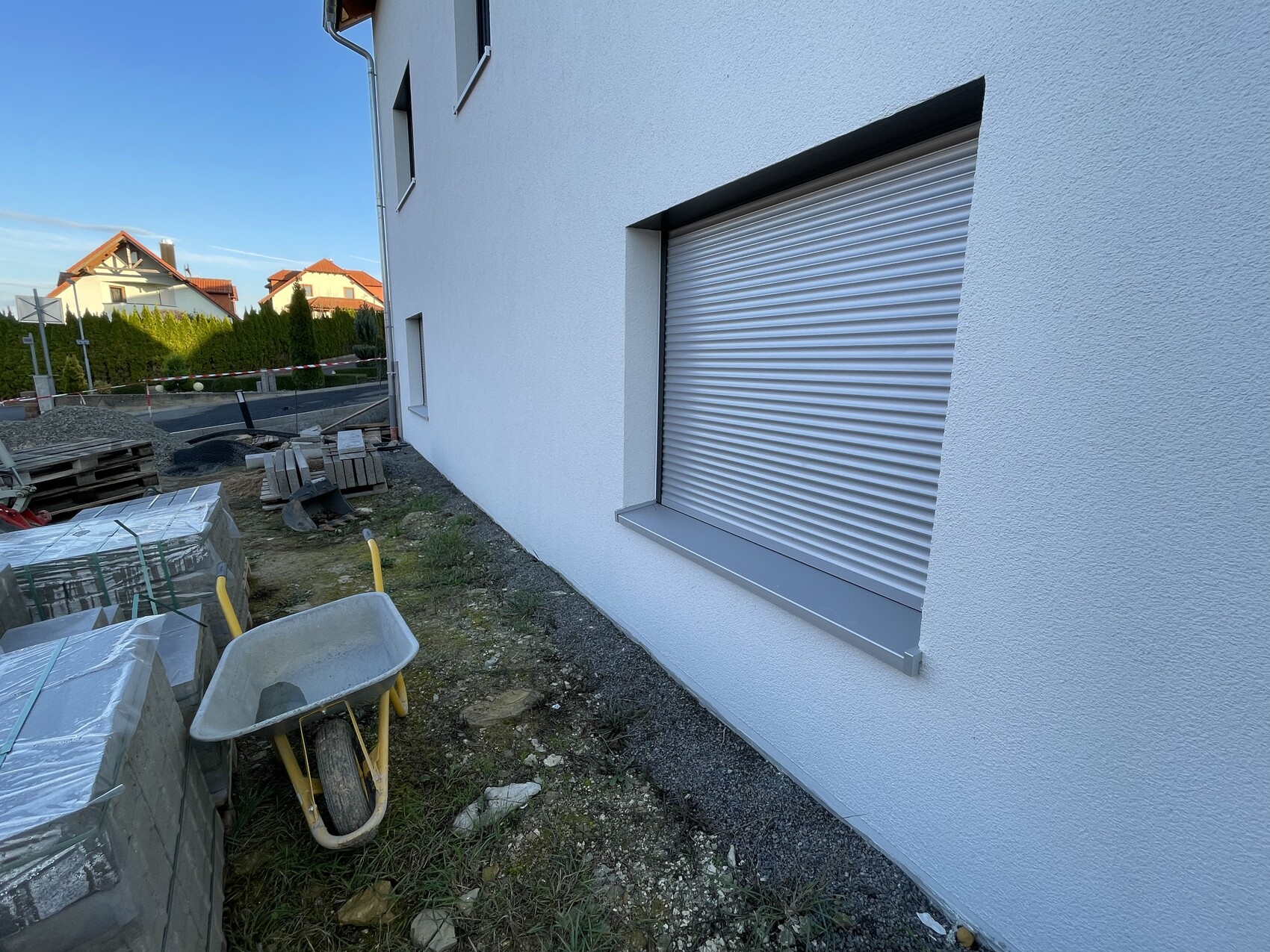

Thank you to everyone who has responded so far, including the small forum rant (which I probably deserved). I mentioned earlier that I had already posted about this several times; however, I am still making very unsatisfactory progress. I can’t be the only one who hears something different from every “expert” when it comes to a building topic.
I must have missed that several people asked for pictures. I’m not sure if I can provide anything meaningful, though.
Here are two pictures for reference. In the photo with the light wells, L-shaped concrete blocks will still be installed (the steel rods serve as a guide), and the space between the L-shaped blocks and the house will then be backfilled.
In the second photo, the ground is roughly filled up to just below the windowsills.
The white walls in each case are the areas that need to be treated or protected.
I stick to my opinion. The plaster must be removed first, then KMB or a flexible waterproofing slurry applied. After that, the usual options are either insulation plus studded membrane or just the studded membrane alone. Which type of studded membrane to use depends again on the soil and its water behavior.
SaniererNRW12314 Nov 2022 21:22Tolentino schrieb:
I stick to my opinion. The plaster must be removed and then KMB or a flexible waterproofing slurry applied.I’m not sure if the plaster needs to be removed. Other than that, I agree with you.According to my expert, this must... The plaster cannot withstand constant moisture. If you apply the waterproofing directly onto the plaster now, moisture will still get through from below. It will then absorb the moisture due to capillary action. Just placing a board in front is probably even worse.
