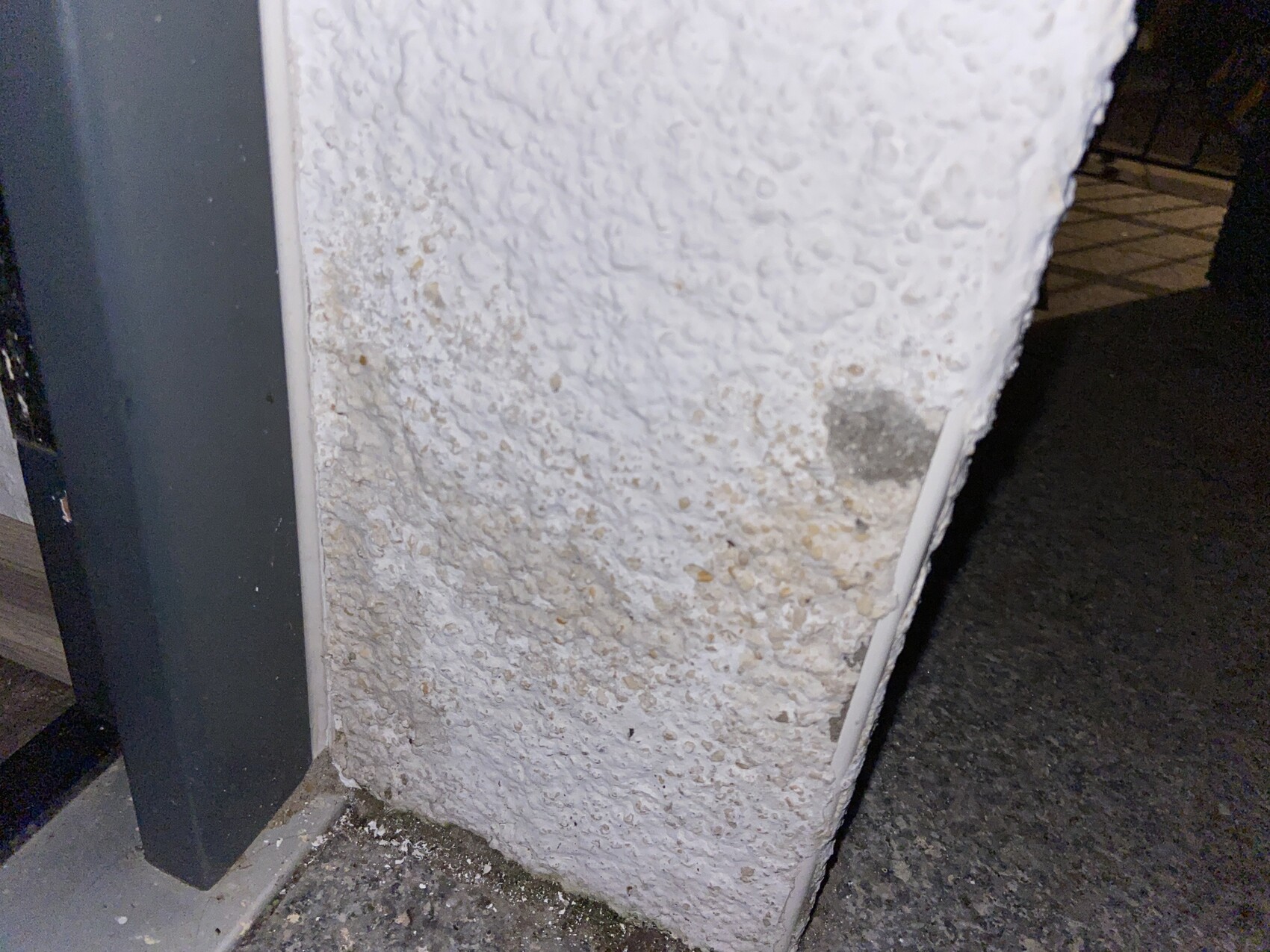

Hello – I have noticed discoloration on the exterior plaster in the entrance area of my building, which is about 6 years old. There is also some damage to the topcoat plaster in that spot.
I understand remote diagnosis is difficult, but I have some questions for the experts:
- Is this due to mechanical stress or possibly moisture damage?
- Does something need to be done immediately, and if so, what would be the appropriate action?
Photos attached.
Thank you for your assessment.

andreas.delgaldo19 Feb 2022 17:14Hi @jcan – the issue is currently visible only around the reveal area.
I suspect it is caused by rising damp. Water has likely run down between the door threshold and the paving slabs. Since the ledge for the concrete slab is located there (which is sealed at that spot), I think the water has collected there and, once in sufficient quantity, gradually pushed the plaster upwards from the side.
The joint between the concrete slab and the plaster was probably not additionally sealed, which is likely where the damage has occurred.
At the moment, moisture measurements on the wall have not shown elevated levels. So I currently assume the dampness is only superficial.
I’ve also attached a photo from another part of the house (patio door) to show the transition between the concrete slab (which appears to have a membrane) and the house (or plaster). You can see at the corner beneath the window frame that this joint between the plaster and wall assembly seems to be a weak point where moisture can penetrate the plaster.
What do you think about this? Could the problem be permanently resolved by sealing the joint between the plaster and the concrete slab?
Thanks for your feedback
Andreas

andreas.delgaldo21 Feb 2022 15:27From a purely practical standpoint, that would be my idea – but it probably wouldn’t comply with standards, right?
jcan schrieb:
In this situation, I would probably just seal the corner area and see what happens. Ideally, you would make sure that no water can remain standing there, basically rounding off the corner. But then you might need a different material again.
I think that once you start following the standards, the costs will increase. However, given the situation, I doubt that it will bring much benefit. If only the reveal area is affected, seal it properly and make sure no water can accumulate in the corner. It’s always difficult to judge from the photos alone. I would initially go with this minimal solution. The current damage in your case isn’t that severe either.

andreas.delgaldo21 Feb 2022 16:40At least the visible damage.
What is happening underneath cannot be assessed without inspecting below first.
Thank you for your assessment. What makes you think it is not that high?
