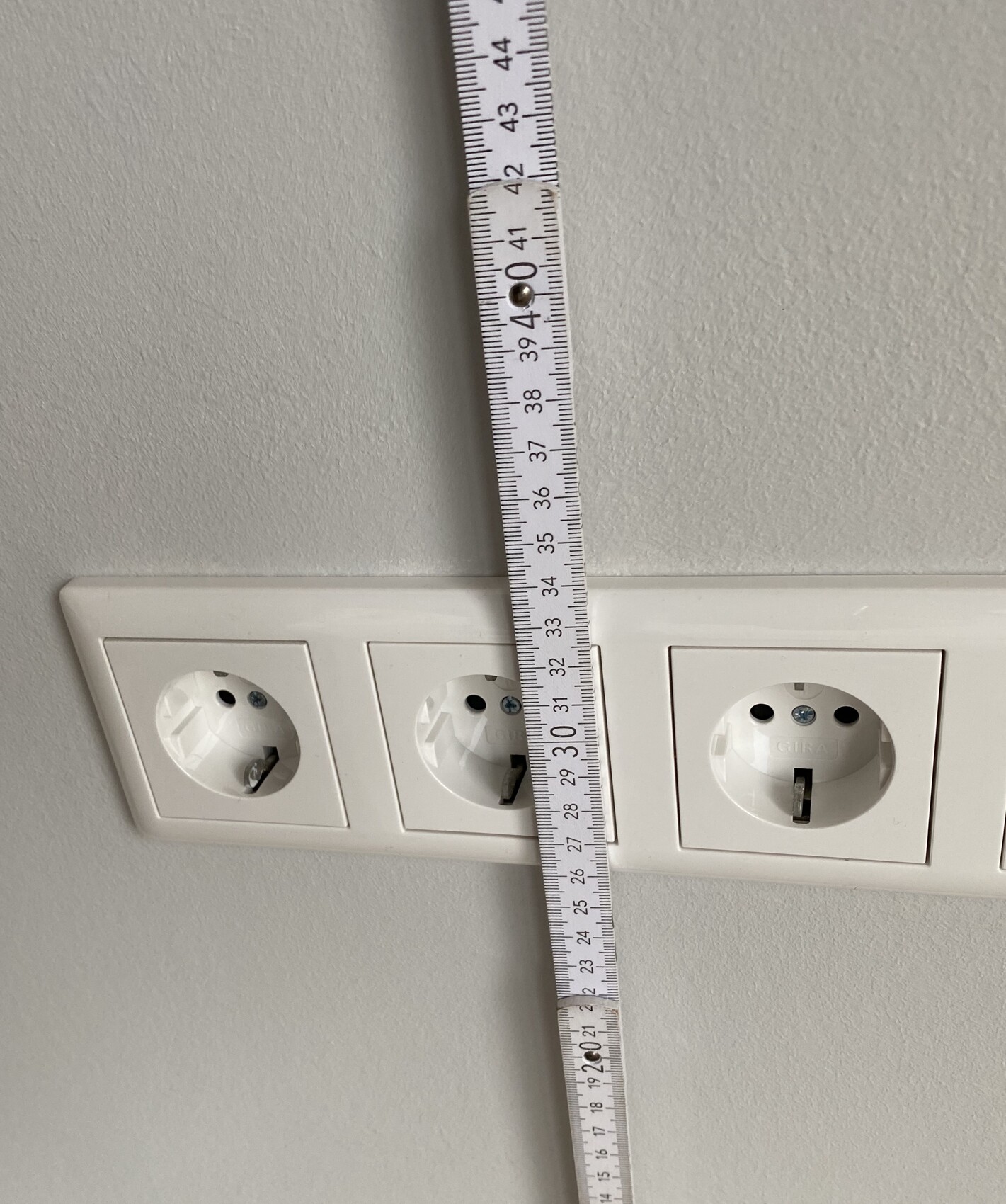

goalkeeper3 May 2020 09:17We only had Q2 as well. The painter then filled and sanded the “holes” that appear on interior walls during construction (about 15 hours), afterwards wallpapered with a slightly thicker fleece (150g) and painted twice. We are very pleased with the result, and it was significantly cheaper.
I would therefore not recommend using very thin fleece. Thicker fleeces can also cover small holes here and there. Thin fleece, on the other hand, does not forgive any imperfections.
Attached is an example photo of our wall. Please ignore the measuring tape and electrical outlet.

goalkeeper schrieb:
We only had Q2 as well. The painter then filled and sanded the "holes" that naturally appear on interior walls during construction (about 15 hours) and afterwards applied a somewhat thicker fiberglass wallpaper (150g) and painted it twice. We really like the result, and it was significantly cheaper.
I would rather not use the very thin fiberglass wallpapers. The thicker ones help cover smaller holes here and there. Thin fiberglass wallpaper, on the other hand, doesn't forgive any imperfections.
Attached is an example photo of our wall. Please ignore the measuring tape and socket. But here again, it’s about painter’s fleece + paint. Why exactly are these two steps necessary? Why does no one just use regular non-woven wallpaper that already comes pre-colored?Similar topics
