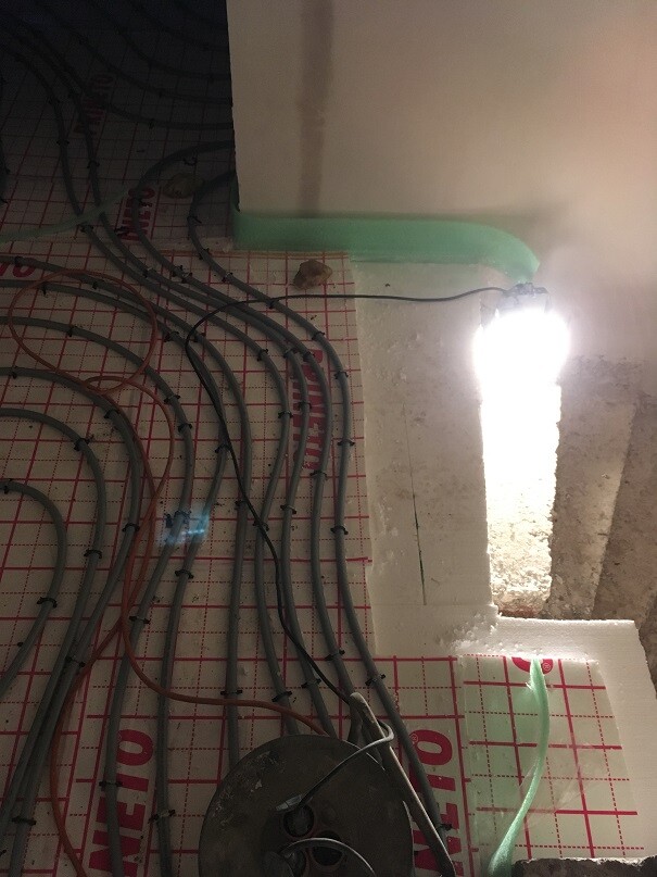

1 - a bit of Tetris while insulating. My edge insulation strip was removed because it didn’t have a tab facing inward and was installed too low. The installer replaced it with a new insulation strip.

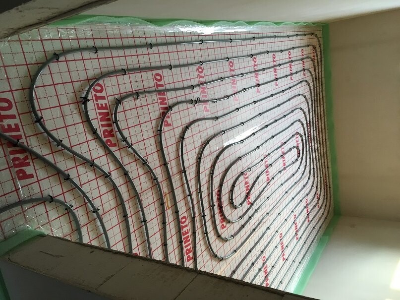

2 - underfloor heating in a child’s bedroom
4 - underfloor heating in a bathroom

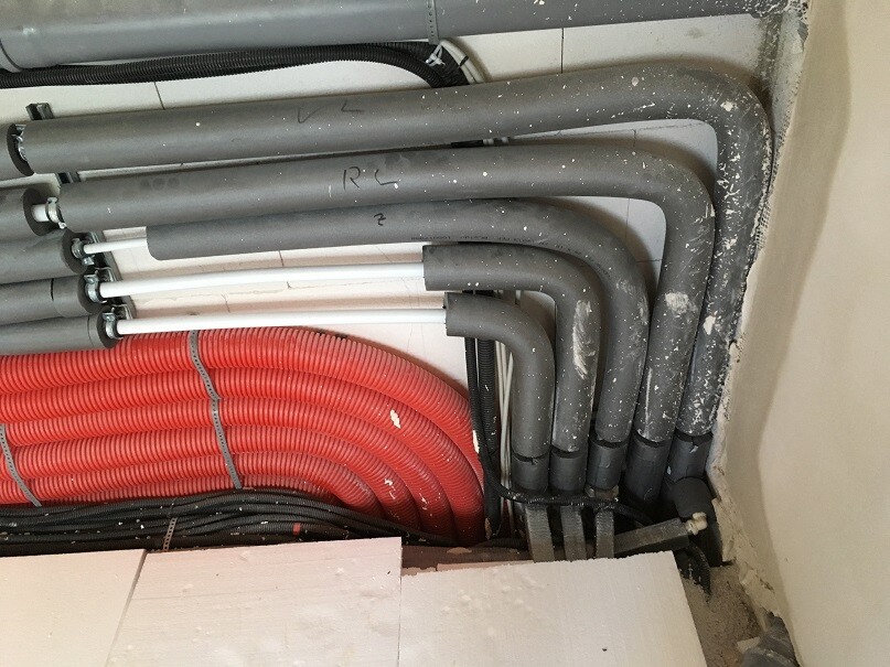

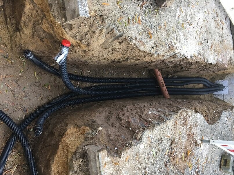

6 - multiple utility lines introduced through the exterior and interior cellar wall and connected together – this required strength and patience (or at least 500 EUR to the network operator, but I preferred spending 2 hours doing it myself)
8 - multiple utility line entry insulated and extended into the street with empty conduits

10 - utility connections in the street

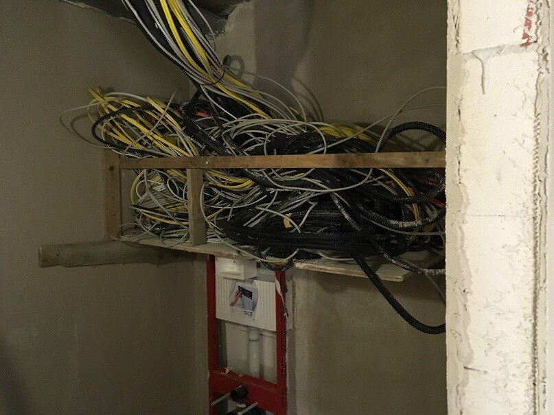

In the basement bathroom, all the cables come together and are routed under a suspended ceiling to the distribution box in the adjacent house connection room. This photo already shows the “after” stage. Before, the whole mess was lying on the floor. Not very practical when insulation, underfloor heating, and screed still need to go in. So, we built this wooden structure. By the way, the toilet is installed 4 cm (1.5 inches) too low and still needs to be corrected.

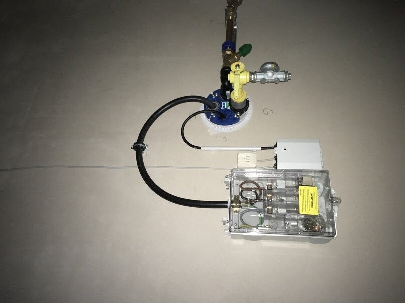

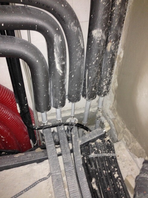

Picture 2:
House connection room. The electrician says: everything’s clear, the screed can be installed.

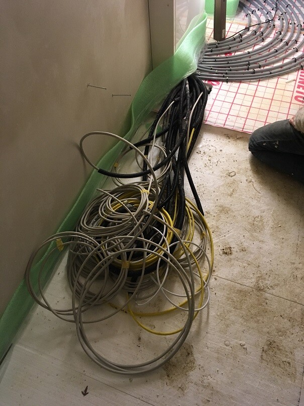

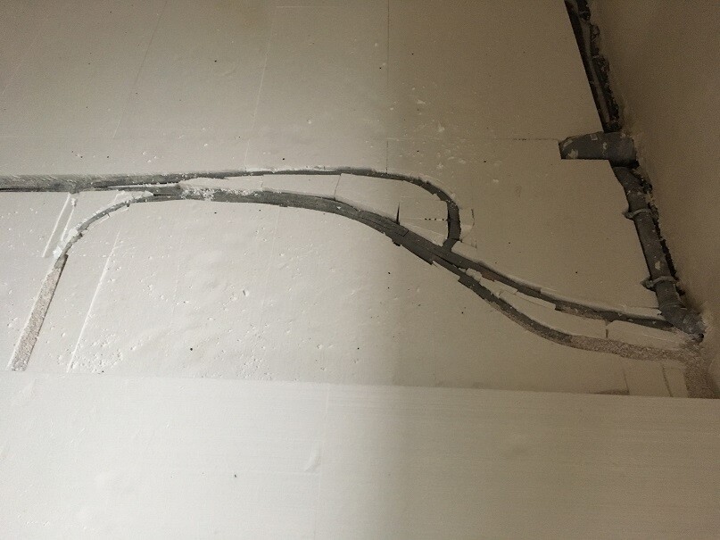

Picture 3:
What a homeowner does in the evening before the screed arrives.

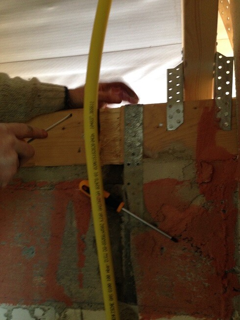

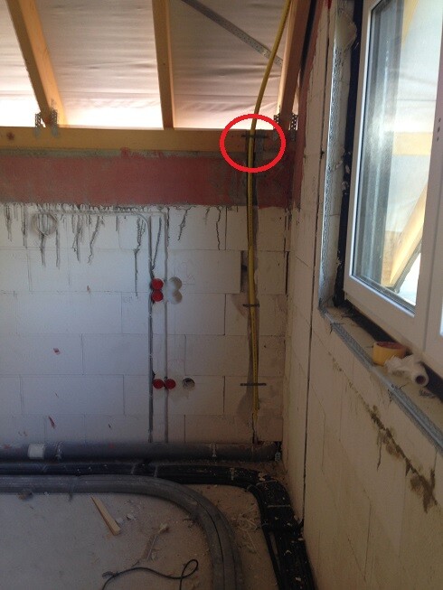

We were already working here. The wall was broken open for a 100 mm (4 inch) pipe, the ring beam was cut, but the gas line was installed in front of the floor beam. The plasterer can just add 5 cm (2 inches) to the wall thickness, right?

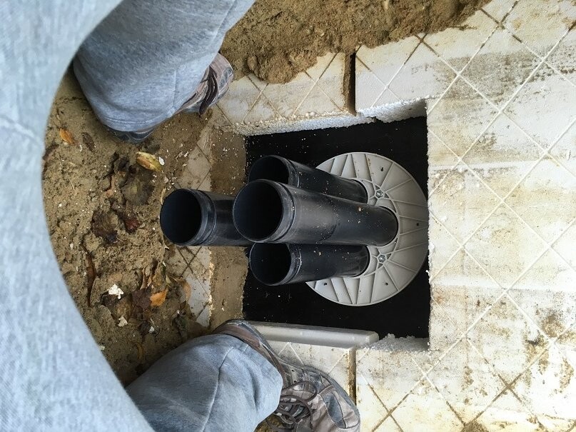

Picture 8:
The plumber is done.
Picture 9:
What you don’t see in picture 8: the outer pipe is almost 50 cm (20 inches), the one next to it 30 cm (12 inches) – both uninsulated at the level of the concrete ceiling.
Picture 2:
Picture 3:

Picture 8:
Picture 9:
