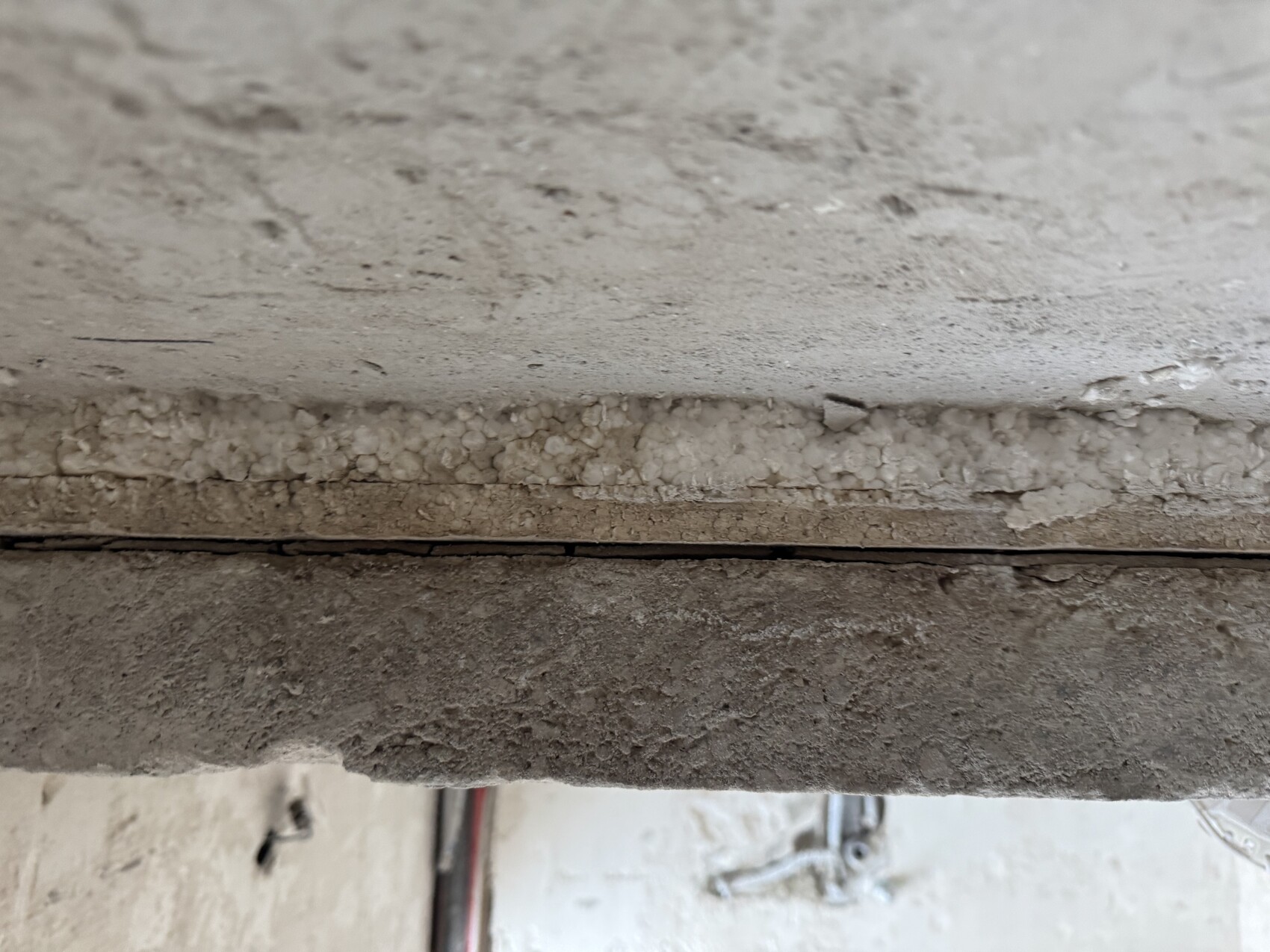

So, I’ve now completely removed the screed on the ground floor. It turned out to be faster and easier than expected. I would just like to know exactly how the new insulation layers should be built up.
I have WLG 024 6cm (2.4 inches) foil-faced PUR insulation, with a grid foil on top.
But shouldn’t I also include an impact sound insulation layer?
