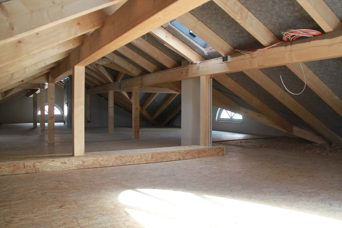

Why use battens and counter battens instead of OSB and then plasterboard?Two layers of battens were a misunderstanding. They would only have been needed to create the necessary recess depth for ceiling spots. However, those are only in the bathrooms, not in the bedrooms.
So, insulation between the collar beams, a single layer of battens, and then directly plasterboard will probably be the solution.
The ventilation unit is fully decoupled within its casing and will not be placed on the floor but either mounted on the gable wall or hung on a framework.

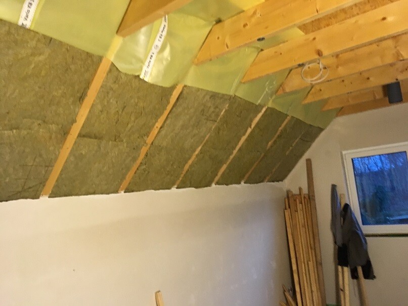

The hot water tank and boiler have already been installed in the attic. Meanwhile, we have started working on the sloped ceilings on the upper floor. The layers will be:
- 200 mm (8 inches) mineral wool
- Vapor barrier
- 80 mm (3 inches) composite panel made of insulation and wood fiber
- Plasterboard
So, about an additional 9 cm (3.5 inches) under the rafters. Then it can be directly finished with joint filler and paint.
Knallkörper11 Jan 2017 12:40@sirhc: That’s quite a lot of insulation in the roof slopes! Is the plaster on the ring beam still damp?
