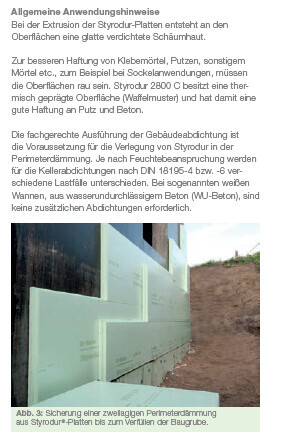

Now, in our region (in other development areas), more and more people are building, and we noticed that, in most houses, a black coating is applied before the insulation boards are installed, and only then are the boards attached. This was not done in our case; the boards were fixed with mechanical fasteners without this layer.
Both the construction manager and the shell contractor independently say that since we do not have any groundwater pressure, this coating is not necessary.
Am I worrying for nothing, or should I have all the boards removed (would they be reusable or would I have to use new ones?) at my own expense and apply the coating afterward?
The basement has not been backfilled yet.
The contract specifies point fastening, but it does not clearly state whether a bitumen layer or something similar should be applied in between. However, the manufacturer of the boards specifies the coating on their website.

However, the manufacturer of the panels specifies the coating on their website.If this is stated in the official product datasheets, then the installer must comply. Period! This makes any discussion about the load case "draining seepage water" unnecessary – which you would need to prove anyway. If you have a waterproof concrete basin (white tank), I would consider it unproblematic, but you didn’t mention anything about that.

Nowadays, more and more people are building in this region (and other construction areas), and we have noticed that in most houses, a black coating is applied before installing the insulation boards...It is possible that the other houses simply have a different basement wall construction, namely masonry instead of a concrete ("white tank") basement.
WU concrete (waterproof concrete) is impermeable to liquid water but not to water vapor. According to the "shot glass formula" (an S-glass amount of water per day per square meter), a small amount of water may diffuse through WU concrete. This is then "ventilated away."
An additional bitumen coating can prevent this. However, this is a belt-and-braces approach. It is not necessary but does no harm—especially in the case of unplanned cracks and defects—provided it is part of a planned white-tank concept.
