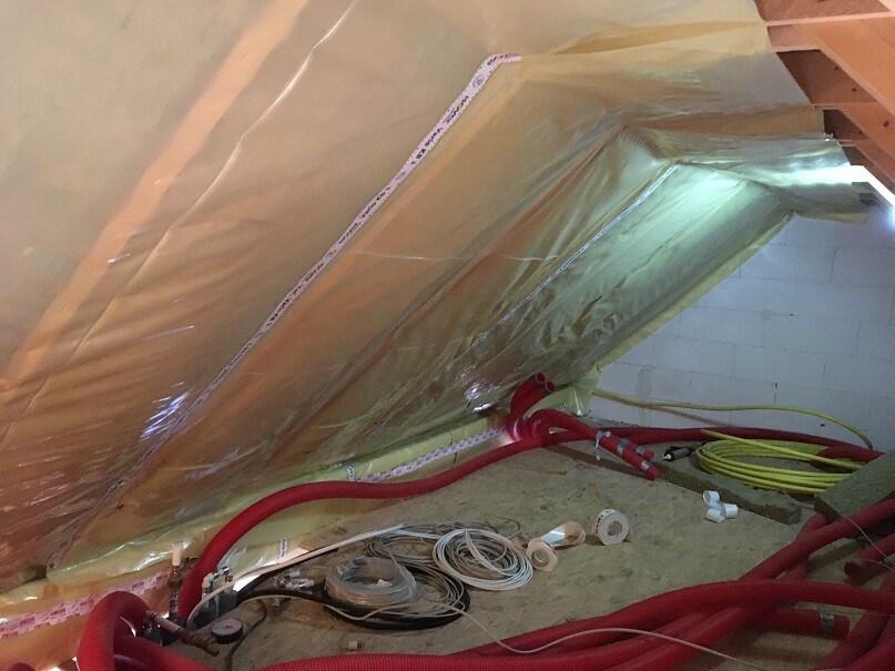

Today, as announced, we worked on insulating the attic. One sloped section is almost finished – two panels are still missing.

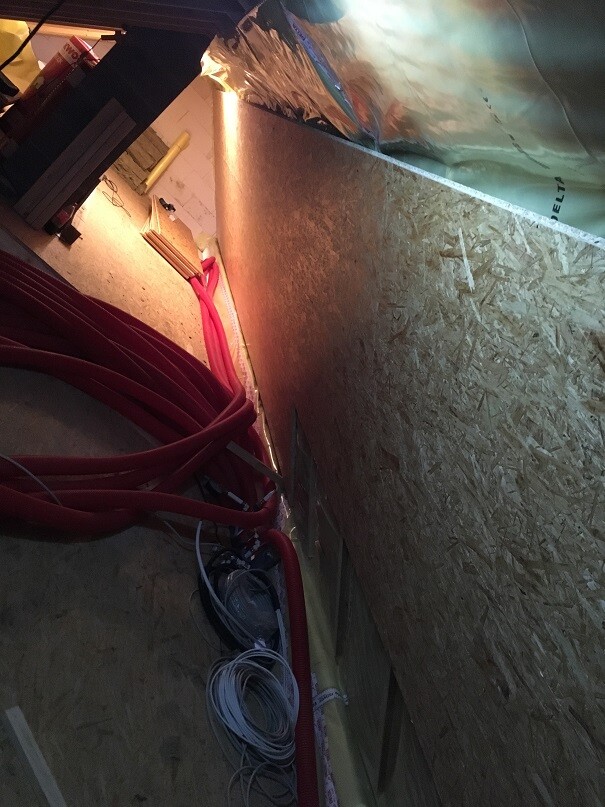

First, 200mm (8 inches) of mineral wool was cut to size with an electric handsaw, then wedged between the rafters. The vapor barrier was connected to the already installed membrane at the ridge beam and pulled up. All transitions between the membrane and from the membrane to the wall were sealed. Next, battens were screwed under the rafters, and 22mm (7/8 inch) OSB panels were installed underneath.
As you can see from the wiring mess, the gas boiler, hot water tank, and the main unit of the controlled ventilation system are located in the attic, which frees up more space in the basement.
Air can still circulate through the sloped walls on the upper floor (plaster and screed are still drying). By the end of the second week of January, the plumber and electrician aim to have everything ready so we can start the heating.
