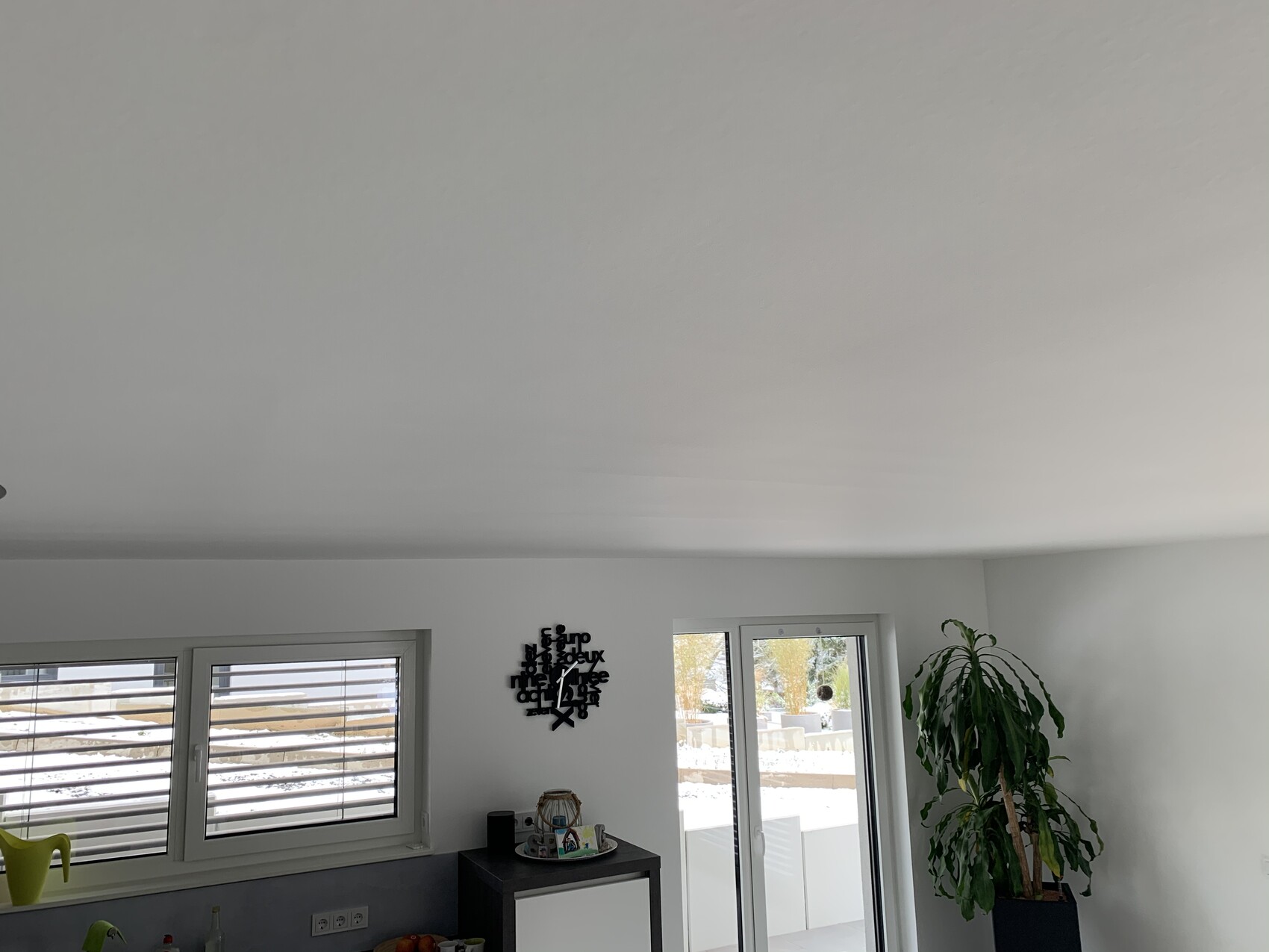

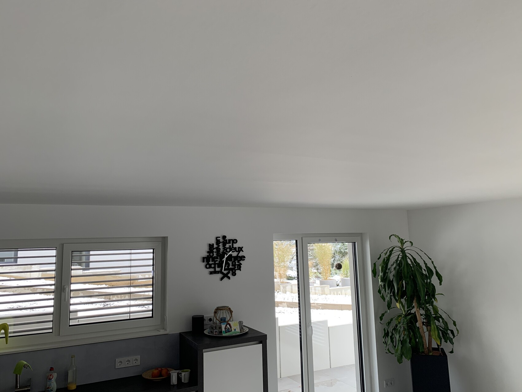

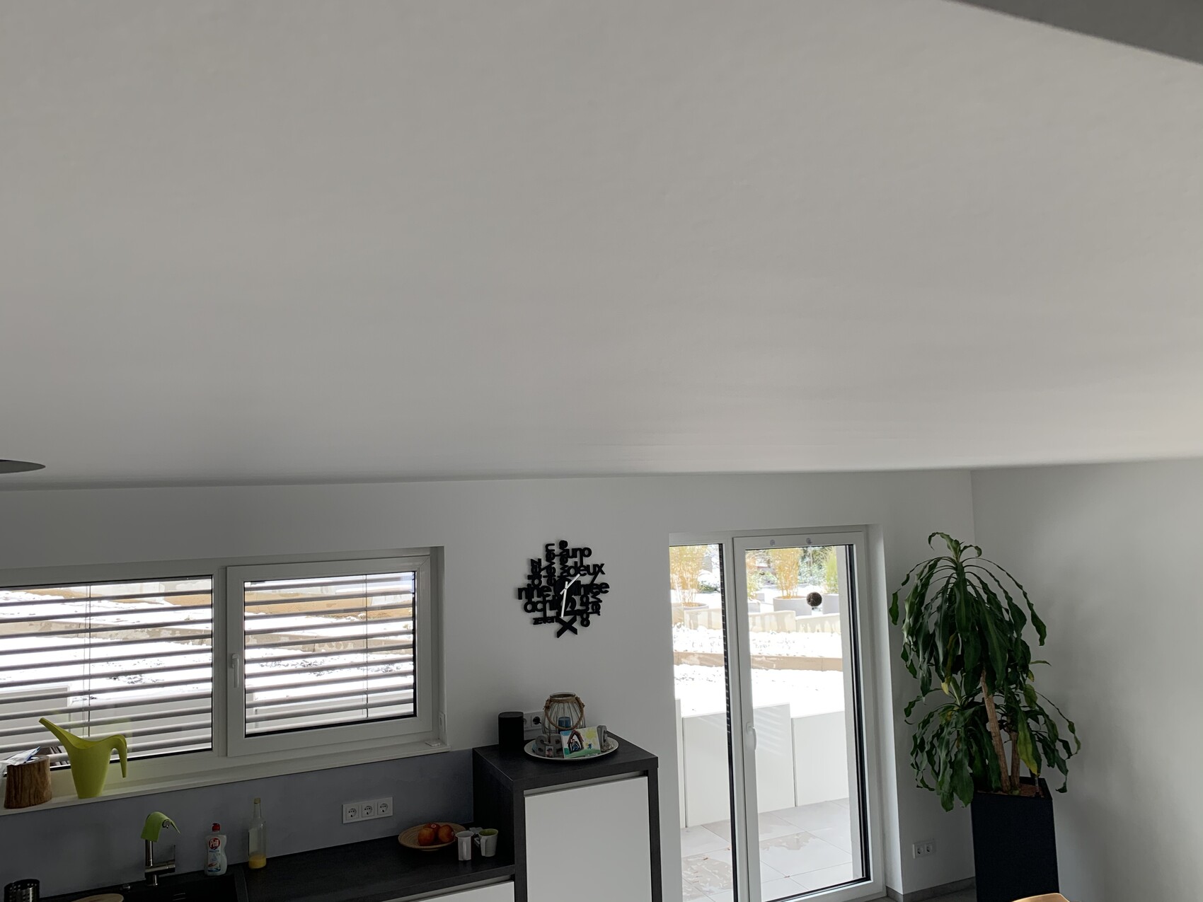

Alessandro25 Jan 2021 13:38now I see it more as poorly installed painter's fleece 😳
No, you can come over, I was there in person during the gluing. The joints were sealed.
What you see is the paint, which apparently wasn’t applied evenly, and that’s now visible.
I don’t think a photo can really capture it well; in person, the ceiling is as smooth as a baby’s bottom... but blotchy.
Alessandro25 Jan 2021 13:47Ok. I’m just surprised by this parallel pattern. It’s actually hard to achieve with a roller.
I appreciate your trust in the craftsman and don’t want to doubt that. It will probably be done correctly….
What surprises me, however, is that if the roller leaves marks, there must be something wrong with the technique. In my opinion, this kind of effect should be avoidable through the painting method (cross-hatch technique) or by properly thinning the paint.
“Poor-quality paints” are bad because they either don’t provide good coverage or they yellow over time. It doesn’t quite make sense to me that a paint would cause streaks simply because it is low quality…
… let’s hope for the best 🙂
