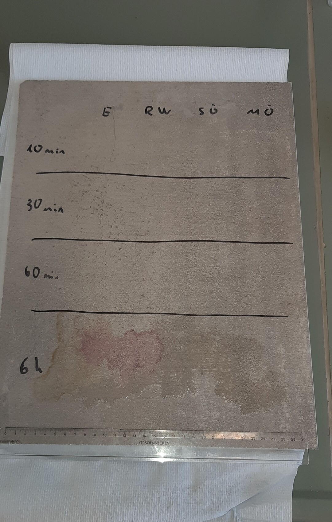

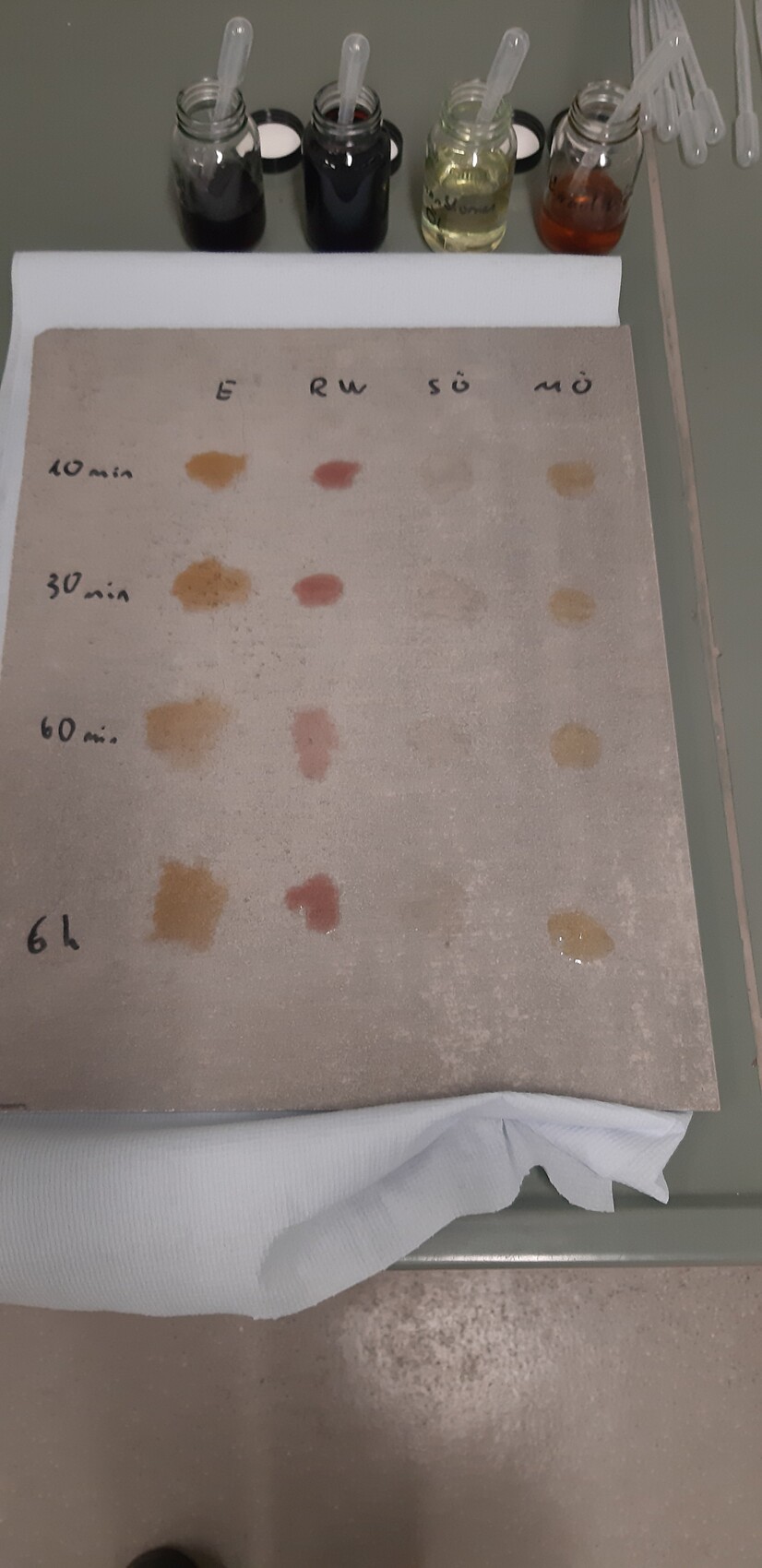

The tiles are called "porcelain stoneware Dublin grey" and measure 120cm x 120cm (47 inches x 47 inches).I once took the liberty to test the chemical resistance of the tiles in the lab after certain exposure times. E = Vinegar (can be critical, for example, on marble or granite)
RW = Red wine (also not exactly "harmless")
CO = Cooking oil (sunflower)
MO = Motor oil (rarely found in living rooms 🙂)
There were no issues found!
hampshire10 Dec 2020 14:32The 6-hour version shows an improvement in the design. I would apply it on a large scale.
What is truly remarkable after 6 hours (before the removal of the liquids) is the exceptionally wide spread compared to the image on the left, which shows the test liquids immediately after application. In all test areas, only 3 ordinary drops were used. This means the surface of the tiles is extremely densely fired and does not absorb any liquids.
