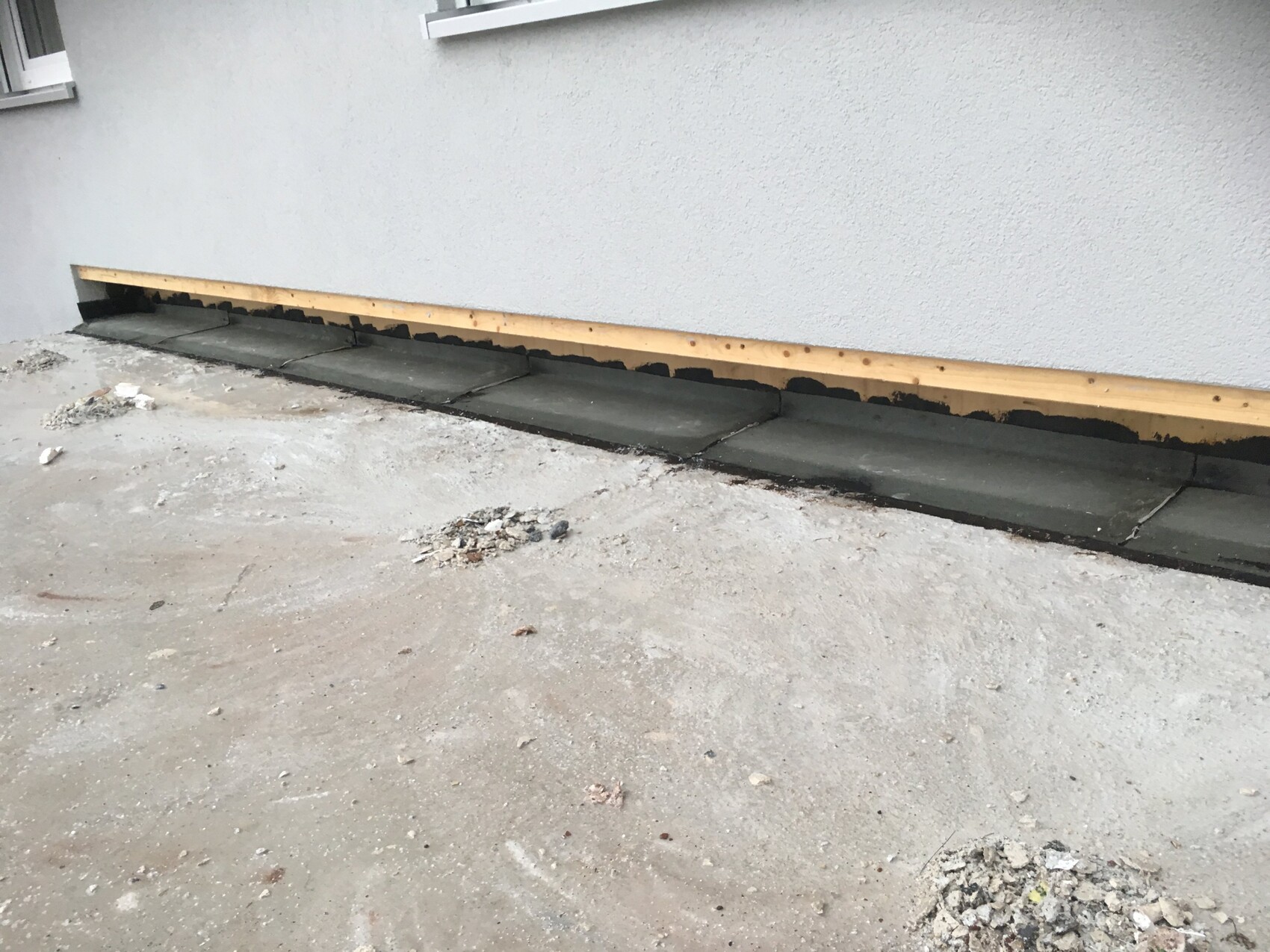

R.Hotzenplotz schrieb:
He said the roofing work urgently needs to be finished. This was initially delayed because the scaffolding is still in place. And if something falls during the dismantling of the scaffolding, all the work will be wasted. But now they have no other choice. Yesterday, the roofer applied a layer of cement or something similar to the base corner where the garage roof meets the house wall, but it was already cracked horizontally from front to back today. We now assume that the water intrusion occurred solely due to the unfinished garage roof and the incomplete garage roof drainage.
Concrete is not waterproof. On our garage walls, water ran down in places like a stream.
This is what our temporary waterproofing between house and garage looked like.
We also had to apply pressure.
Exterior wall in shell construction with wooden batten and foundation waterproofing
