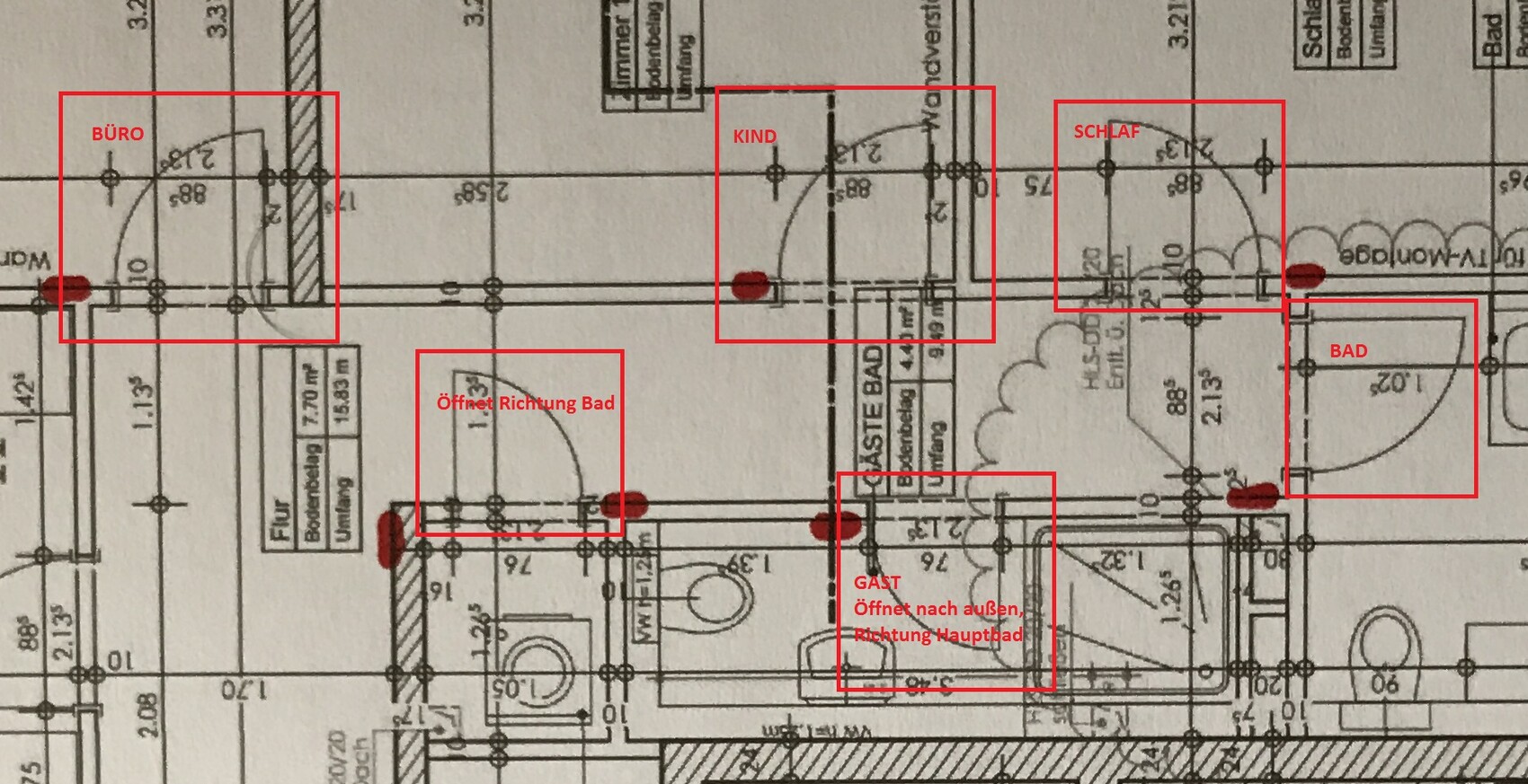

I want to order doors tomorrow from the local specialist dealer. Before that: of course, I will discuss this topic with the dealer as well, but I am currently a bit confused and would like to understand on my own what door handing means for flush-fitting doors before I go to the dealer tomorrow.
Attached is a section of the floor plan showing the doors including the opening directions.
The opening direction will be changed for two doors. For the guest bathroom, the door should open outward, towards the main bathroom. The same applies to the storage room, meaning it should open not towards the kitchen, but towards the bathroom.
Could you please tell me, for each door, what type of handing it is?

There is a system behind this: look at the door from the side it opens toward (usually from the "inside" of the room). The side where the hinges are located determines the door’s designation.Great, thank you very much! Now a lot makes sense to me!
