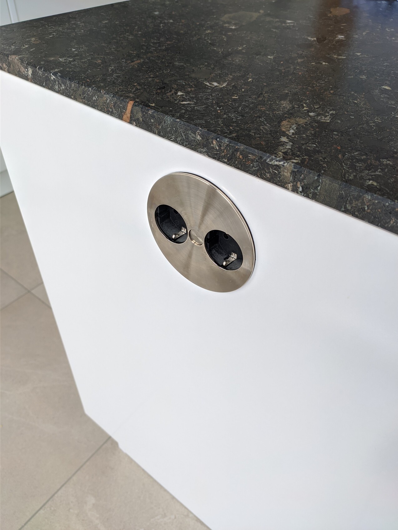

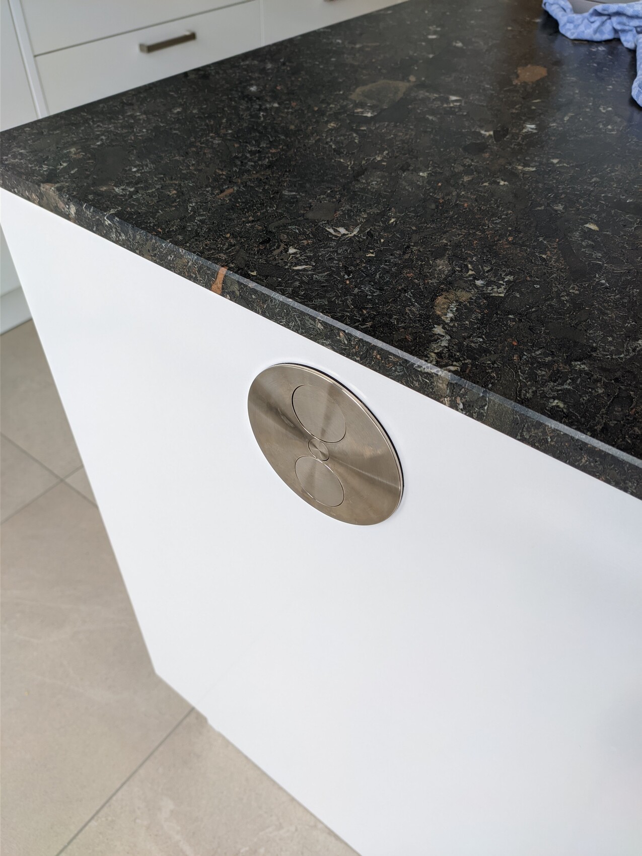

We have the sink and cooktop on the island (depth 1.20m (4 feet)). The sink is positioned on one side of the island, leaving a nice, large workspace next to it.
At the front side of the island, we installed a double power outlet, since power is mainly needed there. We specifically avoided placing outlets on the work surface. This setup has proven effective for us.
Alessandro schrieb:
Socket outlets on the side panel of the island have the disadvantage that:
1. the distance to the cooktop is often too greatTrue. I have experienced this. I walk over to puree with the pot using the hand blender 😀Alessandro schrieb:
2. if you plug in a phone, radio, or similar here, you might catch the cable while passing by and pull the device off the island (this has happened to me once with a phone).
You can clearly see this in the photo from @Nida35aDefinitely keep phones elsewhere!Alessandro schrieb:
Regarding water and splashes, etc., no one should have sockets immediately next to the bathroom sink. But these are actually standard and often not further away than 20cm (8 inches).Those are specially protected, Alessandro 🙄Always on the end panel! Never drill into the fronts! No holes in the countertop! All a big no-no 😀
If the outlet is not needed and the cover is closed, you can even place something on it. Of course, a champagne or wine glass would tip if placed on the edge. The outlet is not right in the middle of the workspace. It doesn’t get in the way when rolling out dough; at least I have plenty of space next to it.
Cleaning effort is no more than with side-mounted models.
It can handle minor spills.
Wherever the outlet is installed, it should be flush. It would be frustrating to lose storage space because of a 5mm (0.2 inch) protruding outlet.
Alessandro29 Jan 2021 10:46ypg schrieb:
They are specially protected, Alessandro Ah, how so?
