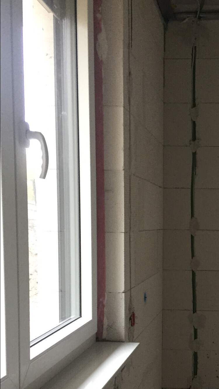

Here is a photo of our shell construction.
On the left, a waterproofing layer; on the right, the plaster rail. There was no space left for an electrical outlet.
You can also see how this issue was resolved.

Bookstar
6 Dec 2019 07:45
Wow, I find them so ugly ...
I find these narrow reveals quite ugly. Installing electrical outlets in the reveals is definitely recommended; looking back, we should have done it more often.
