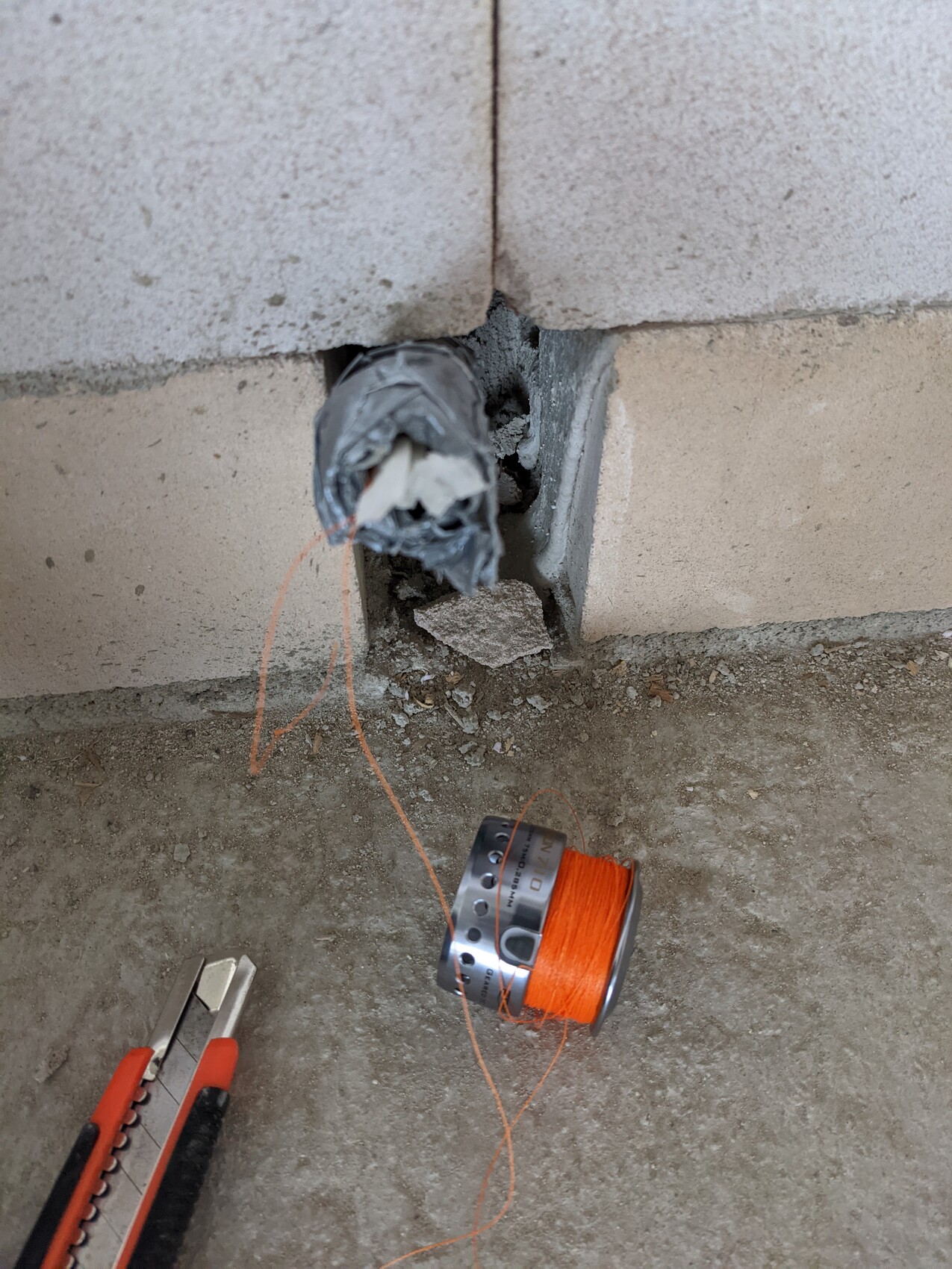

In the meantime, I kept myself busy by pulling cords through the empty conduits for the network cables (old braided fishing line). Using tissue paper bits and a vacuum cleaner worked really well. Today, the electrician is chasing the channels, and tomorrow we’ll pull the cables through.
