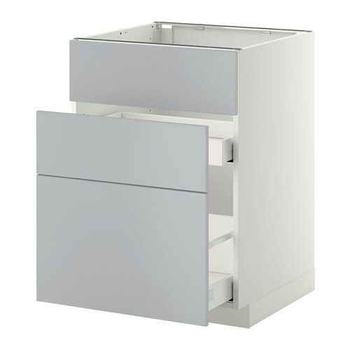

I assume you are looking for
Utrusta
Connecting rail for fronts
UTRUSTA
Article number: 602.635.88
This connecting rail aligns the drawer front with the other fronts and ensures a seamless appearance in the kitchen.
Edit:
I found the rail in the assembly instructions for
METOD / Maximera
Base cabinet for sink/3 fronts/2 drawers, white, Veddinge gray
The picture shows the 20mm (0.8 inch) rail on top, and the 40mm (1.6 inch) rail below. However, I see no reason why it couldn’t also be used the other way around with this rail.
Utrusta
UTRUSTA
Edit:
METOD / Maximera

IKEA-Experte10 Nov 2014 14:47It might be possible that not all drill holes fit perfectly for the tall MAXIMERA drawer, but this is not an insurmountable problem. Please share your experiences.
I have the pull-out unit under the sink fitted with a 60 cm (24 inch) door in front. There is a special fitting for this (I don’t have the article number at hand), which comes with a drilling template, because the door does not have any pre-drilled holes at all. After all, it’s just a door with only the pre-milled hinge recesses.
The same applies for the waste bin insert, which also requires additional drilling in the door.
This really should not be a problem. You just need to measure precisely if no template is provided.

IKEA-Experte10 Nov 2014 16:03For 20cm (8 inches) and 40cm (16 inches) fronts, all the necessary holes are pre-drilled, so no template is provided. The 20cm (8 inches) front does not fit on the tall pull-out drawer, so it’s possible that a combined front may not have holes in the required positions. However, this is not a major issue because the bracket for the railing can still be installed, especially since the connecting rail should already have holes in the correct spots.
This information is intended primarily for less experienced DIYers or for those having their kitchen installed who might receive incorrect advice from the contractors.
