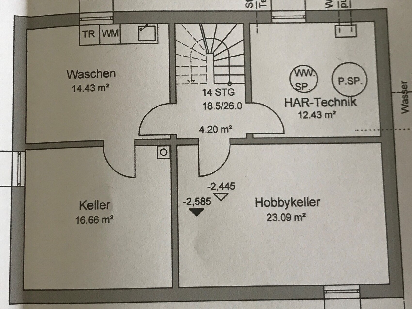

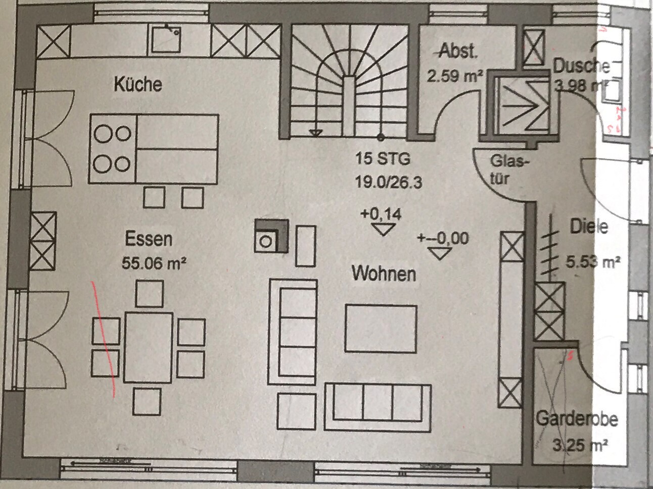

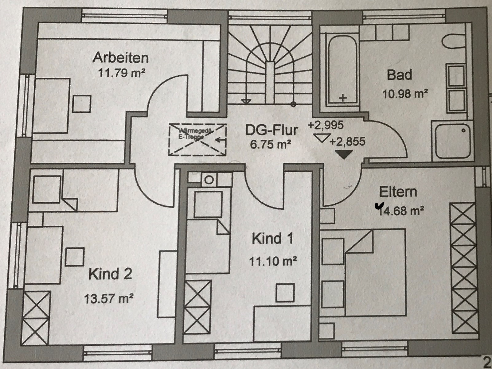

Thank you for the comments. I will wait until the ventilation plan is available in its first draft. I do see some difficulties. There is no way to run the ventilation ducts in a straight line from the basement to the upper floor ceiling. Maybe only in the exterior wall above the guest WC on the ground floor and the bathroom on the upper floor. See the screenshots. I actually don’t want such deep chases in the exterior wall as shown in the previous post. The heating contractor suggested installing a full drywall partition between the guest WC and storage room on the ground floor to hide the ducts there. However, 1. I don’t want a drywall wall behind a shower, and 2. even then, it wouldn’t form a straight line from the basement to the attic ceiling.
