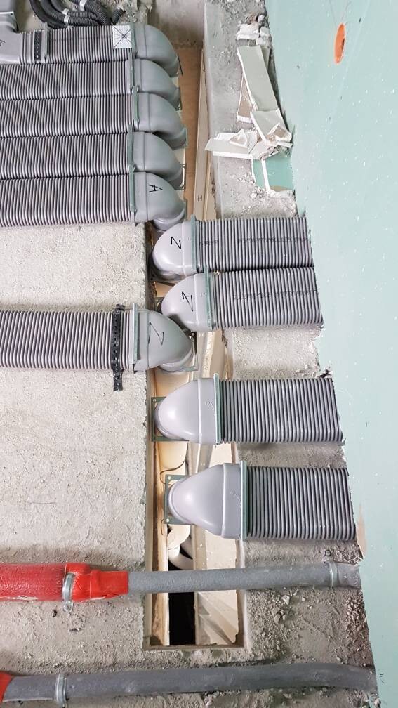

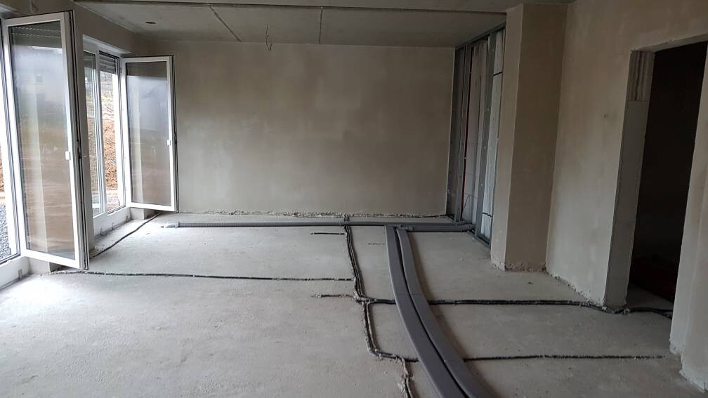

Zaba12 schrieb:
Good morning everyone,
Could someone please share some photos showing how water and wastewater pipes pass through floors in solid construction? Do they run up through a service shaft, or are recesses milled out like for electrical cables? Also, I would appreciate pictures of fully installed supply air ducts for controlled residential ventilation inside walls. I’m having trouble visualizing how these three elements (service shaft, water/wastewater, controlled residential ventilation supply air ducts) appear in or on the wall.
The heating engineer is currently planning everything and asked where we want to route the controlled residential ventilation piping from the unit in the basement, which of course takes up space. Ideally, I would like to run everything up in one shaft: controlled residential ventilation, water/wastewater, and the wiring for the photovoltaic system.
Thanks in advance Our controlled residential ventilation piping is located behind the living room wall.
