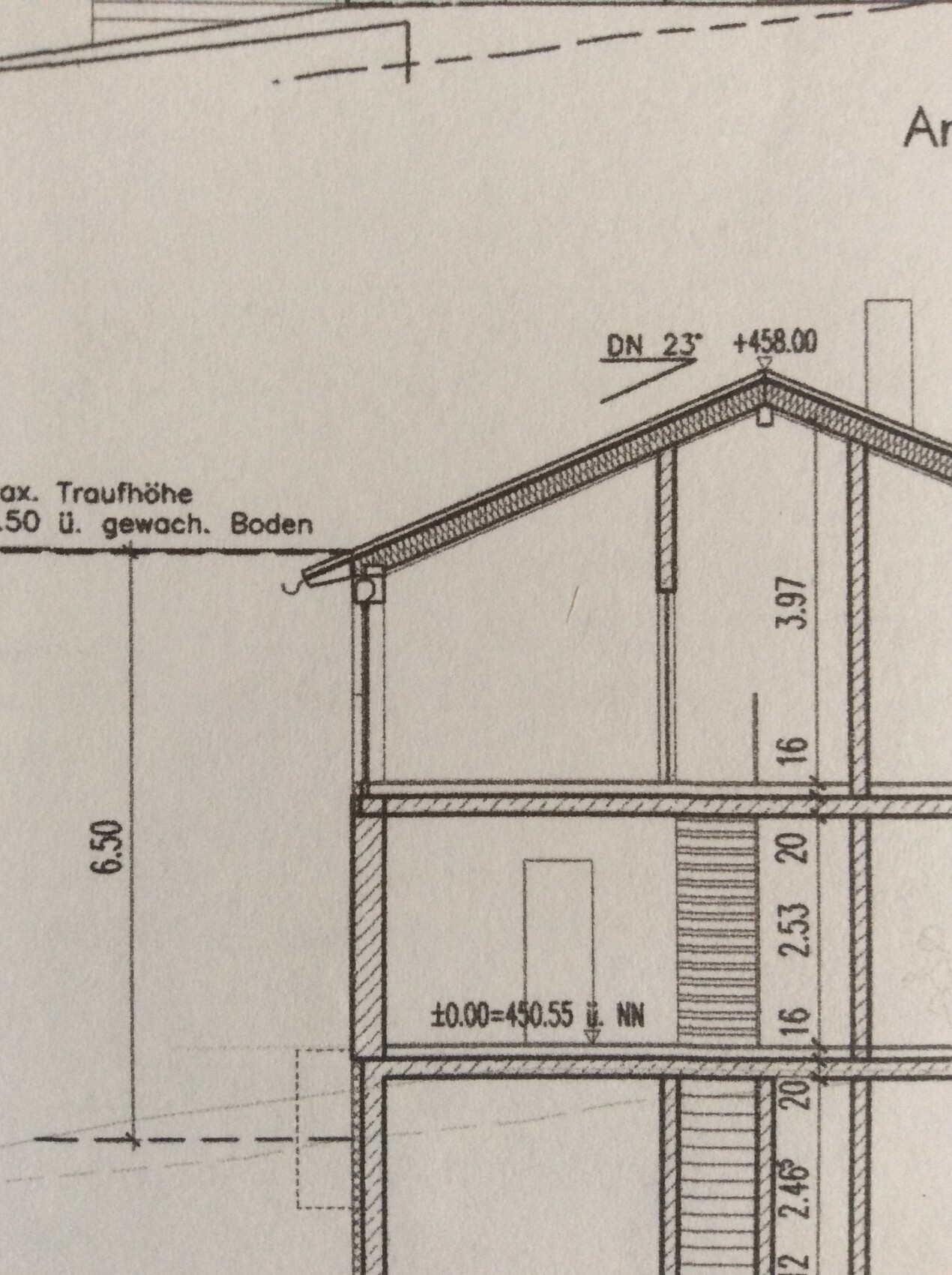

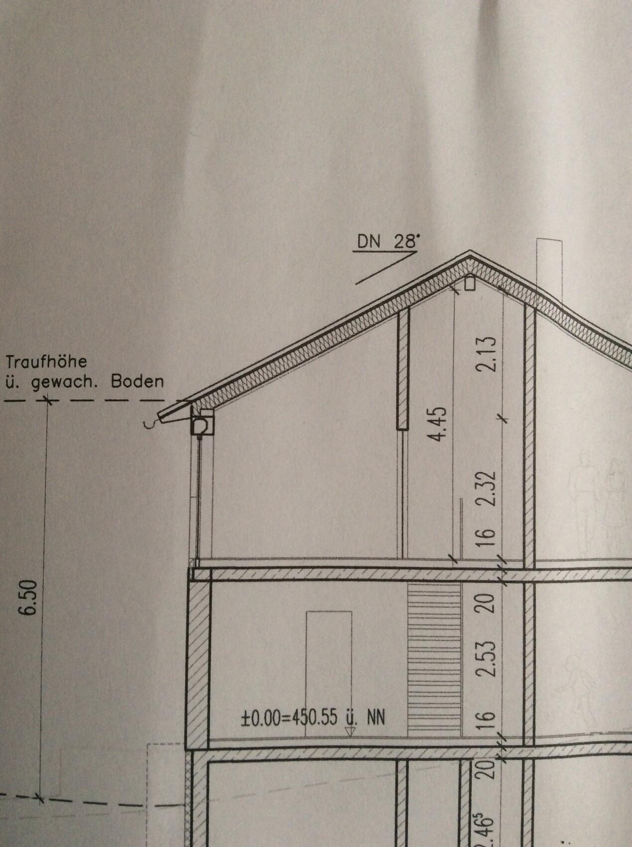

We are facing the difficult decision of which roof pitch to choose. The allowed range is 22 to 28 degrees. We want a single-family house with two full floors plus an open roof structure.
What are the advantages and disadvantages of a 22-degree versus a 28-degree roof pitch? Does a 28-degree roof pitch with an open roof structure make the hallway feel uncomfortable because of the height? (See attached pictures)

We are concerned that the ceiling height with a 28-degree pitch might feel too high and cause discomfort on the upper floor. On the other hand, we want to raise the bed in the children's rooms to create a kind of "loft," allowing more space in the small (11m² (118ft²)) bedrooms.
It is a standard square-shaped house with a gable roof.

One of the children's rooms is 11.89 square meters (128 square feet), and the second children's room is 12.39 square meters (133 square feet).
The depth (to the gable) is 3.04 meters (10 feet), and the length is 3.84 meters (13 feet) and 4.02 meters (13 feet 2 inches), respectively.
The highest point in the room is 3.60 meters (12 feet) at 23 degrees, and 4.00 meters (13 feet 1 inch) at 28 degrees.
In the children's room, we don’t really find this too bad, since we plan to cover the highest side with a wooden loft bed with a ladder.
However, in the hallway in the middle of the house, we are concerned it might feel like a large hall.
