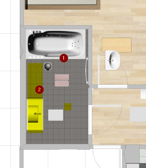

For the small bathroom, there’s also the idea of moving the door to open outward towards the front door. This wouldn’t cause much disturbance and would mean we wouldn’t have to consider the door swing inside the bathroom. The question is whether this would gain us significantly more space to plan differently or if it wouldn’t make much of a difference. The bathroom is very small anyway; here is the current status.
Bathroom renovation (by shifting the wall: 3.05m x 1.6m = 4.88 sqm / 10 ft x 5.25 ft = 52.5 sq ft)
And this is how it looks now:
What do you think of our plans? Where should I give this more thought? Do you have a similar city apartment and have planned similar renovations? (Honestly, I don’t even know where to start; as I said, we are renovating EVERYTHING except the windows and other common property. The bathroom and the tiles are currently the most urgent. I thought I’d post here.)
I’d be happy to hear your opinions and suggestions. Although it’s only 5 sqm (54 sq ft) and 1.5 sqm (16 sq ft), we want to use it for four people. Do you have ideas for good fittings?
Oh, and including renewal of the apartment’s plumbing parts, we don’t want to spend more than 20,000 euros (plumbing installation / tiles / screed replacement in the bathroom / pipe renewal in the building)… that should be doable, right? I’m a rookie and hope I can start a discussion here about our plans and everything related to this.
- Instant water heater
- Large shower bath (about 1.70m x 75 cm) (5 ft 7 in x 30 in) with splash guard wall versus a large bathtub with later add-ons... I’m unclear if shower baths are really worth the extra cost.
- Large washbasin (Geberit Icon, Ideal Standard, or similar)
- Long, wide towel radiator next to the door (75 cm x at least 112 cm) (30 in x 44 in)
- Tile backsplash 1.20 m (4 ft) or slightly higher around the bathtub

dankon7gookoel19 Apr 2020 17:50kbt09 schrieb:
Well, I actually find it quite practical to have the toilet where I want to shower because often you need to quickly use the bathroom first.
For the 305 x 160 cm (10 ft x 5 ft 3 in) area, I would start from the top of the plan with
a 90 cm (35 inch) wide shower, then a 90 cm (35 inch) wide and 10 cm (4 inch) deep shower partition. That leaves a 70 cm (28 inch) passage on the right side into the shower, which you can close with a shower curtain or an inward-opening shower door on the right if there’s too much splash.
Then a 120 cm (47 inch) wide washbasin with vanity unit, for example Godmorgon.
That leaves 85 cm (33 inch) for the toilet.
Ideally, the bathroom door should open outwards and towards the bottom of the plan. Thank you very much, that’s a great suggestion and sounds really good. Oh dear, funny enough we have just agreed again that we do want to install a bathtub after all.. This one will be installed crosswise and measure 1.70 x 75 cm (5 ft 7 in x 30 inch).
We do enjoy bathing too much. We’ll upload the revised plan here tomorrow.
Have a nice Sunday!
dankon7gookoel20 Apr 2020 09:39Hello, here is our new dimensioned plan. Length 3.04 meters (10 feet), width 1.67 meters (5.5 feet), so a 160 cm (63 inch) one should fit here, right?
Otherwise, we could create a lot of storage space under (2). However, the Geberit Icon series is too expensive for us, even though it looks nice. Possibly Ikea or a home improvement store.
The bathtub (1) should be 1.60 meters (63 inches) steel and as large as possible; there is quite a selection on the usual online stores.
Regarding the guest bathroom, we are considering whether to box in a concealed cistern or to use a Geberit/competitor wall-hung system. I need to discuss this with our prospective plumber.
Thank you very much so far; your opinions are very helpful.

For the guest bathroom, I would consider a small storage water heater, which can also fit under a small washbasin and operates on 230 volts, for example, the AEG 236 284. Five liters (1.3 gallons) of hot water is more than enough for two hand washes, and it refills after just a few minutes. At 70 euros for a replacement, it’s an obvious choice.
And regarding the topic of shower and bathtub, there are also nice combined solutions available; something like this should work
