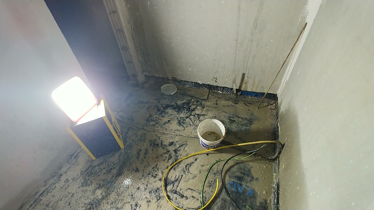

R.Hotzenplotz27 Aug 2018 12:03It rained overnight, and a significant amount of water has entered again. Frustrating.
This is what the ventilation room looks like. We already had to carry out several buckets of water again.

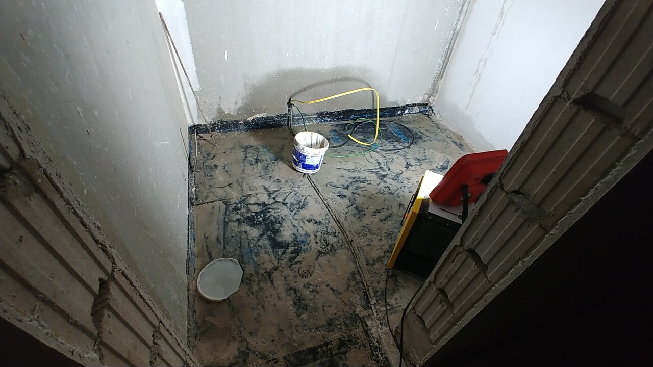

And here is the office, where water is coming through the wall.

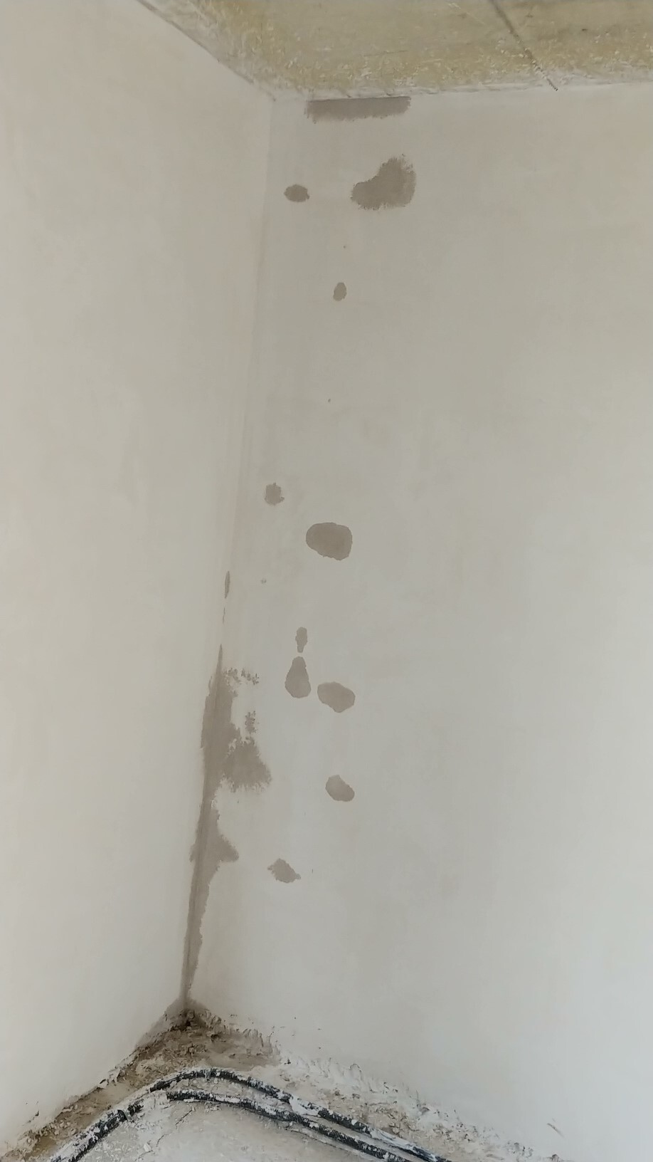

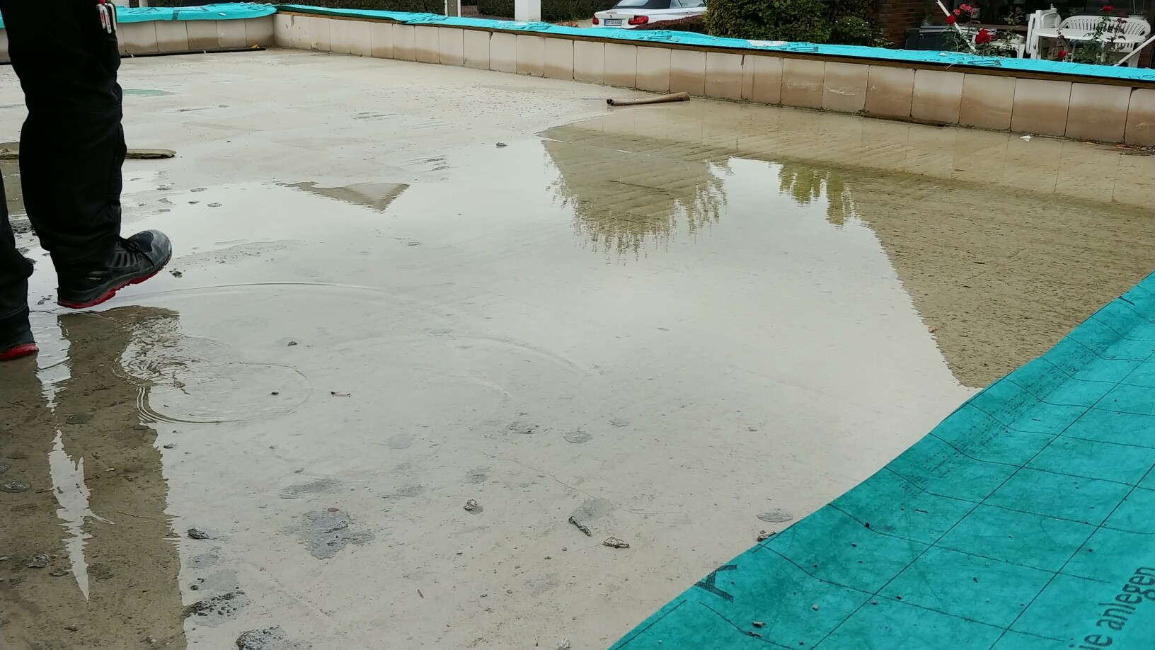

The site manager was also here and said the water is coming in over the garage roof. This is what the garage roof looks like.

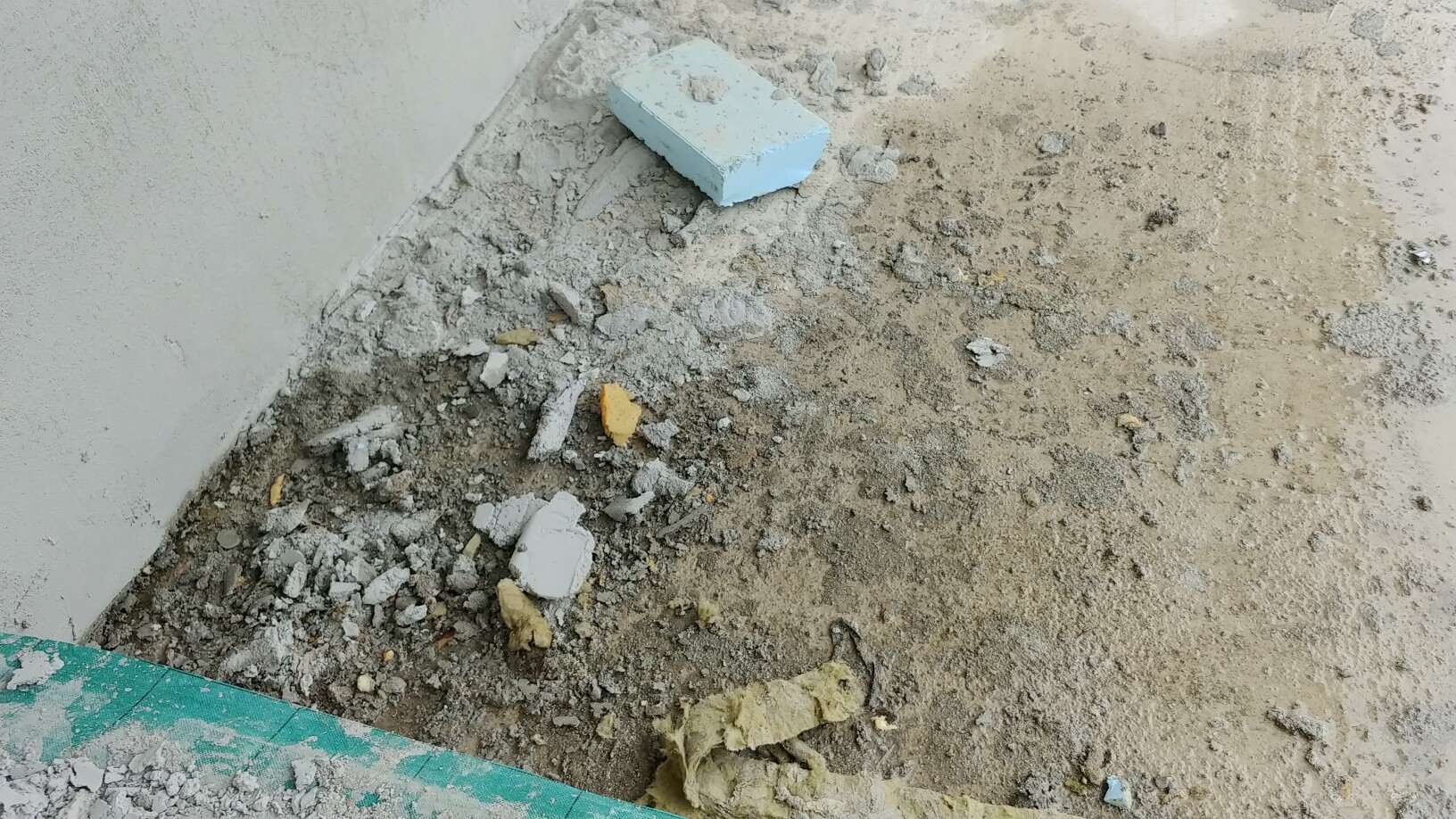

And this is the garage (at the corner that was dry yesterday; so now there are two corners that look like this):
The site manager then instructed the plumbing contractor to drill several holes in the garage roof. One hole should be drilled in the front parapet so that water can drain off (hopefully it won’t then always drip in front of the house, forcing me to walk between the wall and dripping water from the garage to the house). They are apparently also supposed to drill into the ceiling, as I understand it.

Seriously, how is a flat roof supposed to be waterproof without a waterproof membrane or something similar? At the spot where water is dripping down into the garage, you can see that there is a Styrofoam board installed. It looks like the drain was planned there. Such areas will never be watertight as long as there is no waterproof membrane applied on top!
The parapet on the garage is only temporarily sealed from above, so water can also get in there.
From my point of view, the whole fuss about a leaking roof is premature. This can only be discussed once the waterproof membrane is installed on the roof, not before.
I’m also surprised that the site supervisor didn’t tell you that a waterproof membrane still needs to be applied. I have NEVER seen a flat roof made of concrete without a waterproof membrane. Even with waterproof concrete roofs, a membrane is always installed on top...
