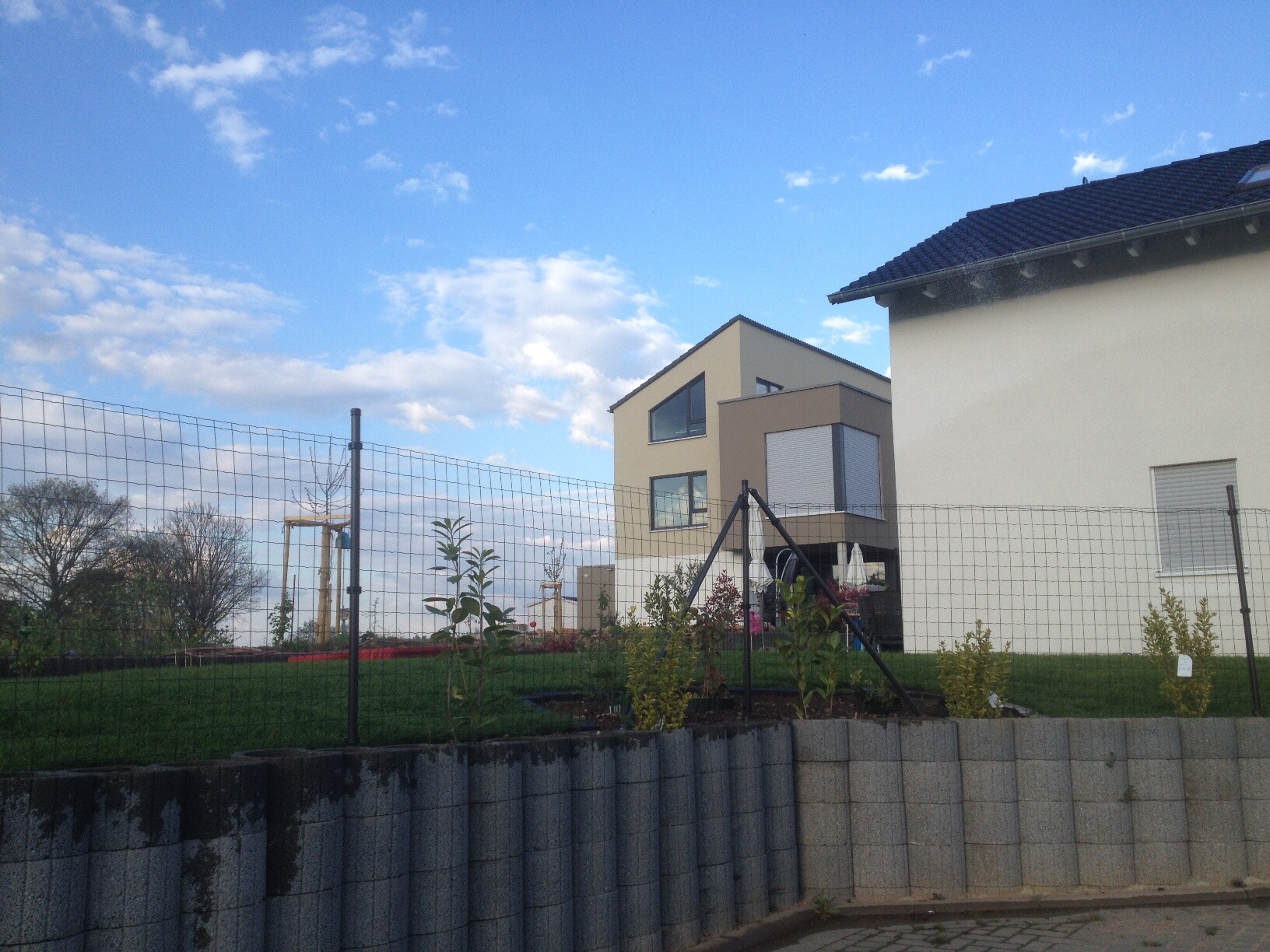

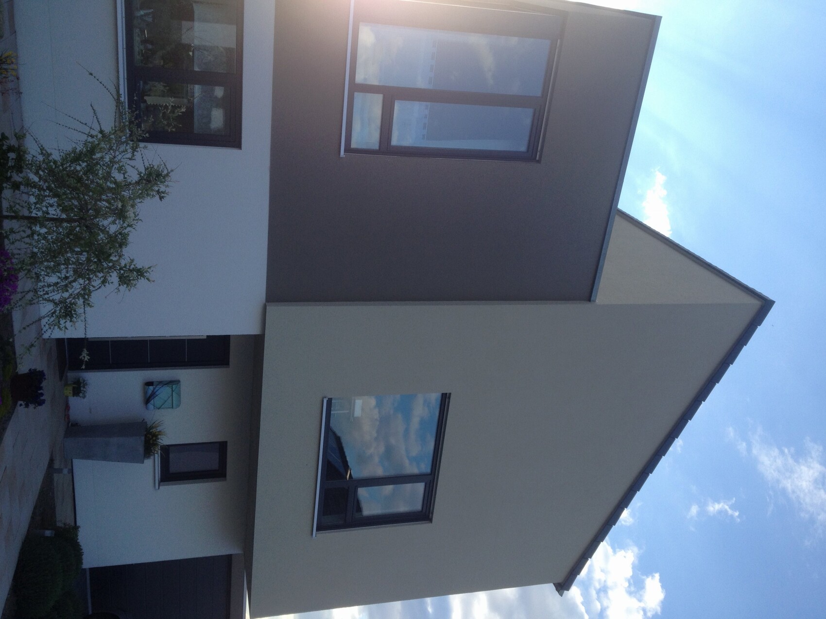

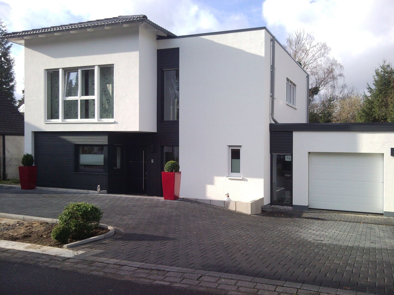

Yesterday, we saw two houses with a combination of a shed roof (about 15 degrees) and a flat roof. We both really liked that.

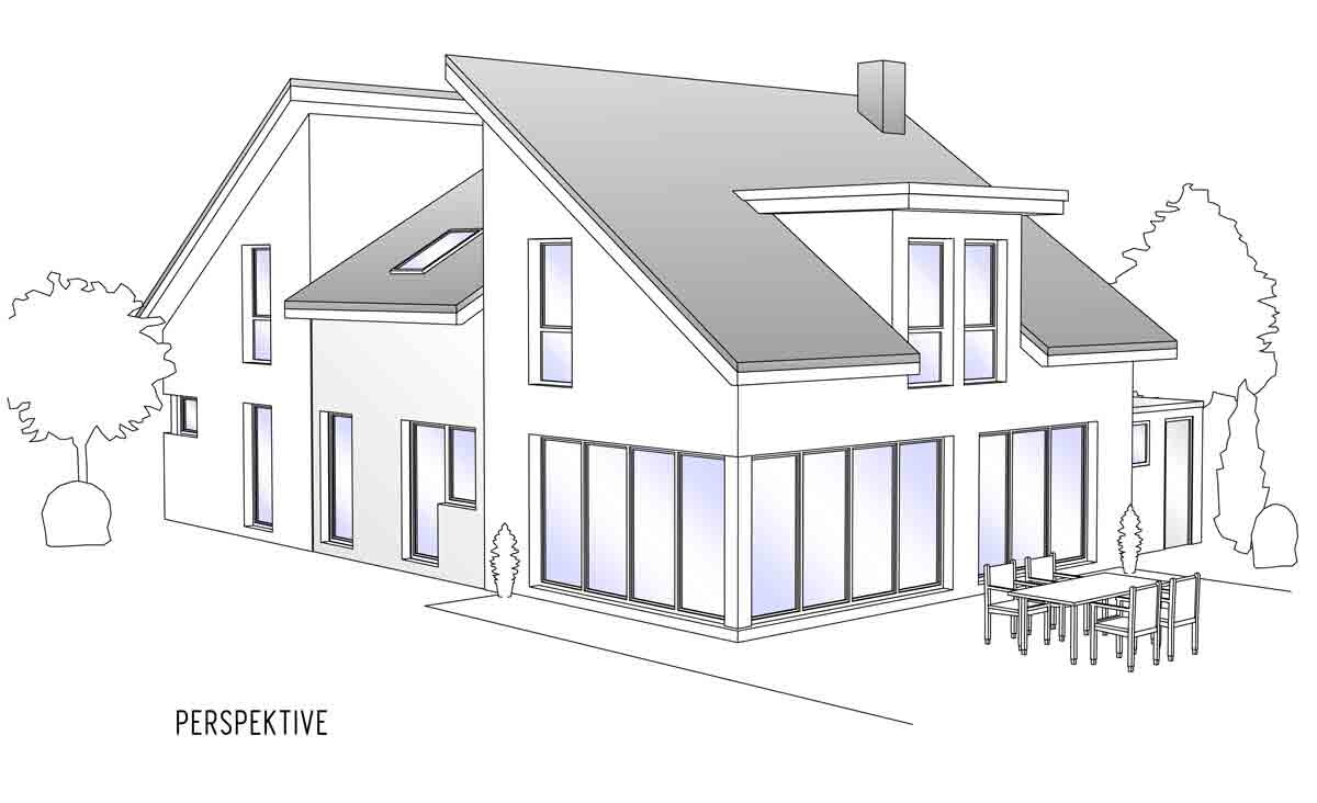

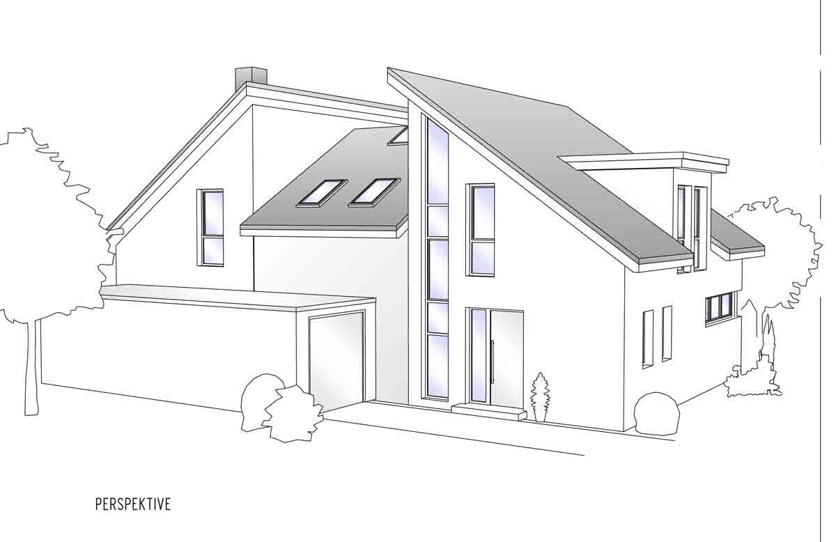

Attached you’ll find two examples – a combination of flat roof/sloped roof and shed roof/gable roof; both are less expensive to build than the projects you uploaded. Maybe one of these could be something for you?
