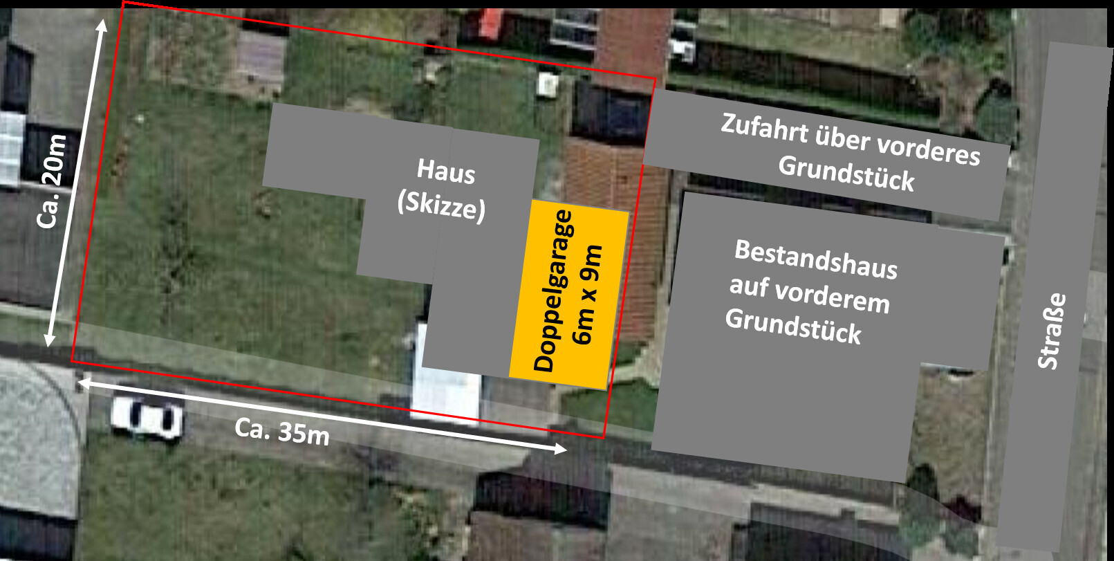

as mentioned in the introduction thread, here is the current status of our house planning.
The plot is located in the second row and is accessible via the courtyard of the front house (shared driveway).
Currently, there are existing buildings on the plot that need to be demolished.

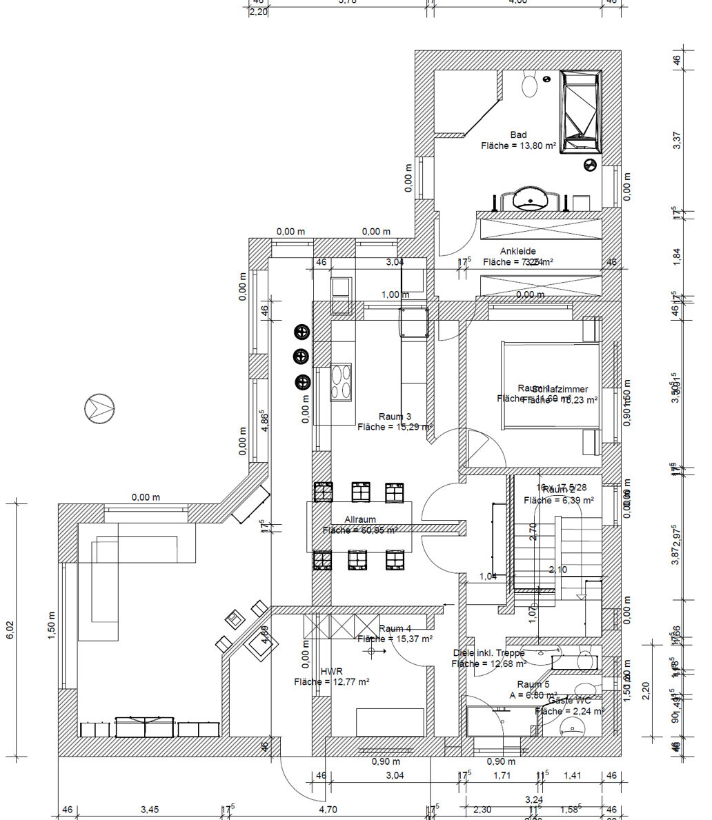

For us, the heart of the house is the ground floor; the upper floor follows from the ground floor plan (room layout, bathroom above utility room, windows, etc.). The upper floor is located on the exterior walls of the ground floor to the right (north) and bottom (east) of the plan, while to the left (south) and top (west) it is limited to the “main rectangle” or recessed by 1.5m (roughly 5 feet).
Attached you will find the completed questionnaire. Unanswered questions I have not included anymore.

Plot size approx. 700 sqm
Floor area ratio (FAR) 0.3
Site coverage ratio 0.3
Building window, building line and boundary 3m (10 feet) from the neighbor’s boundary
Number of floors 1 full story
open development

What do you like in particular? Why? Shape fits well into the plot, living area is somewhat separated, kitchen and dining table as central element
What do you dislike? Why? Is the staircase suitable? Is the entrance spacious enough? Can the private rooms on the ground floor be arranged this way?
Why did the design develop this way?
We consider the plot relatively narrow. Normally, a rectangular house shape would make sense, using the full width of the plot. But then you lose the best side (south). The floor plan was developed according to “form follows function” and we really like it now (I mean the L-shape, not necessarily the individual room layout).
An interesting idea is not to realize the two wings on the upper floor with a hip roof, but instead to have a flat roof to possibly create one or two roof terraces.
The original wish was for a bungalow, but we realized that it consumes too much floor space. A good compromise for us is to have the master bedroom and master bathroom on the ground floor, and the children’s rooms plus office upstairs.
Are there fundamental planning mistakes we have overlooked so far?

Ypsi aus NI23 Mar 2020 08:51Good morning,
@11ant: Children are planned, but not yet here. That’s correct. Rooms 3 and 4 are preferably the children’s bedrooms, as they have a nice south-facing orientation. Room 1 is planned as an office (home office).
Regarding your question about the extensions: The L-shape (the blocks extending to the left and upwards on the plan) are not just simple extensions. The ground floor is a full level, similar to a bungalow. Another floor (probably set back slightly) will be built on top of it.
I have attached another image showing both floors stacked on top of each other. This way you can see the walls of both floors. I hope this helps to explain?
Ypsi aus NI23 Mar 2020 08:56@ypg: Hipped roof and knee wall: We are still completely open on this. If the upper floor is set back (relative to the alignment of the exterior walls of the ground floor), then we could also imagine the upper floor with a flat roof. Or maybe a hipped roof with reasonable slopes (i.e., a comfortable knee wall height). The two blocks that are not built over on the upper floor could have flat roofs (with terrace) or hipped roofs.
But we’re not that far yet—form follows function... First the floor plan, then we will see what looks good and is affordable in terms of knee wall height and roof design.
I have slightly updated the drawing from yesterday. I hope it is clearer now? The first grey block is an existing house, which I have grayed out so nothing can be seen clearly.
Regarding the budget: Well, we’re still flexible here. We wanted to wait and see what the offers say. There will probably be a huge difference between KfW40+ and KfW55 standards. We will have to decide once we have more detailed offers and understand what is worth what to us.

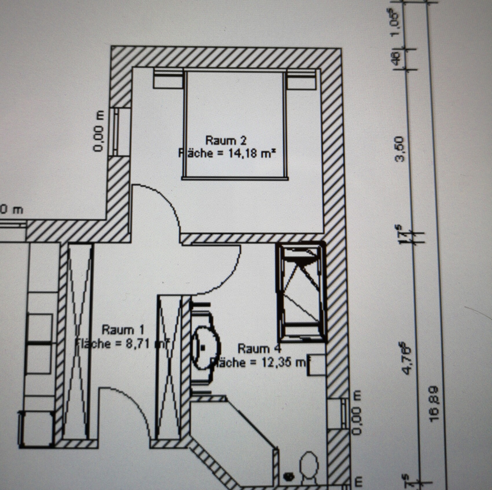

Ypsi aus NI23 Mar 2020 09:04Regarding the bedroom/bathroom layout: Yes, that is currently our biggest issue! What happens if you swap the two rooms (bathroom and bedroom)? Then the bathroom becomes a passageway, and the door faces the living area. The toilet is no longer private. Basically, I’m happy to do without a guest toilet. It’s only planned at the moment because the master bathroom is located in our private area.
The architect also pointed out that no one would be able to sleep if the layout remains as it is. Generally, we get up together every day and go to work together. But on weekends, I sometimes like to sleep longer than my partner. So, I would be the only one with an issue regarding the floor plan.
The architect suggested creating a room within a room. So: you enter the private area from the open living space; then, on the left, there would be a corridor leading to the dressing room and bedroom, while the bathroom would be on the right. That was her proposal, and she said she would develop it further for us. We have, of course, considered this and experimented with it at home. But this corridor solution just looks really awkward. We couldn’t get comfortable with it. That’s why, out of frustration, we went “back to square one,” meaning the current layout.
What concrete suggestions would there be to solve the bathroom/bedroom layout problem?
Ypsi aus NI23 Mar 2020 09:31Then let's focus on the ground floor, as I wrote!
1. The floors are connected. Moving the staircase changes everything.
2. As you have drawn it, the structural engineer will request some costly modifications.
3. Your unconventional design will cost money – a lot of money.
Do you have the budget for this?
Living and sleeping habits change, especially with children.
