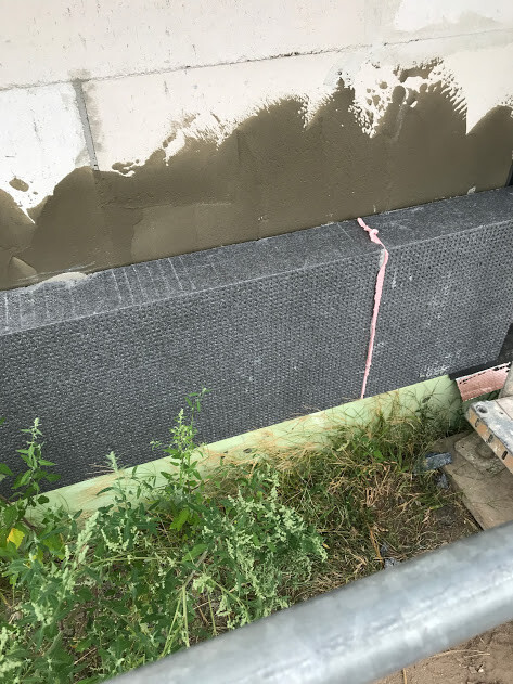

We are installing the problematic ETICS insulation system Is there a cross-section image showing how thick it is for this wall construction?
@Bookstar : You don’t have to, of course, but there are many ways to reach the same goal, and building a house is like that too.
@Traumfaenger : Yes, there are. The exterior wall is 17.5cm (7 inches) thick, the base area has 14cm (5.5 inches) of insulation, and above that 16cm (6.3 inches).
niri09 schrieb:
The exterior wall is 17.5cm (7 inches) thick, with 14cm (5.5 inches) insulation at the base, then 16cm (6 inches) on top. Only 17.5cm (7 inches)? Sand-lime brick? Do you know which type?
