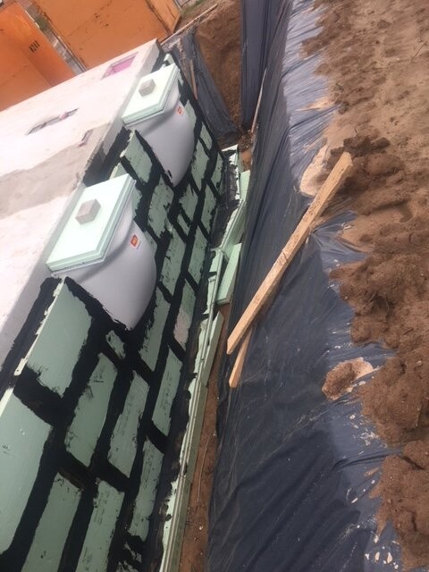

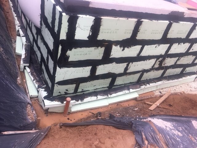

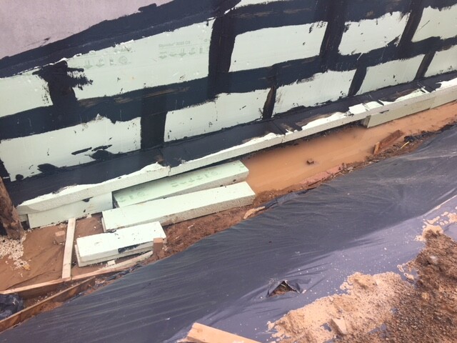

I was at the construction site today and was shocked to find that the heavy rain on Friday washed away the basement insulation. We were actually planning to backfill tomorrow. Looks like that won’t happen...
Why aren’t the light wells installed on top of the perimeter insulation? That creates a serious thermal bridge, doesn’t it?

Why aren’t the light wells placed on the perimeter insulation?
That creates quite a thermal bridge, doesn’t it?That’s right, in our case they were also fixed onto insulation boards.

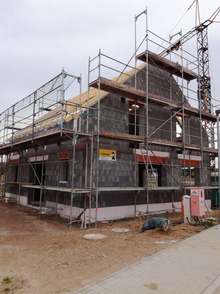

I would have at least routed the conduits in the ceiling at right angles; as it is now, it’s a guessing game afterward where everything is—in case of any issues.
Today, the ground floor precast concrete slab is being installed. This evening and tomorrow, conduits will be laid again, and on Friday the slab will be poured. Next week, work can then continue with the upper floor.
mertmk3 schrieb:
At least I would have routed the empty conduits in the ceiling at right angles... Well, good luck pulling the cables through then [emoji6]
