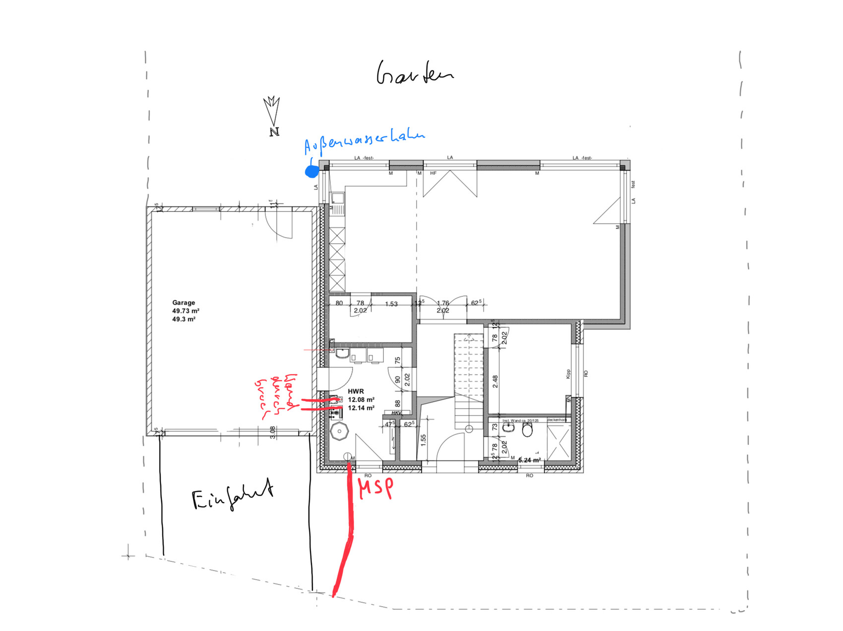

I don’t have a detailed irrigation plan yet, just a rough idea. It will be a Hunter system. The valve box will be installed in or near the garage. The solenoid valves will be controlled via a KNX switching actuator. Water supply will come either through a water line from the utility room passing through a wall opening, across the garage floor to the valve box, or simply from the frost-proof outdoor faucet. From the valve box, lines will distribute to the front and back gardens. I have attached the floor plan. The garage is on the property boundary, so I can’t extend further north from there. That’s why I’m considering a conduit from the middle of the garage toward the front garden in the north, and another from the middle of the garage toward the garden, so I don’t have to dig up the gravel slab again.
I’m not yet sure if frost will be an issue inside the garage...

24 Apr 2019 22:16
If the dashed lines mark the property boundaries, you can save on empty conduits. Frost protection valves outside and in the garage are sufficient.

24 Apr 2019 22:32
hampshire schrieb:
If the dashed lines represent the property boundaries, you can save on conduit pipes. Frost protection valves on the exterior and in the garage should be sufficient.
Can you explain the reasoning behind this?
