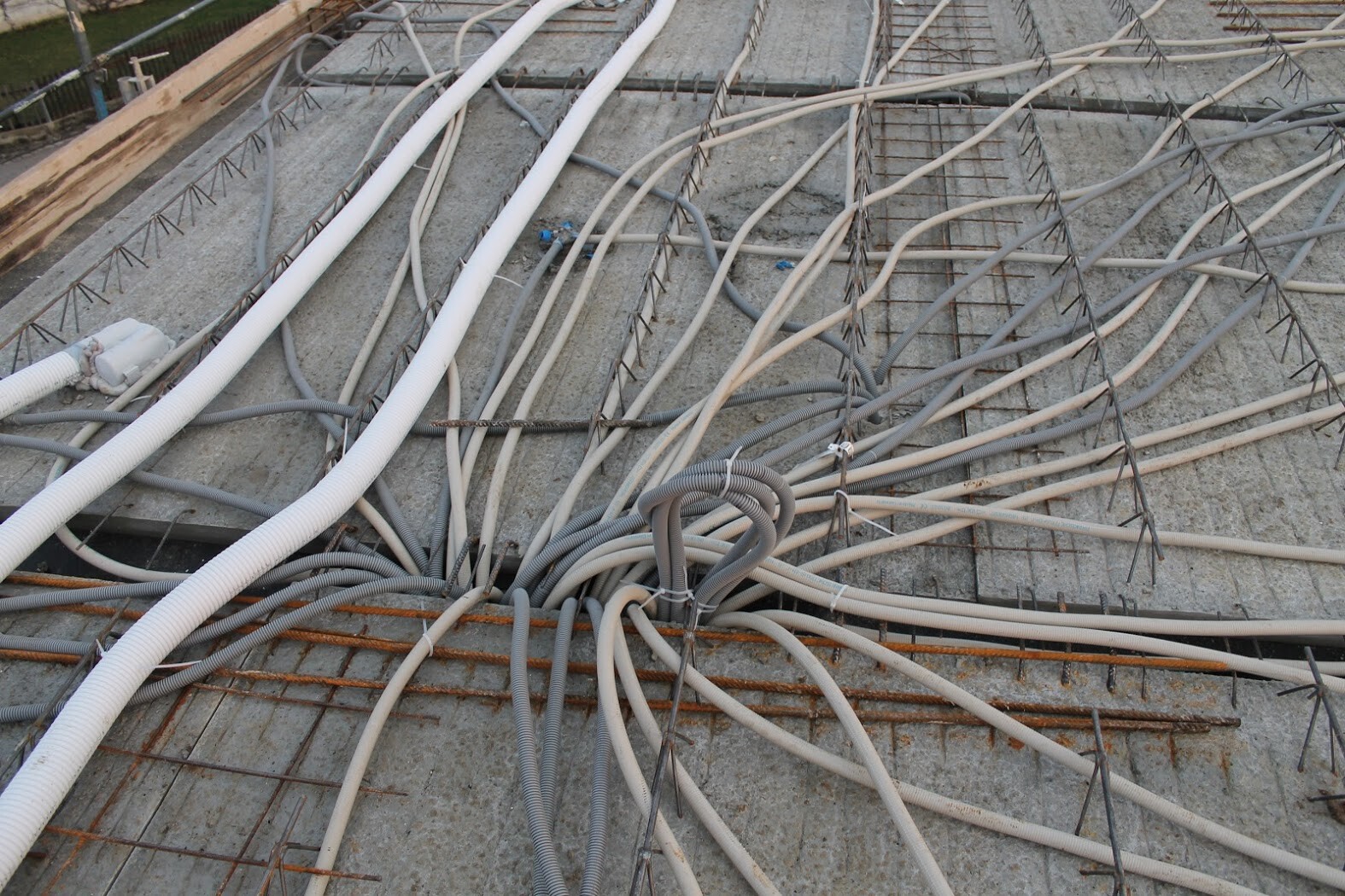

I installed the empty conduits after placing the precast floor slabs and before casting the in-situ concrete.
There were no delays; the slabs were installed on Friday in coordination with the contractor, and the concrete was poured on Monday.
As it is usually done:
On one side, the conduit goes through the floor opening; on the other side, either into the ceiling box (for lighting, fire detectors, presence detectors) or a hole is drilled so that later you can reach down in the wall chase.
Construction site with reinforcement, numerous cables, and shell construction work on the foundation floor.

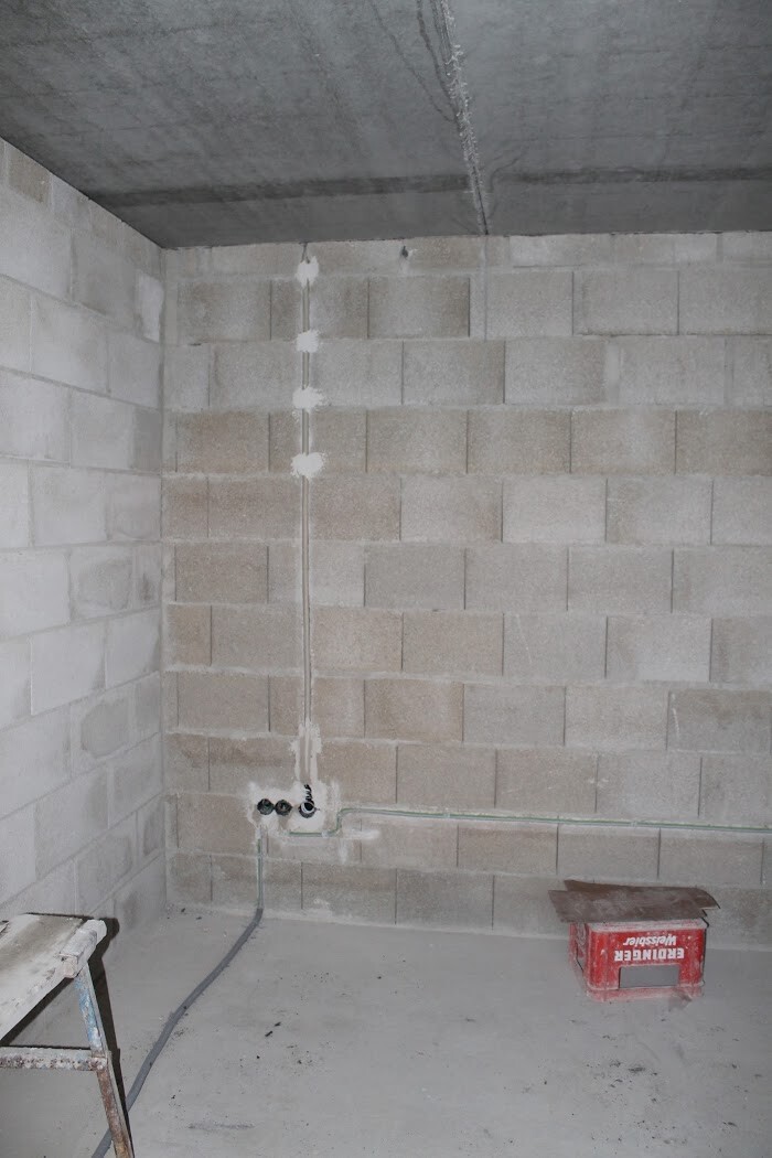

When laying conduits, you quickly accumulate meters. But to later fit an empty box, it takes at least twice as much work:
Drilling the box hole, chasing with a wall chaser, chiseling out, and plastering in the box:
Basement room in shell construction with concrete block walls, visible lines, and construction tools
All in all, this is not a job for someone with two left hands!
