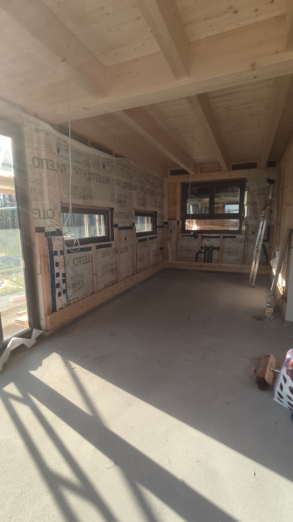

We were busy over the weekend.
We want to close the exterior walls from the inside to prevent too much moisture from entering during the warming-up phase.
Unfortunately, we didn’t get as far as we wanted because it was just too hot. But we’ll easily finish it by July 6.
Ground floor before
Interior in shell construction: timber frame, windows, insulation, and scattered tools on concrete floor.
Ground floor after (the dust makes the picture look strange)
Unfinished interior construction with wooden beam ceiling, windows, construction foil on the walls, tools.

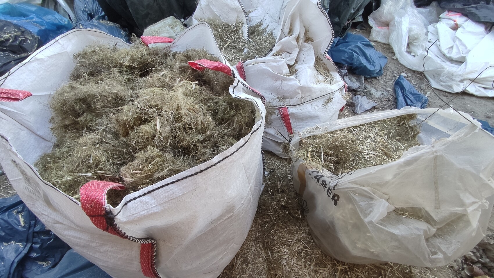

We went upstairs for the first time this weekend.
Packing hemp on the right in the bag and half a bag “fluffed up” on the left (the trash in the background is currently not a priority)
Large white bags with hay and straw, open, red handles, surrounded by blue tarps.

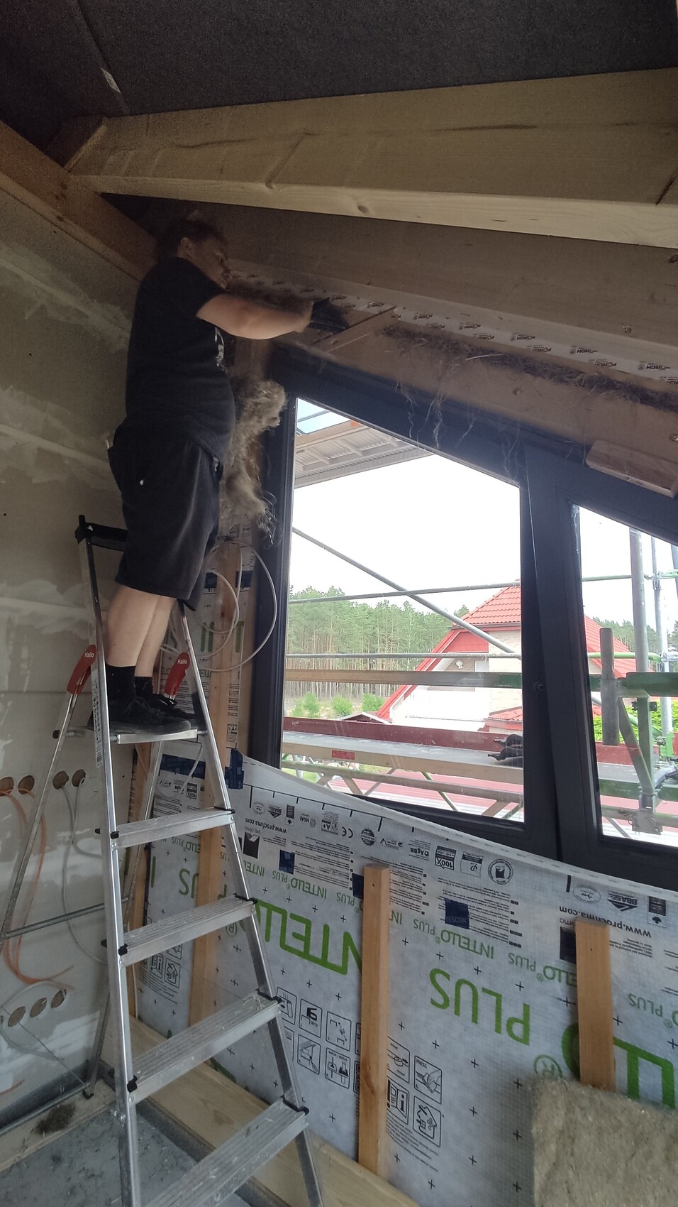

And this is what we are using to fill our exterior walls:
Person standing on a step ladder working on a window frame in an attic construction site.
We also use it to insulate around the windows.

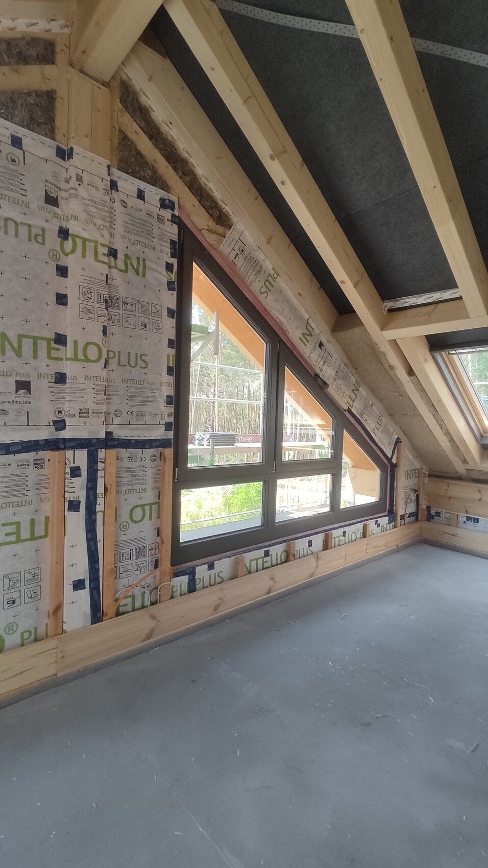

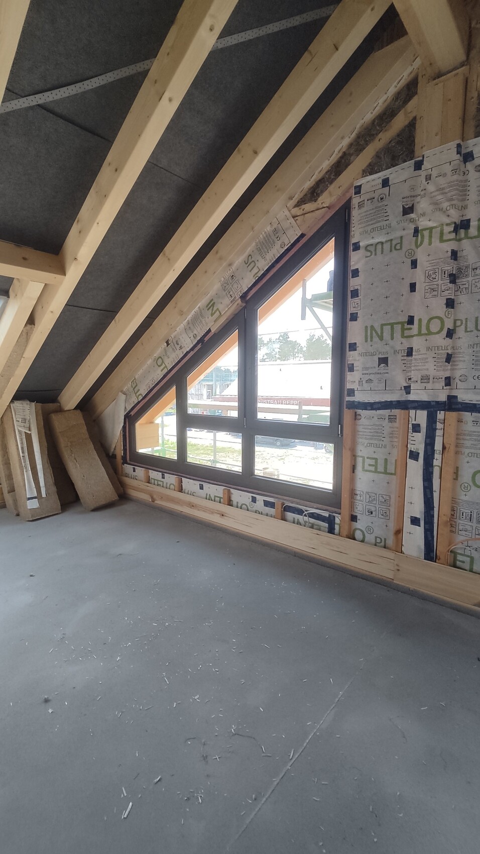

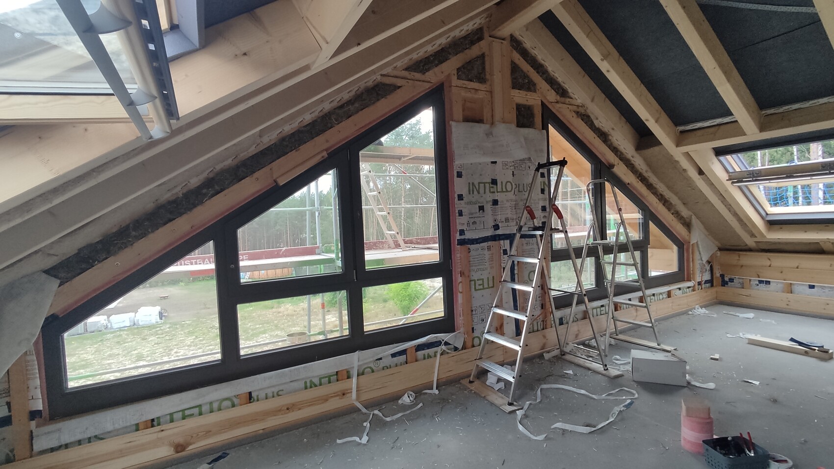

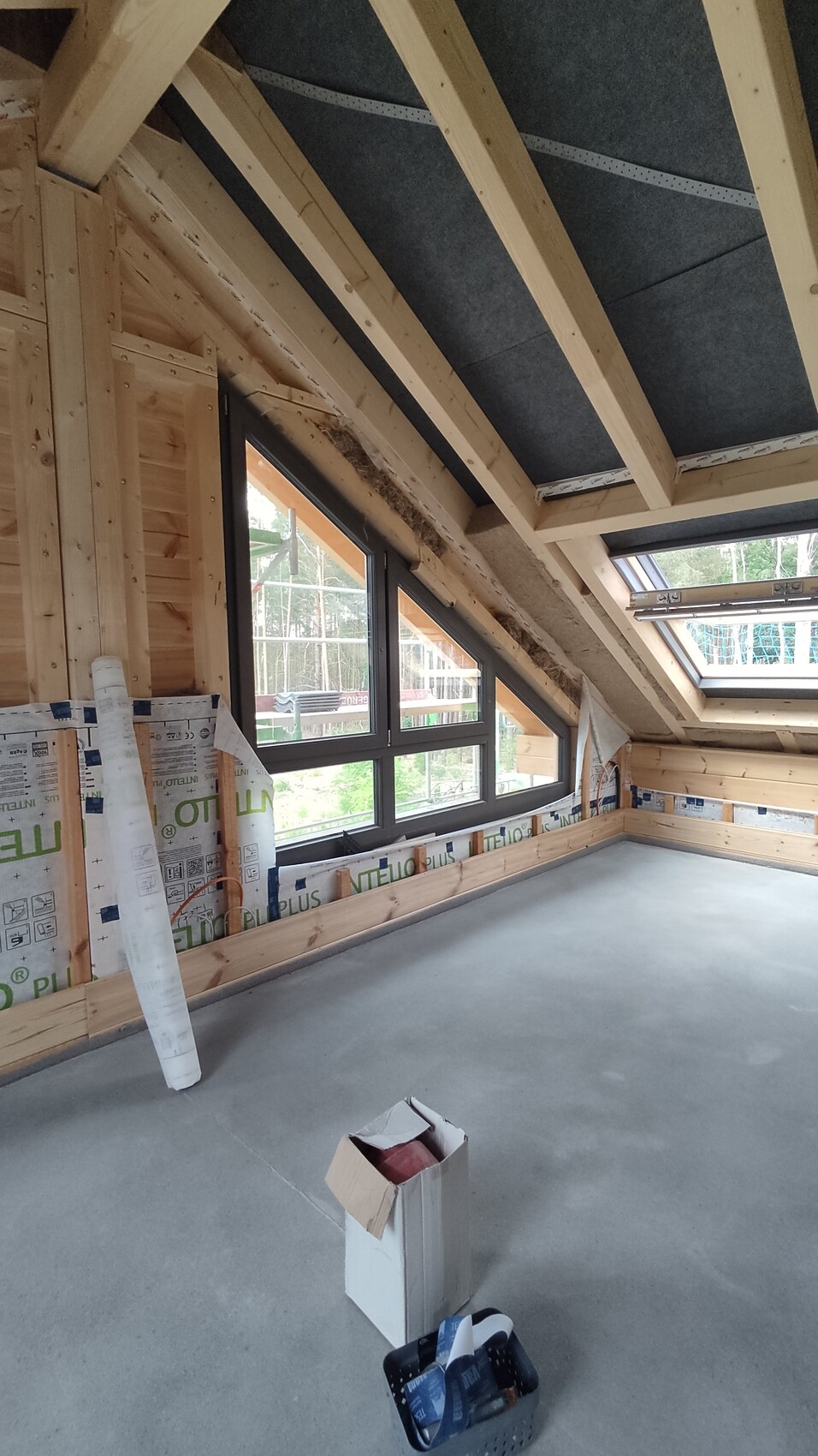

We almost finished my exterior wall:
Before
Attic construction: visible wooden beams, large roof windows, unfinished interior.
In between
Unfinished attic room: wooden structure, large roof windows, ladder and building materials.
After
Attic shell construction with wood framing, sloping window, and insulation on the wall.
Attic shell construction with wood framing, window, INTELLO-PLUS insulation, view of greenery.
