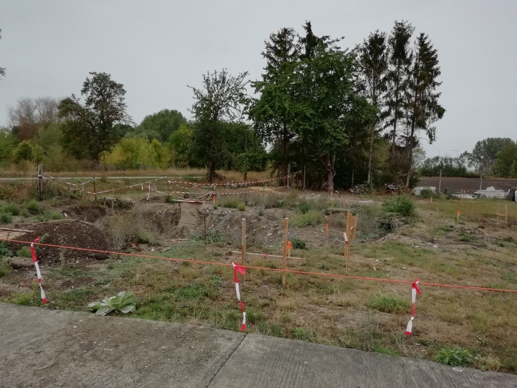

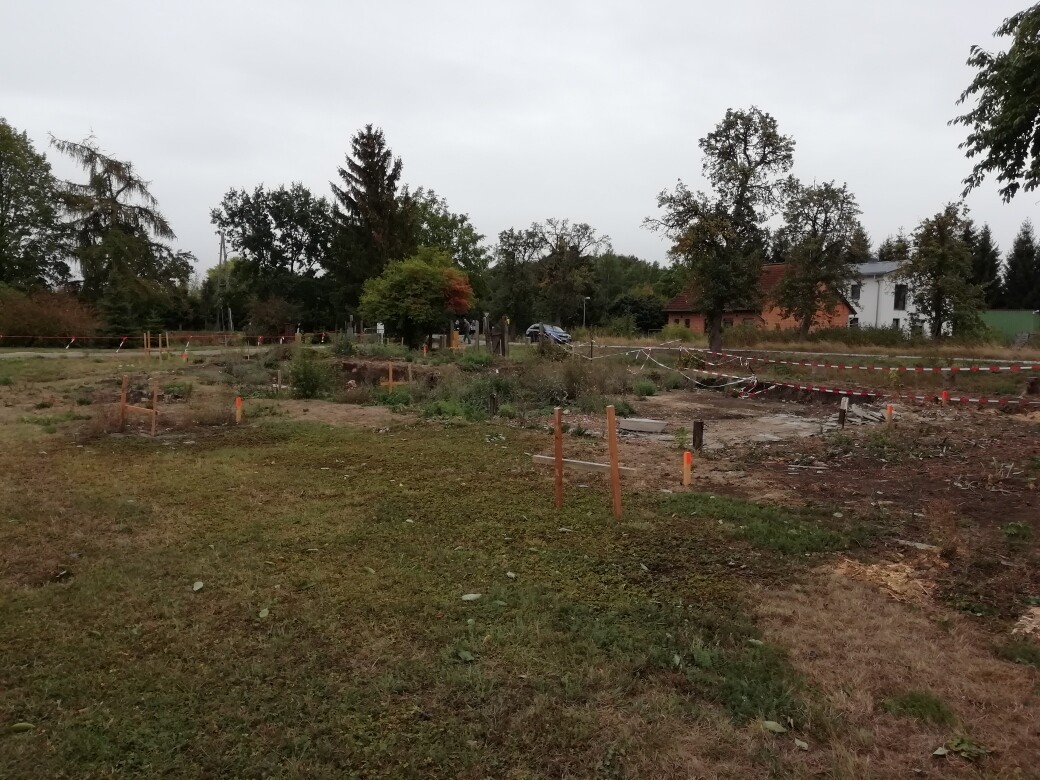

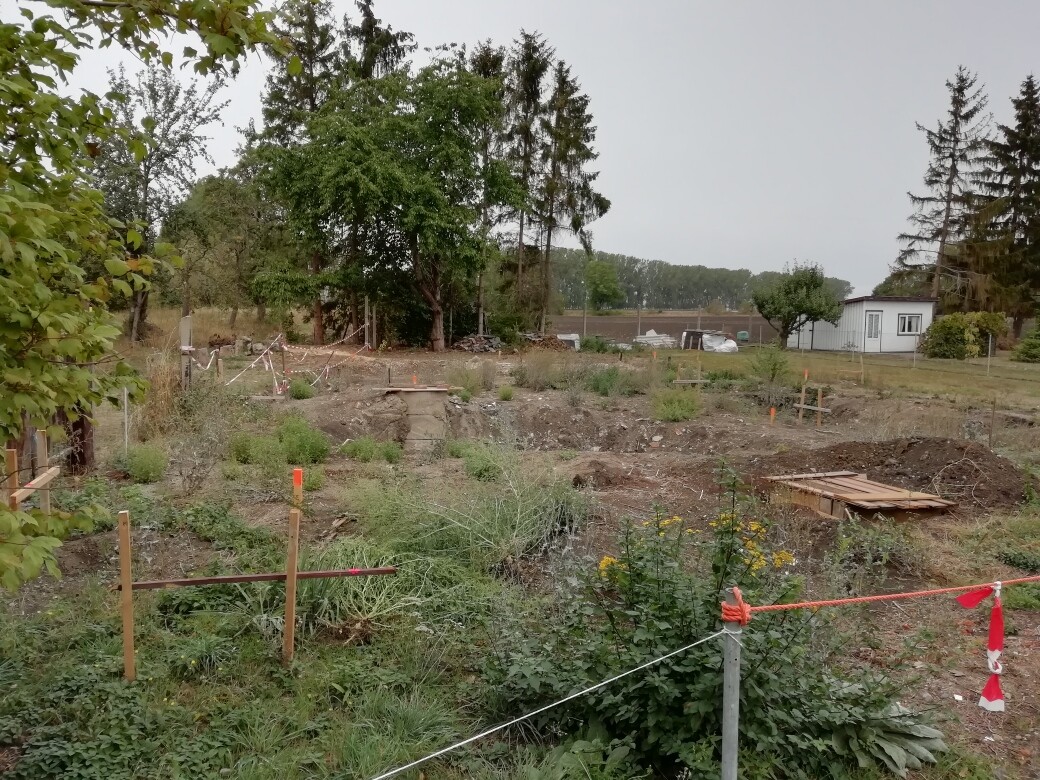

Looks like a great plot! Could we see a photo of the entire site with the surroundings? It looks amazing!
The natural stone paved path at the front: can you keep it or does it have to go?Good morning everyone,
Attached are the requested photos. The plot is about 913 square meters (9,820 square feet) and is located in the beautiful Börde region. A house with 165 square meters (1,776 square feet) and a garage measuring 10.5 by 7 meters (34.4 by 23 feet) will be built.
The path with the natural stone paving is an old field track that now leads nowhere, so I think it will be preserved.
The only downside is that there is a railway line about 100 meters (330 feet) away.
